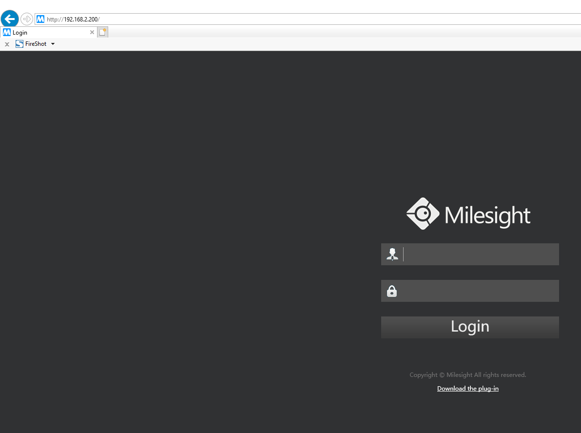

So, if you look at my screenshot above.
That shows the NVR on my home network.
My router/gateway address is 192.168.2.1
My router's domain range runs from my router's address to 192.168.2.255
Any address in that range 1-255 is said to be in your domain range
The NVR is set to IP address 192.168.2.200

You should see something like this:
(shows my NVR at my IP address)
That's great news - have you managed to login?
