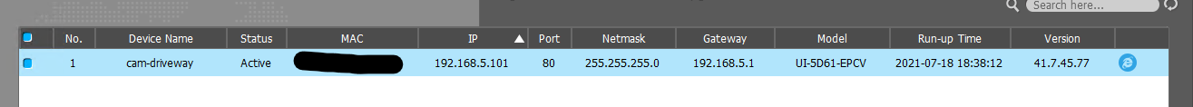

The camera has been running fine, but recently the Web GUI and all video streams have stopped.
Camera is powered by PoE and I've restarted it a few times, it re-appears in the device list on my router, but the Web GUI and Video of the camera doesn't work. In the PoE section of the router (Ubiquiti 16 Port PoE+ switch) I see it's initial boot power draw that's high, then a lower constant draw a few mins after booting. When using the Milesight IPC Tools (v2.4.0.3-r2) I see the camera and the correct IP address etc displayed when discovered and I see broadcast packets in Wireshark.
I'm unable to get to the WebGUI, is there anything else I can try before getting the ladders out and trying the reset button that's on the side of the camera housing?

Hi @DanDanDanP
First off I would recommend you update the camera's firmware to the latest version - v41.7.45.78-r1
After updating can you share a screenshot of what you are seeing when logged into the Web GUI?

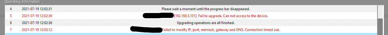

You should be able to update firmware from Smart Tools.
Once updated can you confirm if you've made any network changes since the last time you were able to access the Web GUI? (e.g. changed Router, changed ISP, etc...)

That doesn't work either, the tool just pauses for a few seconds and says "Cannot access the device", I tried changing the hostname also and it failed.
