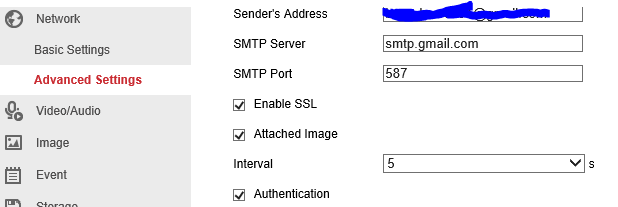

Hi I was wondering if anyone could shed some light on an issue I am having with the above NVR. I have managed to receive alert and event notifications over email such as motion detect etc. The problem I am having is I am not getting screenshots or attachments of the event. Under configuration > network >advanced settings I have selected attached image with interval 5 sec but I am not getting the attachment, just the notification.
I am accessing NVR over web interface and everything appears to be working fine except for the attachments. Any help would be appreciated.

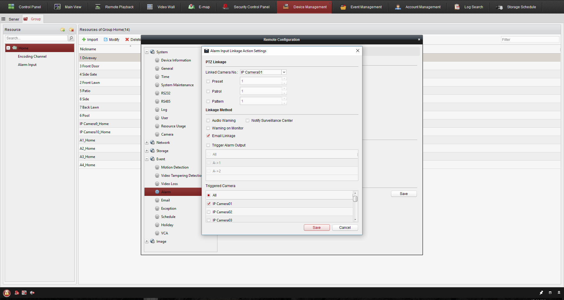

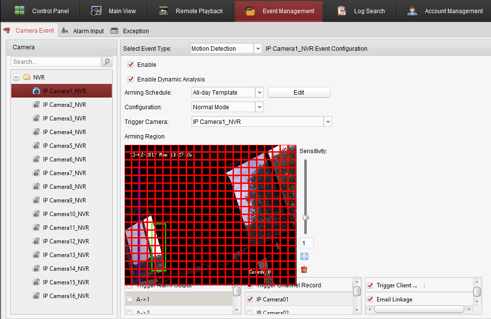

in ivms4200 interface under Event-->Alarm there is a section where you nominate which cameras are triggered, you get images from each cam nominated.
Hi Geeman,
Thanks for feedback. I have checked there and it looks OK. I thought I read somewhere that you need to point to where the system stores the files that it is going to send as attachment. I haven't been able to find that again however. Event emails are being sent as expected, just no attachments....
