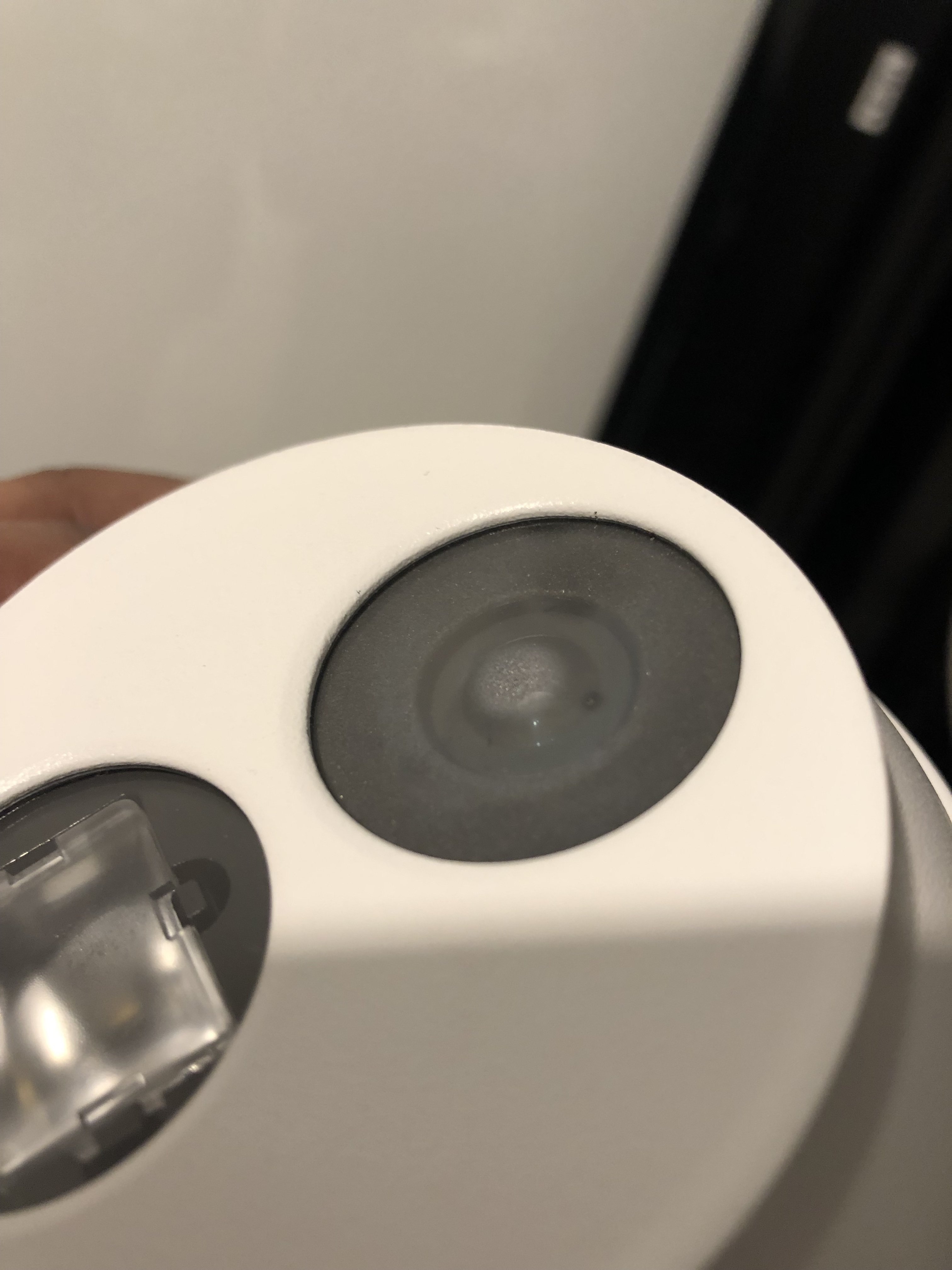

Hello, I hope you can help/advise.
I purchased a number of HIK turret cameras a few weeks ago.
I’ve only just got round to starting to install them over Christmas. The first camera is now up and running but I’ve noticed that when it got dark outside the lens has fogged up with moisture on the inside.
Is this normal or a faulty camera/seal? Can I do anything about it?
Any advice most appreciated...

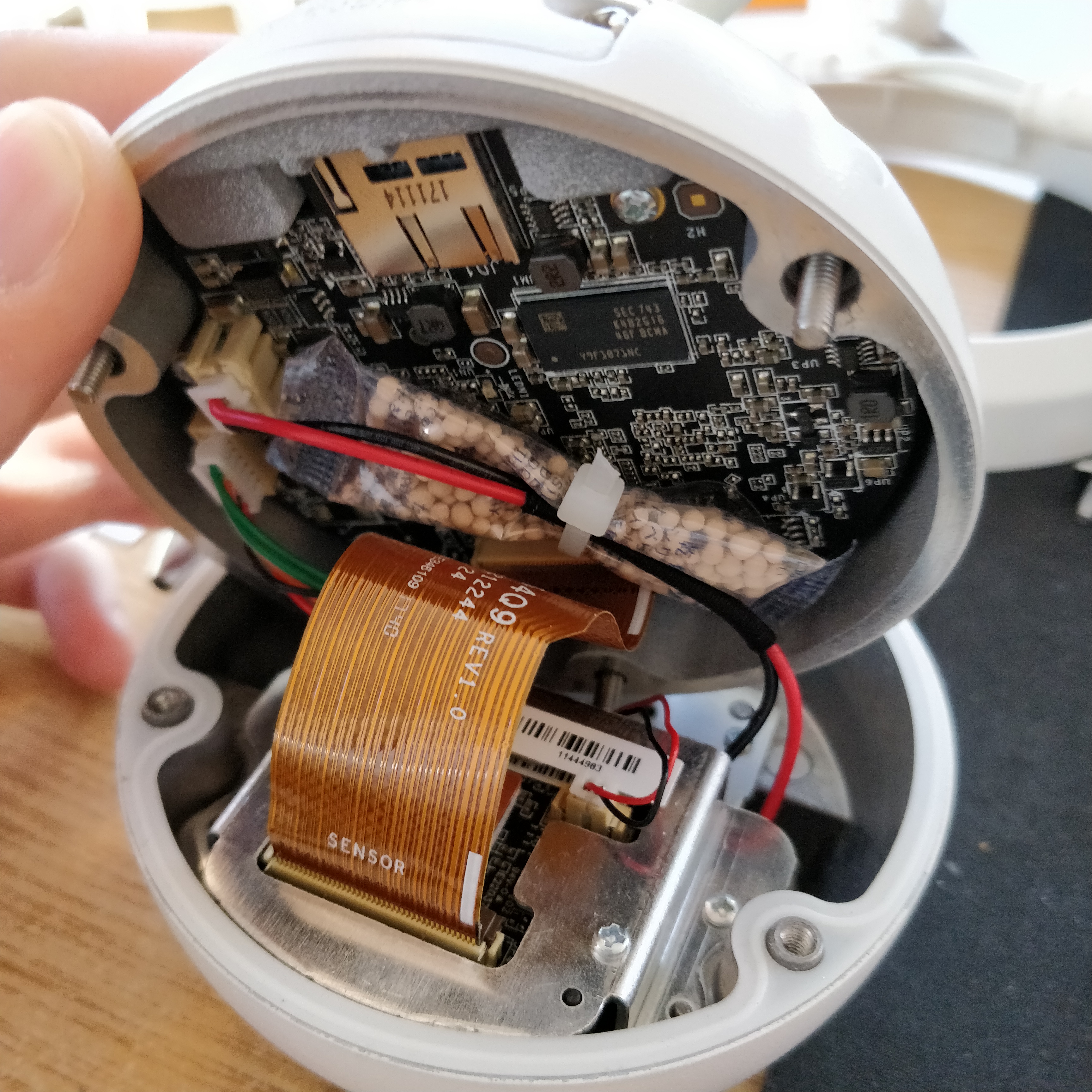

We have three here returned for the same symptom now.
All are 2385 turret cameras produced 12/2017 with 6mm focal length.
We have split the ball and checked, they do have a bag of silica gel within.
We'll take this up with Hikvision.

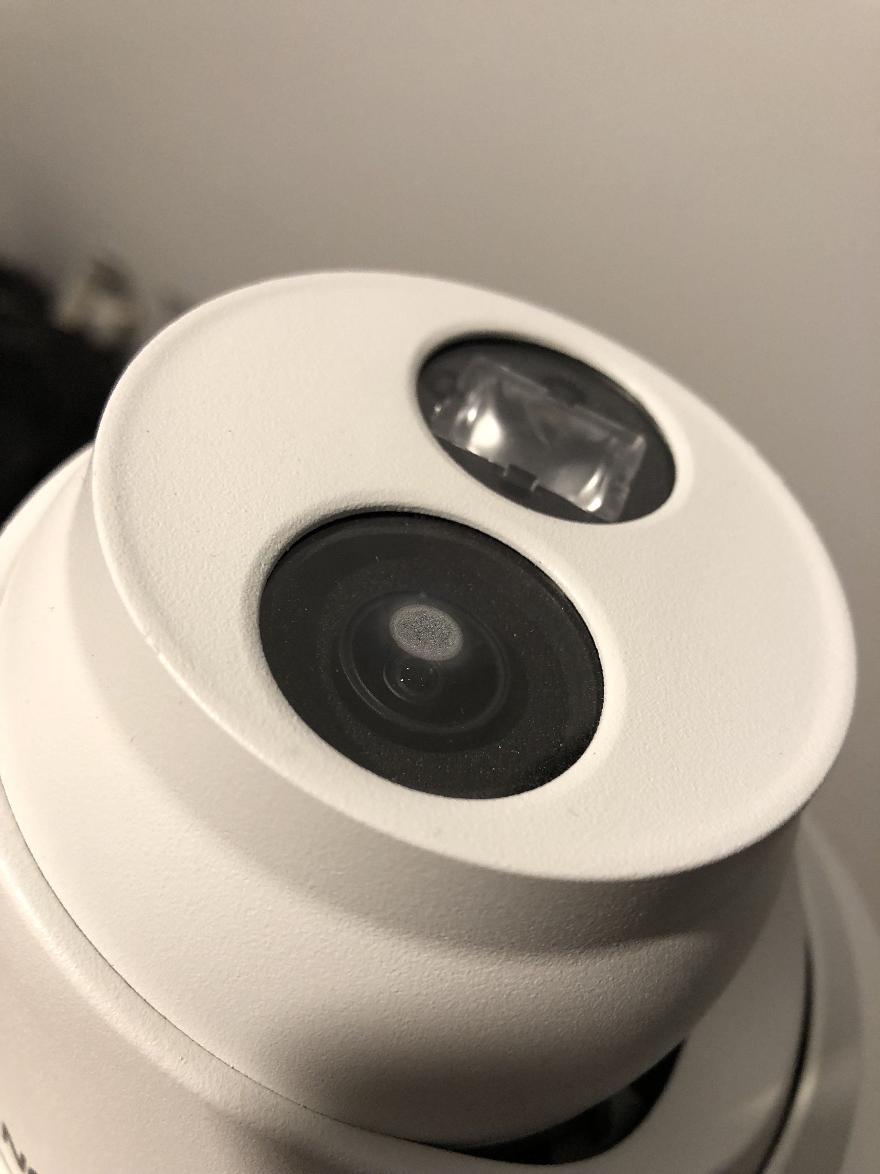

i have two hikvision 8MP 2CD2385 turrets.
They both had condensation/mist over the lens once installed outside (a few days ago). It cleared after about a day.
One was alot worse then the other
Is this normal behaviour?

It's not unusual for mist to appear when first installed - inside the camera is warm / outside is cold.
It usually clears-up on its own in 24hrs.
As long as the silica gel bead bags do their job; attract and dry-up the moisture it's not a problem.
