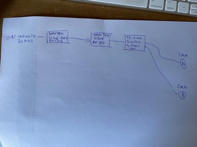

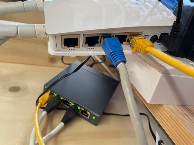

FrankR
4
Thanks for interest. I hope the attached help.
Frank

Your network setup looks OK.
I can see a website for your manufacturer, but I cannot find your cameras there - BESDERSEC
Are these brand new cameras?
Have you ever set their IP address?
It's very likely that they ship with one common IP address, and to get two working on your network you'll need to change that IP address.
