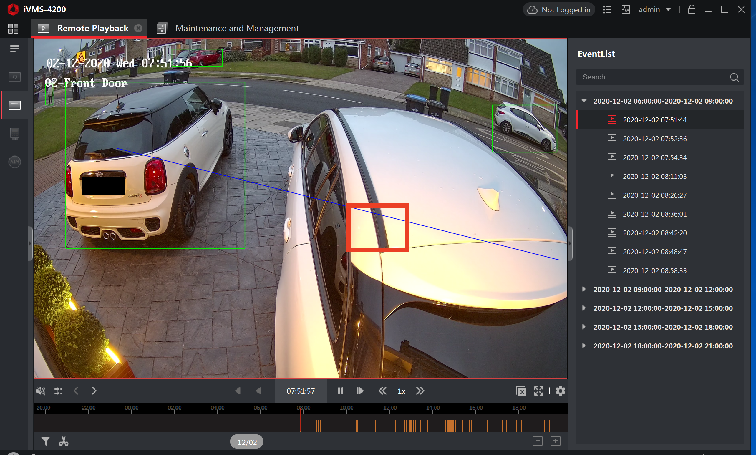

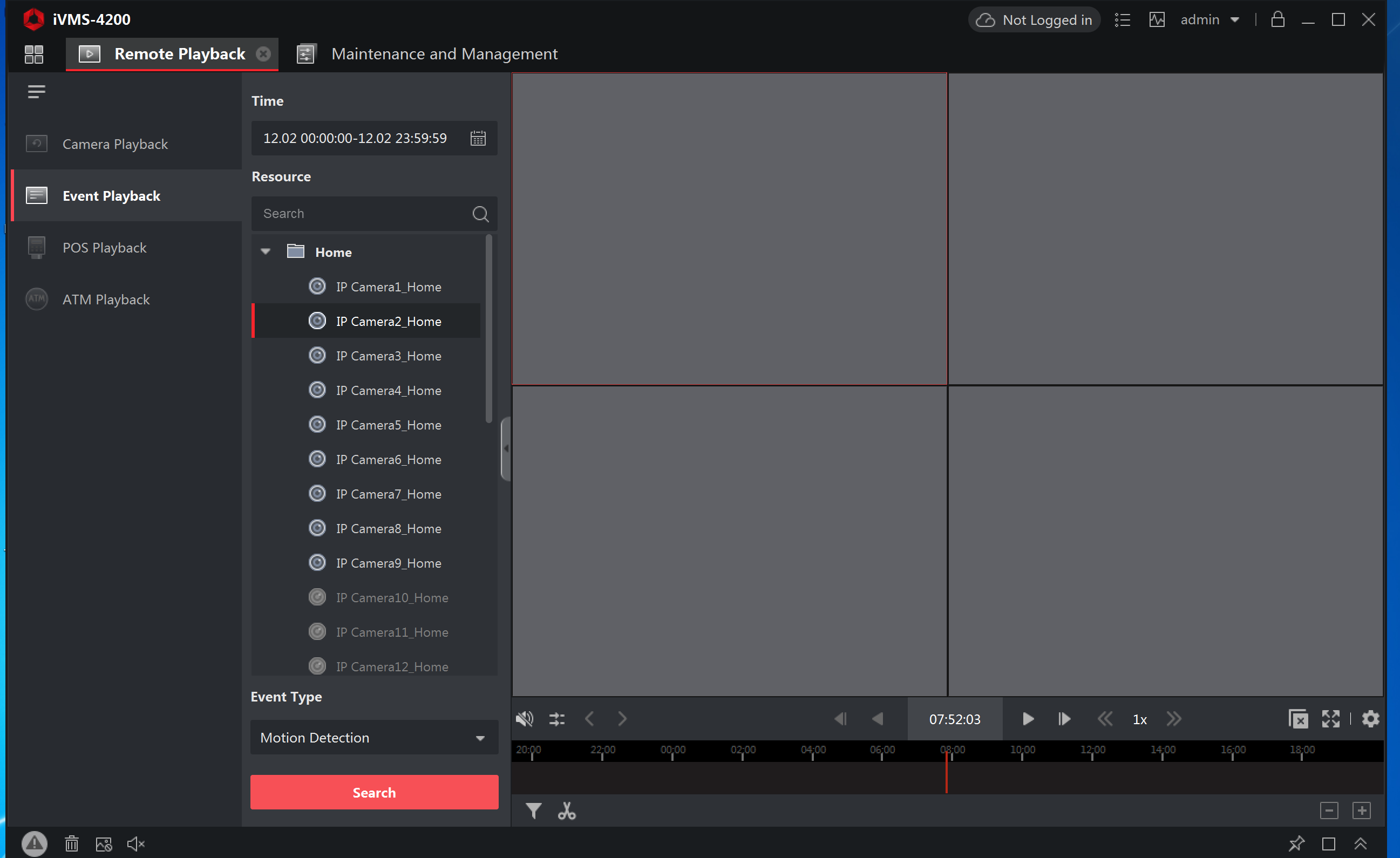

However, the likelihood is that it is one of many problems with using the event-based recording option. We always advise against recording this way and instead to use continuous recording - it is far from perfect and cannot be completely relied on, so there is always a risk that the camera will not record important periods.
If you record continuously, then you will still be able to quickly search for event periods using iVMS-4200:
I see where you are now. With Event Playback selected and the camera highlighted, click the red search and it should populate the timeline with the markers and start playing.
Hik-Connect allows you to do this too:
Hik-Connect Help - Event Playback
