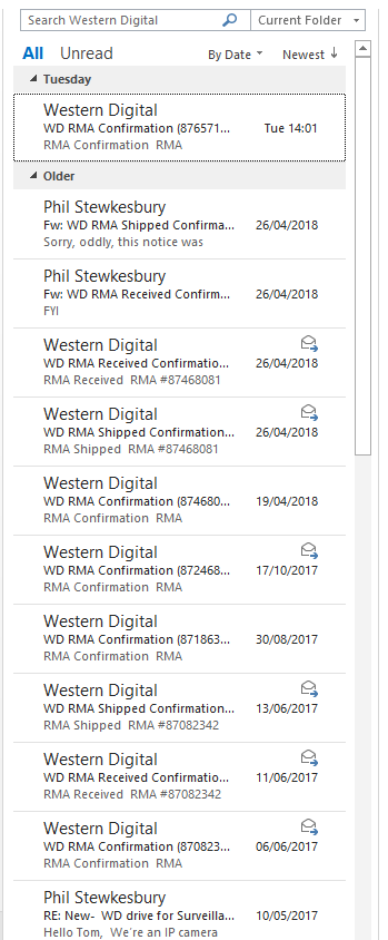

We sell a lot of drives e.g. the sales value of drives is greater most months than for second-tier camera brands.
Though we ship a lot of drives, and bear in mind we have been doing so for many years, and they have multi-year warranties - we see very few failures of WD Purple HDDs.
We had one this week.
The last was almost six months ago.
WD's RMA & replacement service works very well.
Therefore, no incentive to switch to or offer Seagate as an alternative.
WD Purple is performing well for us and our customers.
Whenever our team arrange a WD RMA I am copied-in - Ground truth snapshot from my email below:
