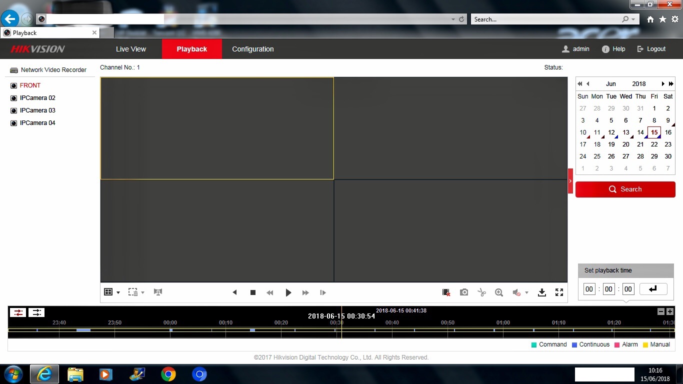

First the technician have set the NVR on MOTION DETECTION for recording and I noticed on my pre recorded videos files are not recorded on MOTION as it should ,because the next day after installation and I checked the prerecorded file didn't record my family entering into the car and driving off to school, the next file was my car already parked up without seeing anyone exiting the car and entering the house.
Therefor I gathered something is wrong so I asked the technician to set it on continuously recording next day and he did.
same problem no solid bar at the bottom of the page to indicate a recorded video file. shattered files on the Bar. Contacted the technician again to check and he did that. but nothing work. same problem.
Live view is perfect.

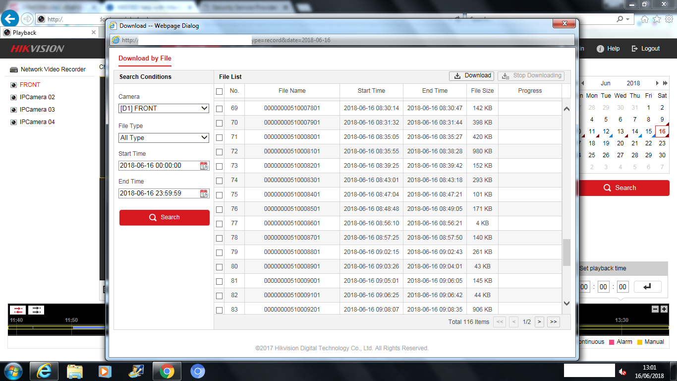

yesterday 1 typical hour showed on the recording bar just broken 8 broken files each file contain about 5 seconds of recorded video (photo attached) instead of a continuously recording.

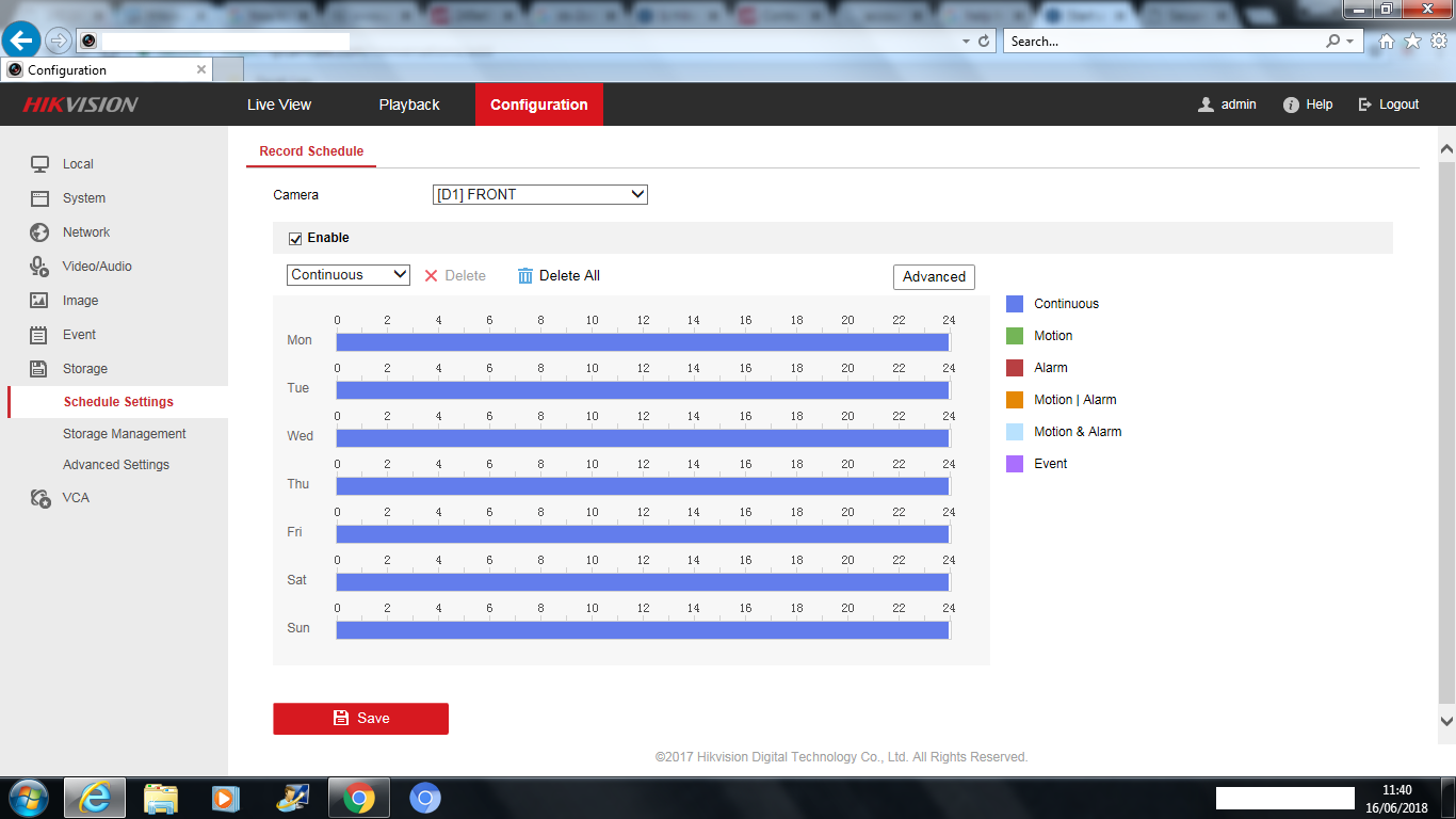

It all looks like my working system. Might be worth a check in the advanced settings of the schedule, but can't imagine what might be wrong there.
Standard advice would be to turn it off then on again! Check the NVR firmware is current in case of a bug.

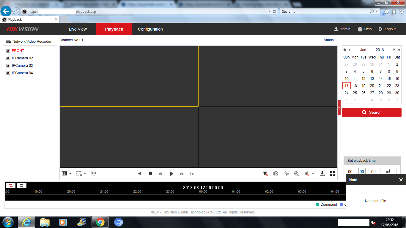

Turn it off a few times before and still the same. Just got worst. all recording gone
It was on motion detection in the first day only 9-6-18. since then on continues record, the record videos files are getting shorter and smaller

The NVR defaults to continuous recording, so mine 'just worked'. Can you try switching the network cable to another of your NVR ports. If it's been left alone, it should just record 24/7.
