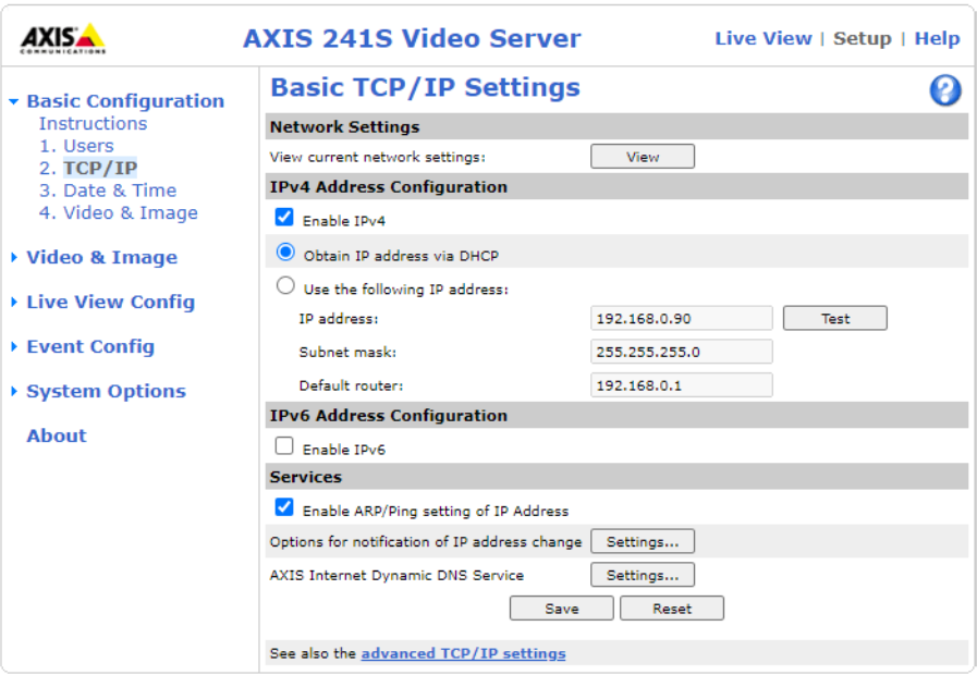

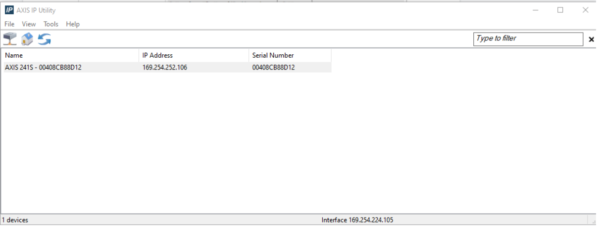

I have a Hikvision HIKVISION DS-7604NI-K1-4P NVR and a HIKVISION DS-2DF8836IX-AEL Dome camera working well but I need to add an analogue BNC camera connected through an Axis 241S Video Server but I cannot get the NVR to recognise it on the network when plugged in to the IP NVR port adjacent to the dome camera.
I've done a factory reset of the Axis and if I plug it in directly into my PC and use the Axis IP utility it appears & if I double click it I get video feed and the ability to create a security certificate (?), change the IP address, set a logon & password etc. in my browser but transferring these values to the NVR camera setup and selecting 'Axis' Protocol from the options I constantly get a 'network unreachable' message on the NVR and no video feed.
I'm not that experienced with network cameras so I'm wondering if what I'm trying to do is actually possible or if I'm using the wrong IP address or some other config setting in the NVR camera setup that I need to change. I've tried swapping from DHCP to 'Use the following IP address' with no joy.

Yes I have a Ethernet cable from the 241S to one of the four Ethernet camera ports on the Hikvision NVR. I’ve also tried it in the NVRs other ethernet port, but neither with the NVR picking it up. If I plug the 241s straight into my pc ethernet port I can get the video stream in a browser so that would appear to be working.

Thanks Dan,
Could I not change the Axis IP address to a static IP in the range used by the Hikvision NVR, say 192.168.254.99 for example ?

1,296
83
potentially, but the NVR may not recognise the server as a device that can be connected to one of it's IP camera channels. Also, as said above even if you can connect it directly you will be limited to the control over the camera you have because the Hikvision NVR will not be able to control any of the specific settings of the AXIS camera or the server.
