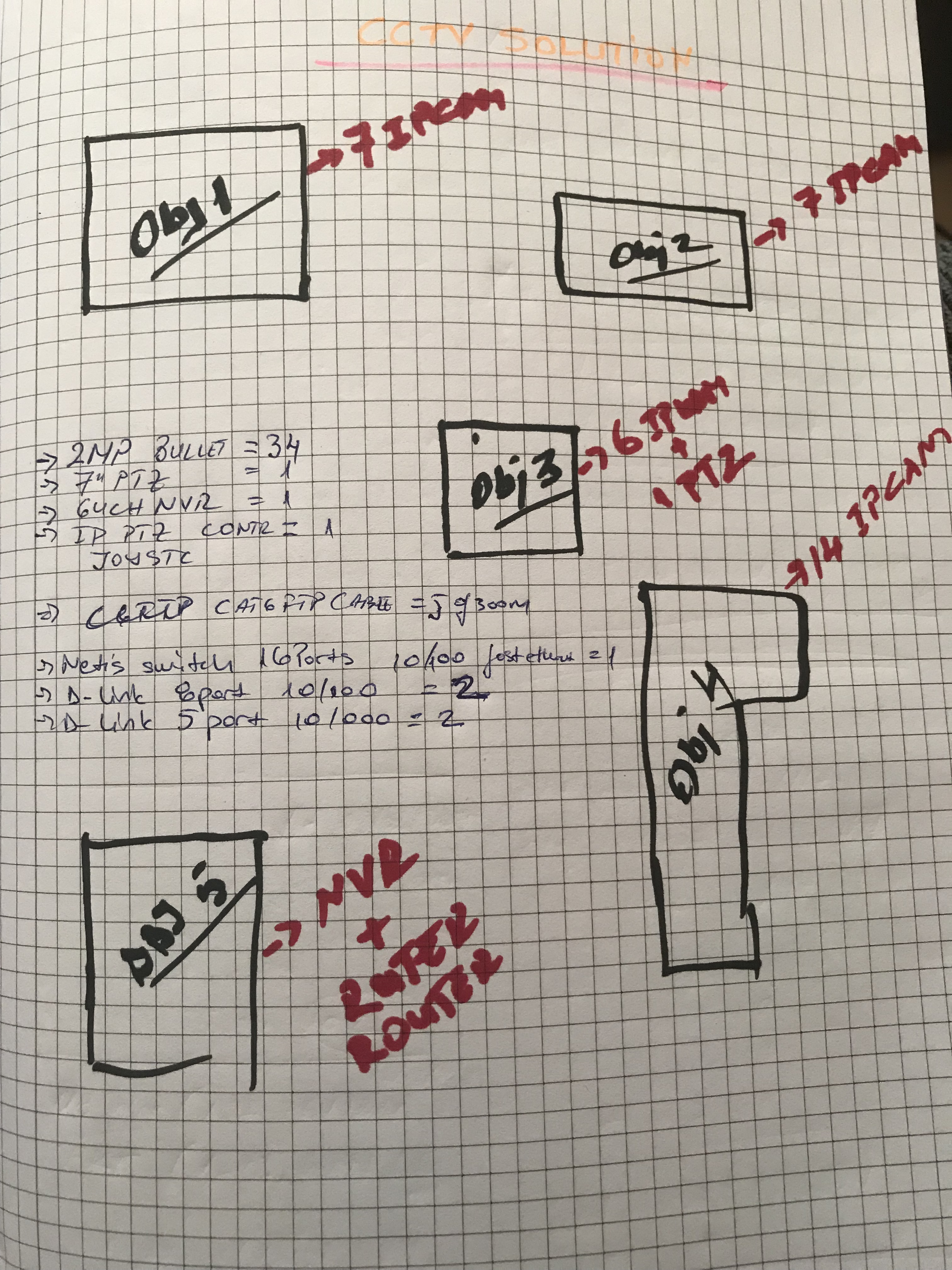

1.I have to install all cameras in these objects as you see in the photo .
2.I have devices as described in the pic ,34 ip cam, 1ptz cam,16 port switch etc.
3.How do you think is the best way to connect these devices with equipment that i have in hand.Do i need to add any other equipment ?How to connect switches to each other to make it work in its best.All the solution is Longse Brand and joystick too accept switches.

It's mainly a matter of convenience for wiring.
Wit perhaps some fixed poit restrictions e.g. somebody has dictated where the NVR must be positioned.
All have to be on the same network.
The nominal maximum network leg length (with or without POE) is 100m.
