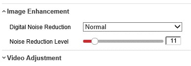

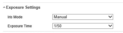

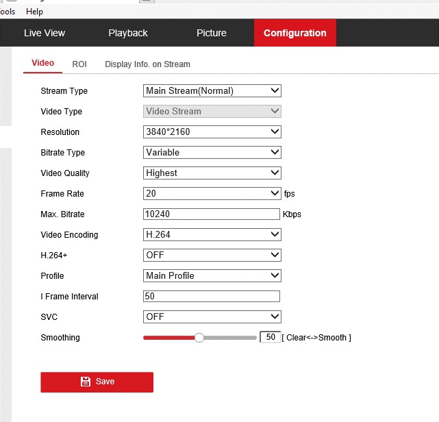

I am on the latest FW and here are my settings:

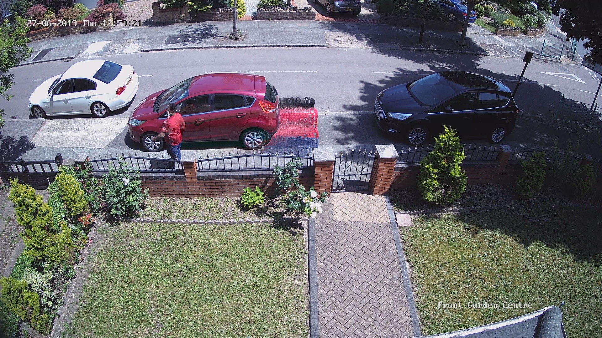

Here is sample:

Maybe your NVR is having trouble with the frame rate. Try lowering it to 15fps and see if that fixes it. If so, raise the frame rate incrementally until the problem returns, then go back to the last one that worked.

I had the same issue, so I contacted hikvision directly, I ran it at 20fps and bitrate at 4096, then once it's smooth, try increasing the bitrate.
On the higher bitrate, I do find it slower for liveview/playback as it has much bigger filesize per second to stream.
Try this, set the frame rate and the I Frame Interval both to 20. Test that and see. If it still ghosts, keep the frame rate and I Frame rate interval at 20 but drop the bitrate to 4096. If that makes an improvement we can adjust from there. Keep us posted.

The way I got mine going was:
Upgrade camera and NVR to latest FW.
Now using H.265 not H.265+
Turned max bitrate down to 5120
Resolution is still highest. 3840x2160
