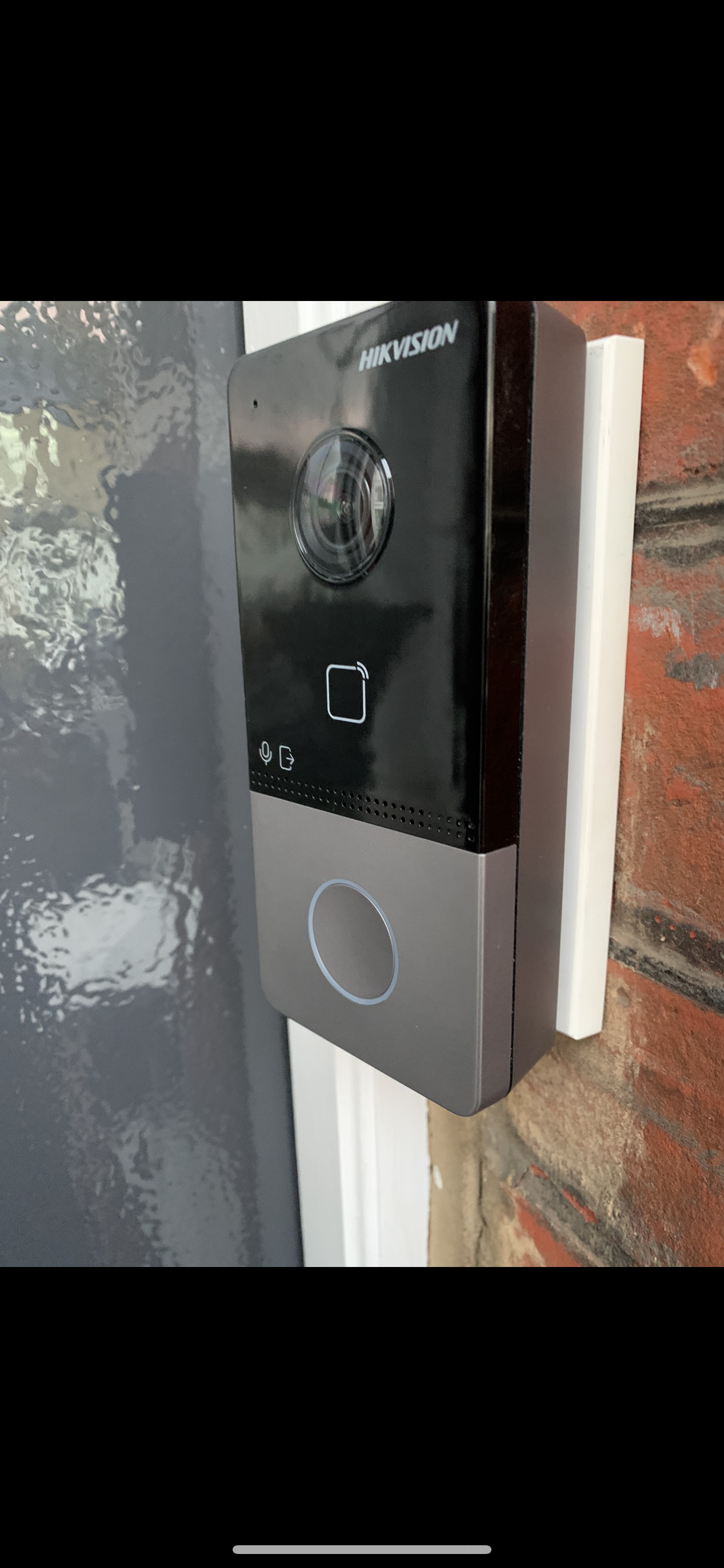

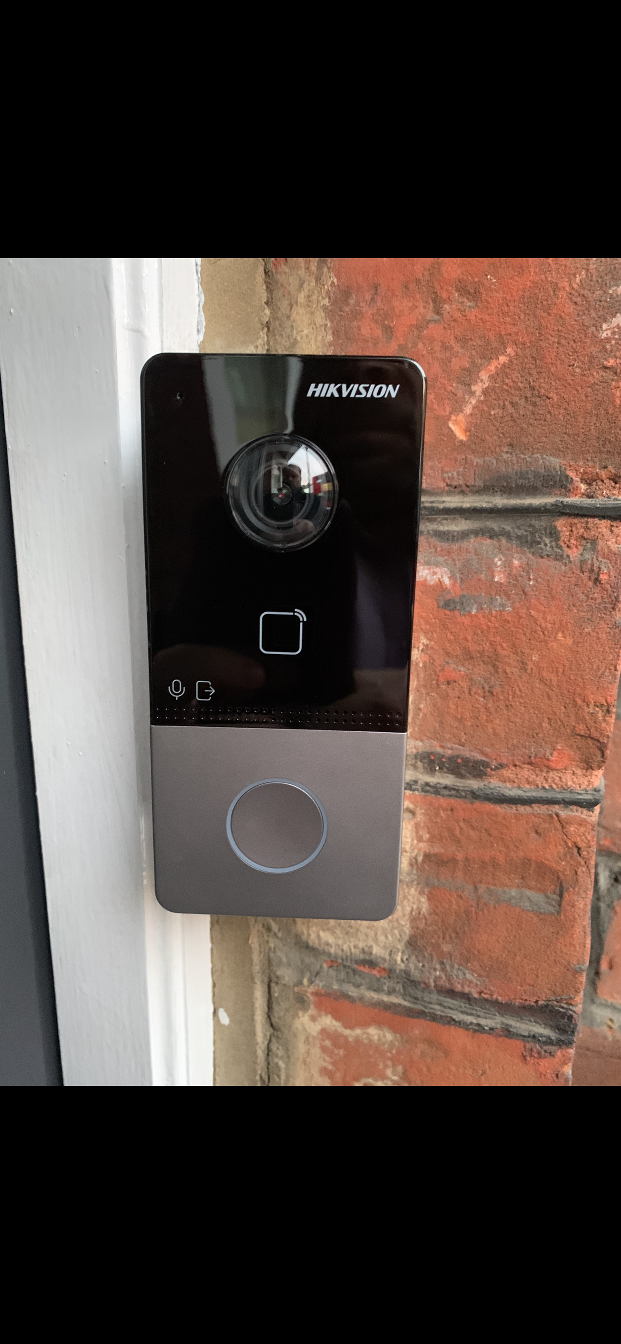

So I’ve bought and installed one of these in the UK.
I thought I’d put a few notes on to help others who might buy one as the UK dealers know nothing about how this item works as yet, and I’ll ask for some help on my issues I’m unable to overcome.
Well the item is very slick has an in built card reader and 1 door/gate opening relay.
if someone wanted to setup and use this device you can do without an indoor monitor and use IMS4200 however note it will not connect to the Hik-Connect app. i wanted this function so I bought a indoor unit 6320 and it now works with the Hik-connect app.
When you log into your DVR under IoT you can search operations of the access control and cards etc which is good although it doesn’t take the names you programme in IMS4200 just the card number.
I was warned the the WiFi was not enabled as yet in the UK, I’m not using this but the current software update on the uk Hik-connect server opens this option.
You have a master card to programme cards at random however you can programme without via the web app or IMS4200.
You do not need a card reader to programme cards, when in IMS4200 programming cards you can select it to read cards from the unit and this works perfectly, I have programmed 1k standard size cards and generic key ring mini fobs

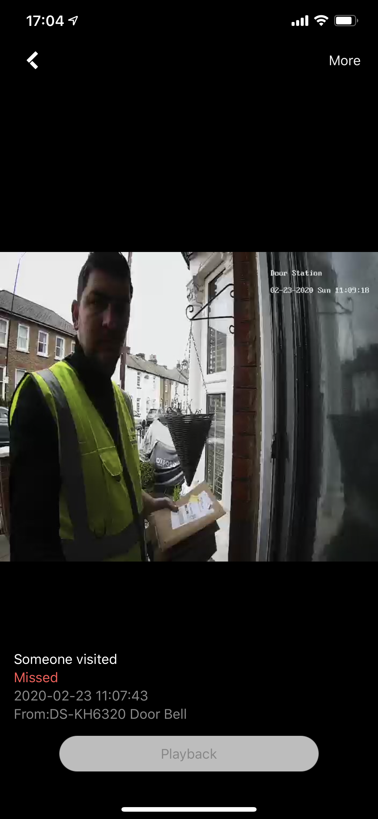

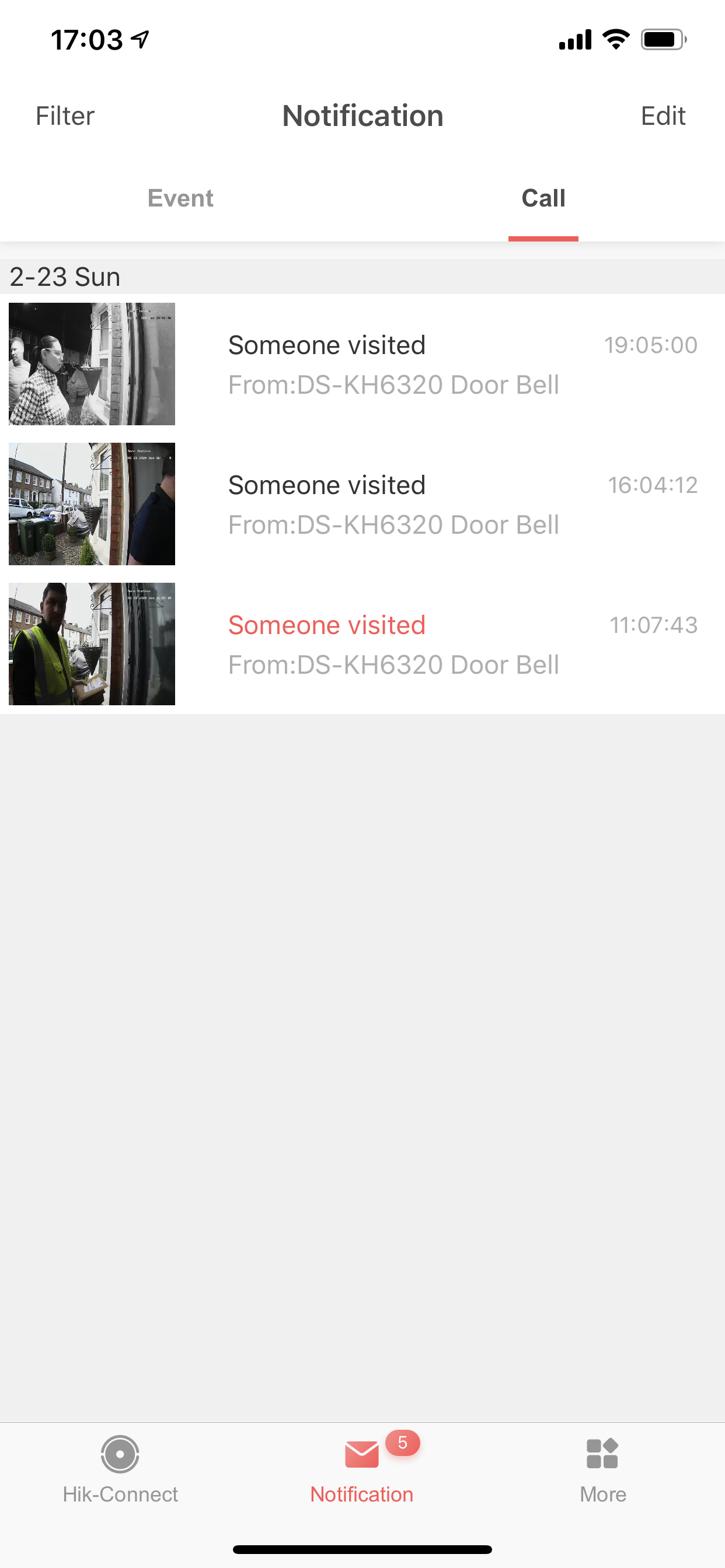

Currently I can see missed calls however only a photo as my attachment and I’m not able to review these in anyway, note the grey out playback tab at the bottom. Should it show me a video and or let me search video on the unit. I cannot find any settings for this

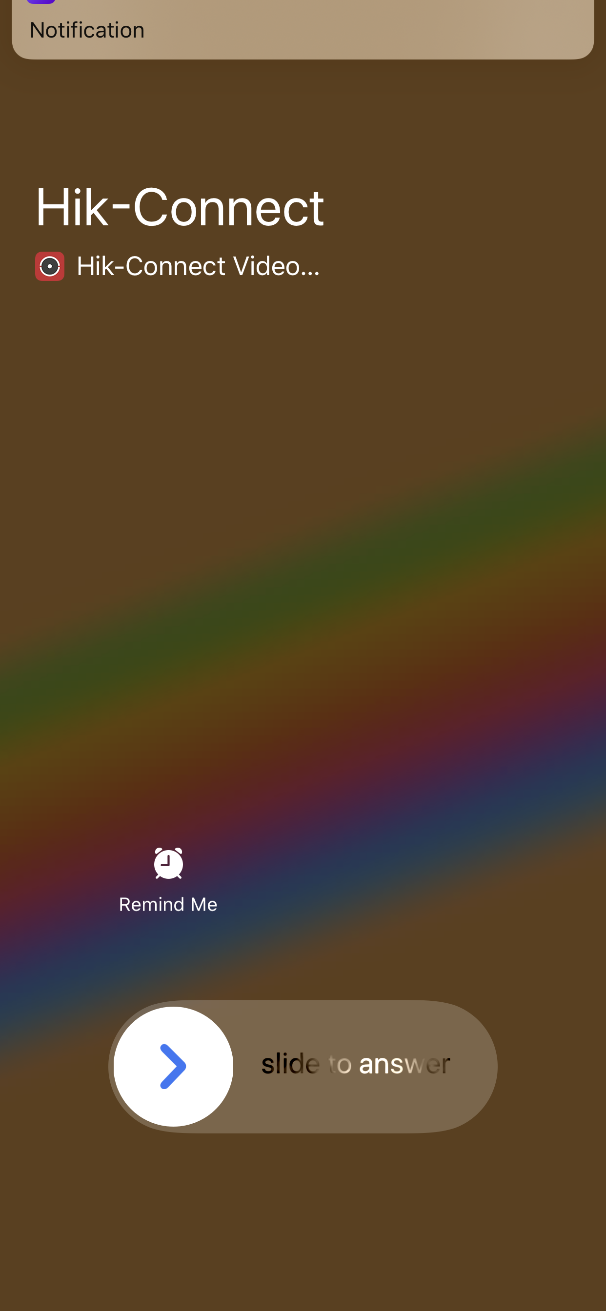

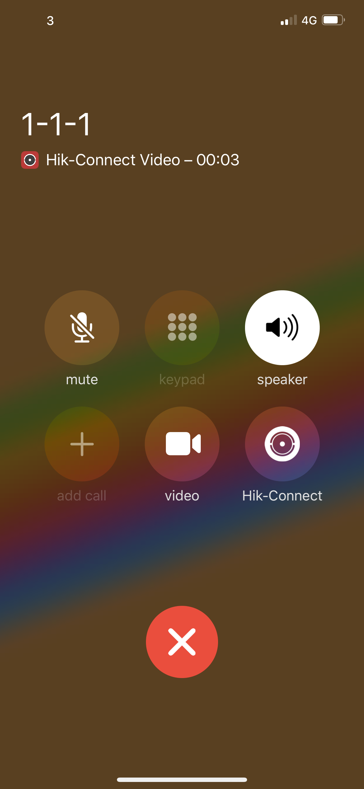

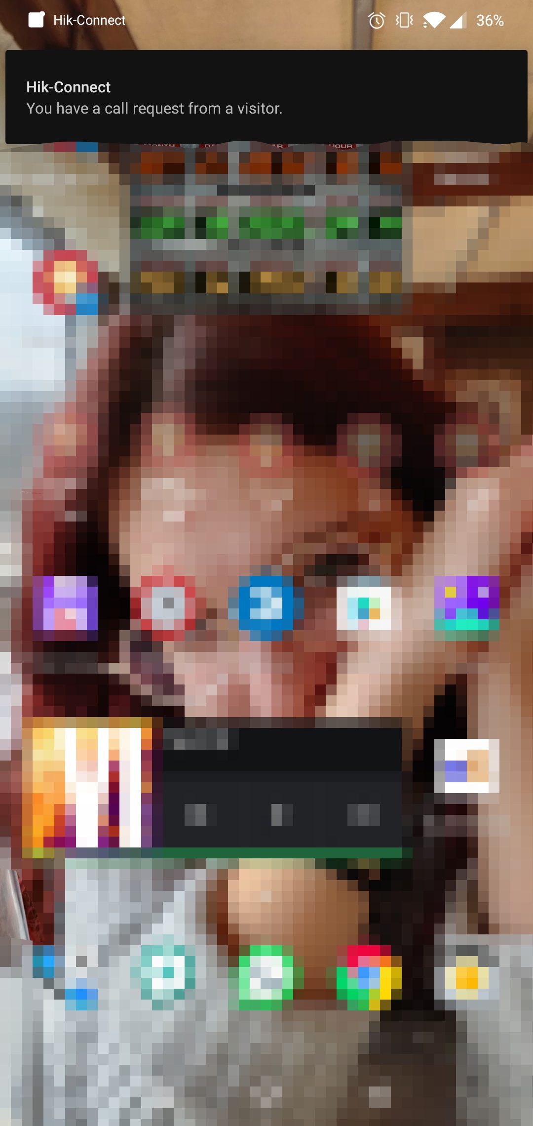

Since the update it now rings as a phone call (iPhone) The majority of the time it then allows you to open the app in the call and it then doesn’t open the correct part of the app so you cannot see who’s at the door or talk to them correctly as you used to be able to.
It doesn’t record videos even with the internal screen and memory cards in both units, it does however if you connect to a NVR and let the NVR record it but you cannot just go to an event in the simple way like on a Ring doorbell. See my other posts on it

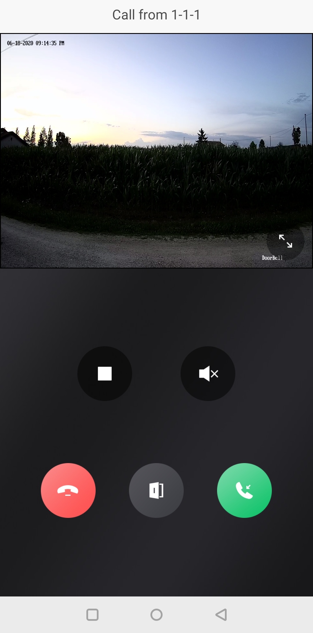

I don't agree with your description, I have just tested the situation, I'm out and connected to internet with my smartphone (Android), ask to ring the door bell from home, after the forwarding time set, my smartphone rung and next I've pressed on the notification and it shows me the video and I can open and reply.

That’s exactly how the iPhone app was until about a week ago. It now rings like a phone call and let’s you open the app from the ringing screen so they’ve done some integration with the Apple software, however it opens in your app in a random position not like your screen like it did up until the update.
Yes. Now I've understood, I hope Hikvision will invastigate about it, and let's see if they will fix this problem.

I’m experiencing exactly the same with my door phone. It’s incredibly annoying and had I not just flush mounted the outdoor unit, I would have already returned it. Any way we can report this?
