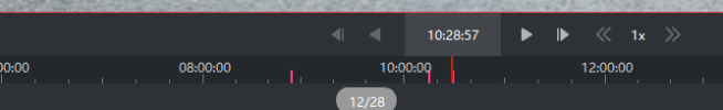

2347 - I had some issues with the image stuttering on motion previously and that seems to be ok now following update.
2387 - since installation this has had an issue with the image momentarily blanking, going dark as reported in another thread. The update has not helped. This may actually be a faulty camera as it's not a freeze/stutter, more a very brief loss of image.
One anomaly I've noticed on this and the previous firmware is that the recorder switches into Event Encoding Parameters (main stream(event) video settings) when there is motion in the image - even when that motion is outside of the area defined in the settings. For instance a car driving along the road will not trigger an event as it is outside of the detection area I've set and I have the cameras filter set to Human only - however in the Maintenance > System Info > Record screen of the NVR the encoding parameters column switches from Continuous to Event each time a car passes or someone walks past outside the configured area.
