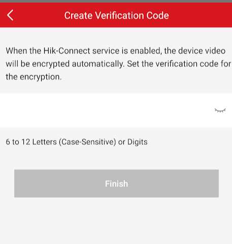

Installed the App on my Android phone, created a Username & Password, received the verification code on my phone, make a device password, and was all looking positive until I hit this:
So it says "Create" Verification Code
Ok, so I thought up another unique code for this and got the following:
I did some Googling and it appears there used to be this code on a sticker on the unit, but that's not there anymore.
And something about new devices as you to create a code?
I've tried various codes I already made, and anything off the box (serial no etc) but nothing works.
I'm rather stuck, as it appears to be asking me to create a code, but won't accept anything I enter.

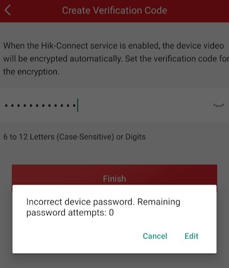

I did this, and was then asked for my ADMIN Password.
Was not quite sure if they were using the same terms all the time.
So tried entering my DEVICE password. That did not work.
Then tried using the Password I created using the Hik-App (username/password) last night, and that didn't work.
I've only got 1 try left :(
Before I run out of tries, Any ideas, where/how I create this ADMIN password that SADP is asking for.

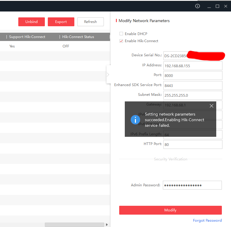

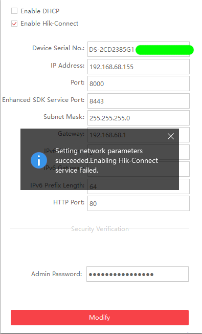

For some reason I can't get Hik-Connect to turn of, as I get this odd message when I try to enable it.
Bit of a puzzle, but hopefully there is a way around that.

Still puzzled about the Hik-Connect error shown above.
I did use quite a few non alphanumeric characters in my camera device password, but I only used A-Z and 0-9 when I created the Hik-Connect verification code.
Any thoughts most welcome :)

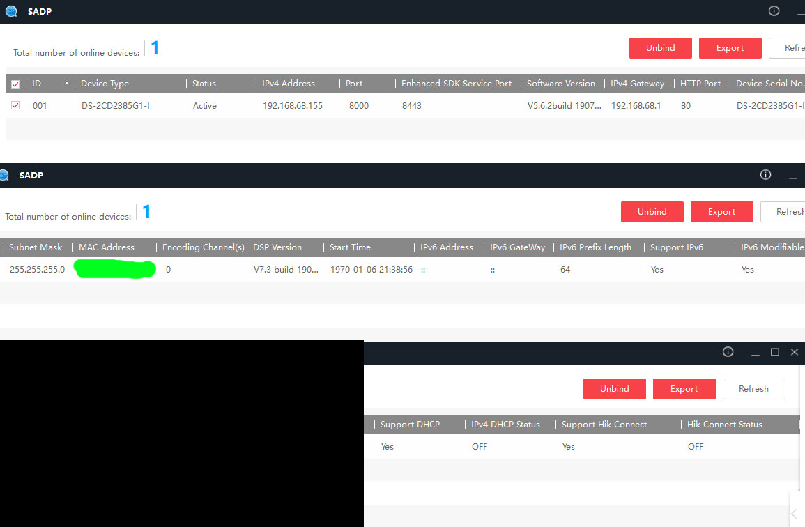

Whenever there's issue to do with connecting a device to Hik-Connect, it's usually a result of the wrong network settings being entered on SADP. Double check all these match your network, is the gateway address definitely correct? Does enabling DHCP make a difference?

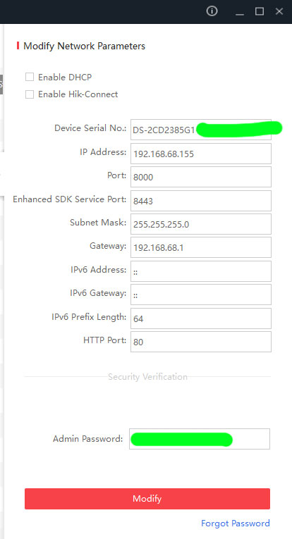

Could you attach an image of the network settings without the error message so everything's visible?

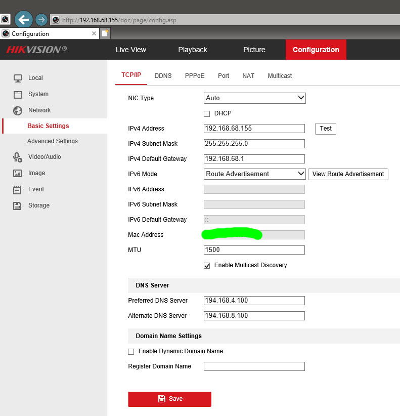

However, as per your request I have taken some screen grabs.
I did multiple grabs and stacked them as it's a l-o-n-g sideways list in SADP :)
I tried enabling DHCP (not sure if I wanted it on anyway) and I can set that on and off successfully (I set it back off again after trying)
I also tried again to enable Hik-Connect and it throws up that error in my last image.
It throws up the error if I try enabling it on it's own, or at the same time as enabling DHCP.
Please see below all the info your requested.
Welcome any suggestions/thoughts.
For reference, all I have done is Factory reset the camera, Ran SADP, set up the device password, and activated it.
Also able to view live feed, and fiddle! with various settings via Internet Explorer.

Can you login to the camera using Internet Explorer on a PC on the same network?
NB Internet Explorer NOT Edge (the blue 'e' icon with the gold flash.
If you just type the camera's IP address (192.168.68.155 from the above image) into the browser address bar you should be prompted to login.
Hi Phil, thank you for the reply.
Oh yes, that's fine.
I managed to get that working last night :)
I can log into ye-olde Internet Explorer fine, see the live view and fiddle with settings :)
What I cannot do is enable Hik-Connect in SADP, as whenever I tick that option, and press Modify, I get the blue error box pop up, as shown in my earlier post #11 above.

Can you please upload a screenshot of your Network Settings page from the Configuration area when logged-in with IE?
Snaffy
Member
31
8
Thread starter #17
Any good?
Just to note I've not changed/adjusted anything.
The camera was reset using the button, SADP used and a device password created, and the camera was activated.
It then was (I guess) assigned IP details by my TL Link mesh WiFi.
Phil
Administrator
Staff member
3,269
83
#18
Can you please set the DNS IP addresses to Google's:
Preferred = 8.8.8.8
Alternate = 8.8.4.4
Save, and then check again whether you can see your device at Hik-Connect.
Preferred = 8.8.8.8
Alternate = 8.8.4.4
Thanks for the suggestion to use Googles DNS.
I changed the settings exactly as you suggested.
But makes no difference to my issue.
Just to check. It's not that I can't see my device as such, (which I of course cannot)
It's that I cannot enable Hik Connect via the SADP app on the camera in the 1st place.
When I tick the box, and try to enable Hik Connect I get this error box.
"Hik-Connect Service Failed"
