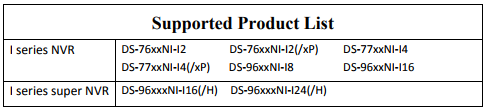

HikVision have released new V4 firmware for some NVR ranges today.
It's a big change to your user interface, so you might want to set some time aside (and maybe wait a few days for feedback from the pioneers) before making this update!
As ever, the latest firmware for your HikVision NVR is available at their European Downloads portal: DOWNLOAD PORTAL
Their Press Release can be read here.
At the moment this new version is only available for suffix '-I' NVRs.
It's unclear what HikVision mean by this comment in their press release - "Older devices will also be to benefit from the new firmware"
The Release Notes are below.

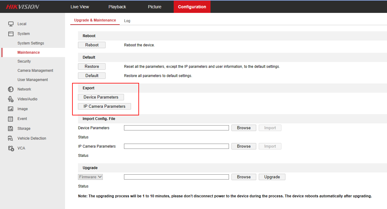

Upgrade / downgrade for testing?
Just FYI - our demo HikVision 7716NI-I4 was running V3.4.95 firmware.
I updated it to V4.1.10
Then downgraded it to V3.4.96 firmware.
The upgrade went well, I only had a very quick look around.
The downgrade has caused problems - our NVR is reset to inactive AND bleeping for an HDD format!
The downgrade caused it to completely reset to factory defaults; IP addresses, camera setup and other settings all reset.
I didn't have to reformat the HDDs, after resetting a few parameters the bleeping stopped and I was able to review previously recorded video.
So, it does seem possible to upgrade/downgrade, but not without some re-configuring.
I would recommend that you export your parameters before updating just to be cautious.

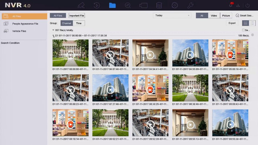

If you normally use the web interface i.e. access your NVR via your browser, then you will only see minor improvements.
Whereas, if you normally access your NVR via a direct-connected monitor, mouse & keyboard that user interface has had a complete makeover. It's certainly worth a look - too many changes to begin to investigate at 5:30pm on a Friday ;)

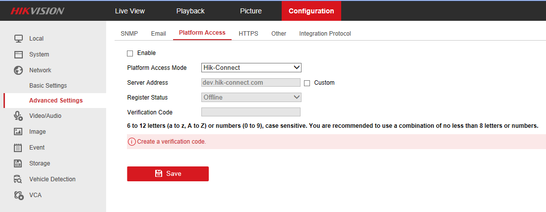

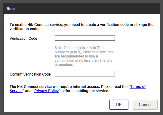

Hi, Can you clarify your query a little more for me please?
If you want to use their Hik-Connect portal, then (in V4) you still need to enter a Verification Code.

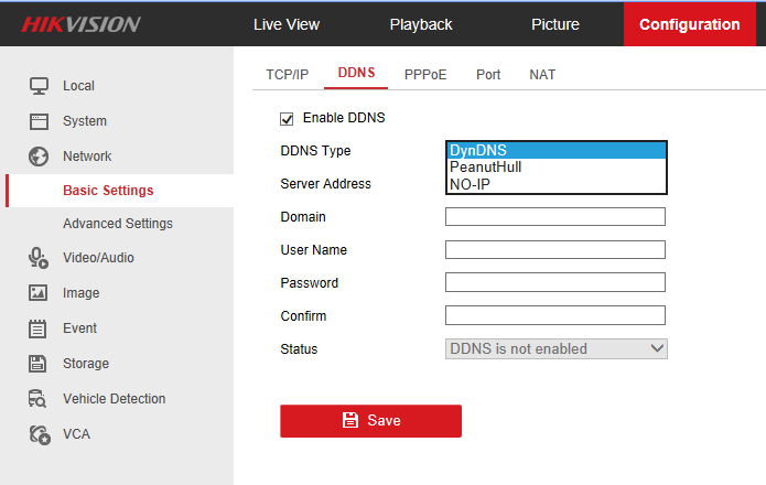

You can use other DDNS services without the verification:

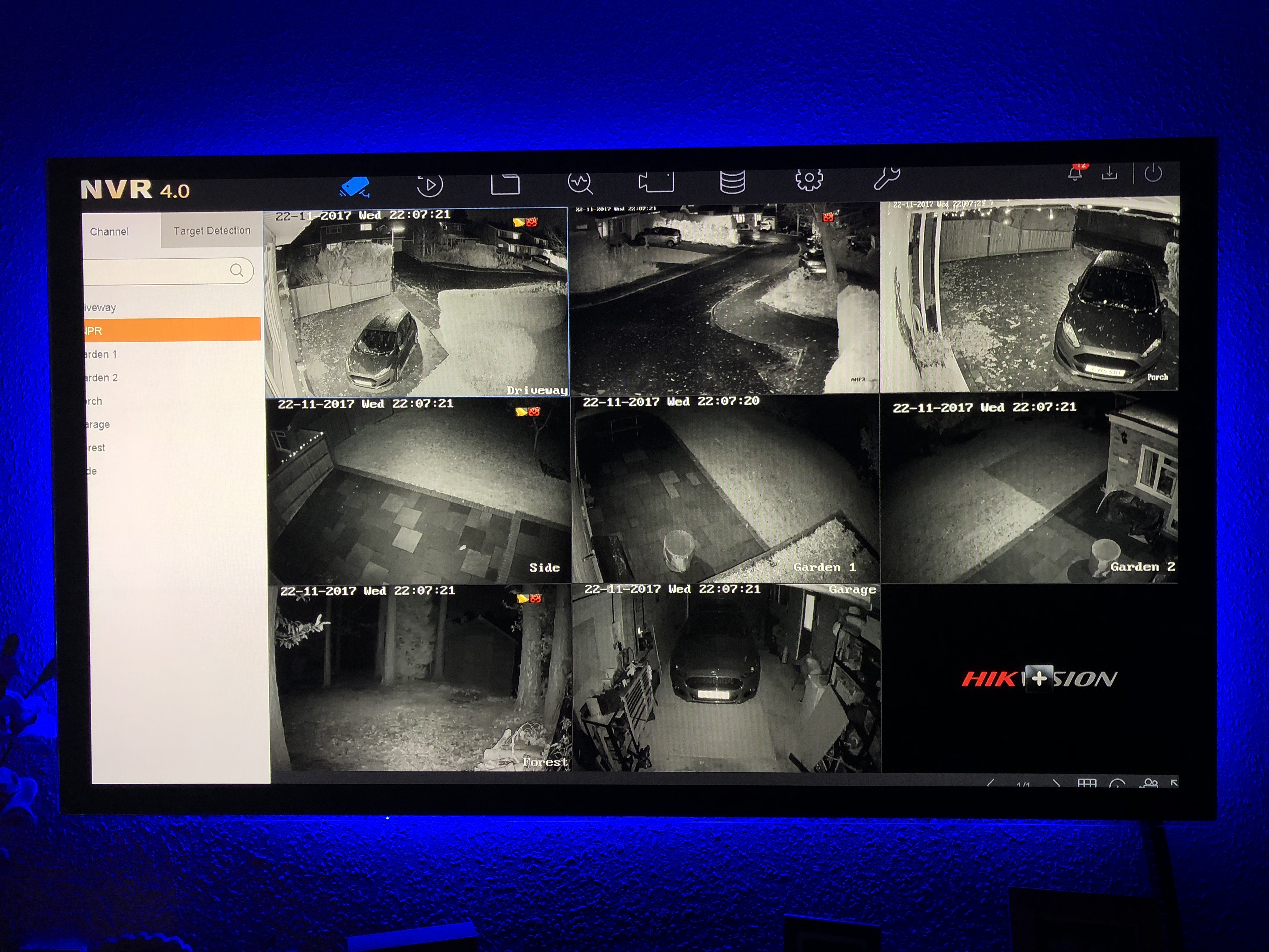

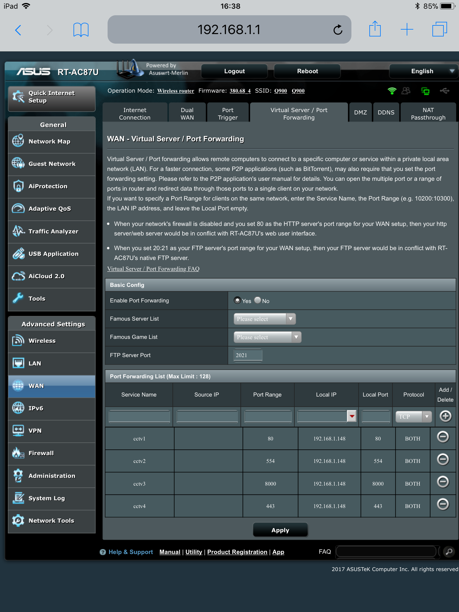

Hello Phil.
The NVR is connected and configured to work with Hik-Connect but not used to view live footage, instead I am using the Asus port forwarding facility on my RT-AC87U router which works very fast (Hik-Connect was way too slow when tested with iVMS 4500)
I had several users who could not connect and when I checked the “encrypted stream” setting it had magically switched itself on after I had switched it off..
I like the idea of using the NVR to configure advanced parameters on my ANPR camera rather than using the web interface.
I’ll give it a go and report back with my findings.. thank you

First impressions are its slicker than the old GUI but my first disappointment was no fast access drop down menu with a right clink of the mouse (Parameters/plate search etc)
The full screen display no longer switches to next camera with the mouse scroll wheel which is another feature I used a lot.
The full screen image settings menu button has also vanished.
It would also be nice if in the next firmware update they could have a screen calibration setting when viewing via HDMI on a Panasonic VT 65” TV so it doesn’t crop the top and bottom of the image displayed rendering the lower control buttons useless.. I’ve tried all screen resolutions on the tv and still cropped buttons.
Edit: Changed TV setting to “THX Cinema” and now display fully viewable.

RE: input verification code
Phil, I activated the HiK-Connect service just to make sure the unit was fully supported then disabled it and now setup via port forwarding without the need for a encryption code.
