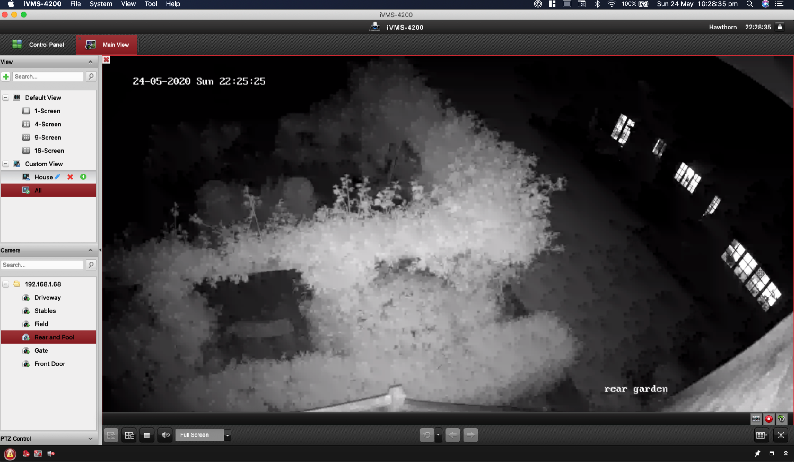

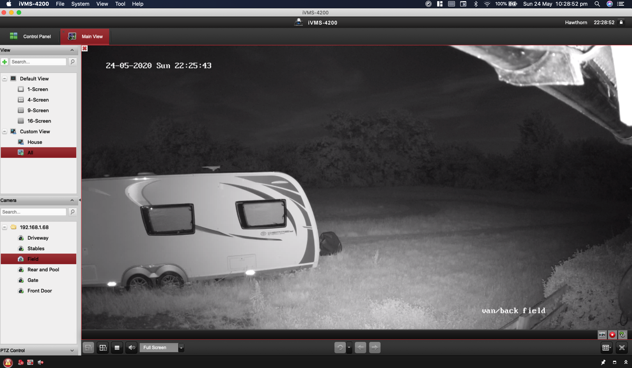

My immediate issue is that the resolution of one of the camera's in night mode seems to be very low res, whereas it is fine in daylight mode.

Can you also share a screenshot of the images you are getting from the lower-quality camera and one of the better quality cameras?

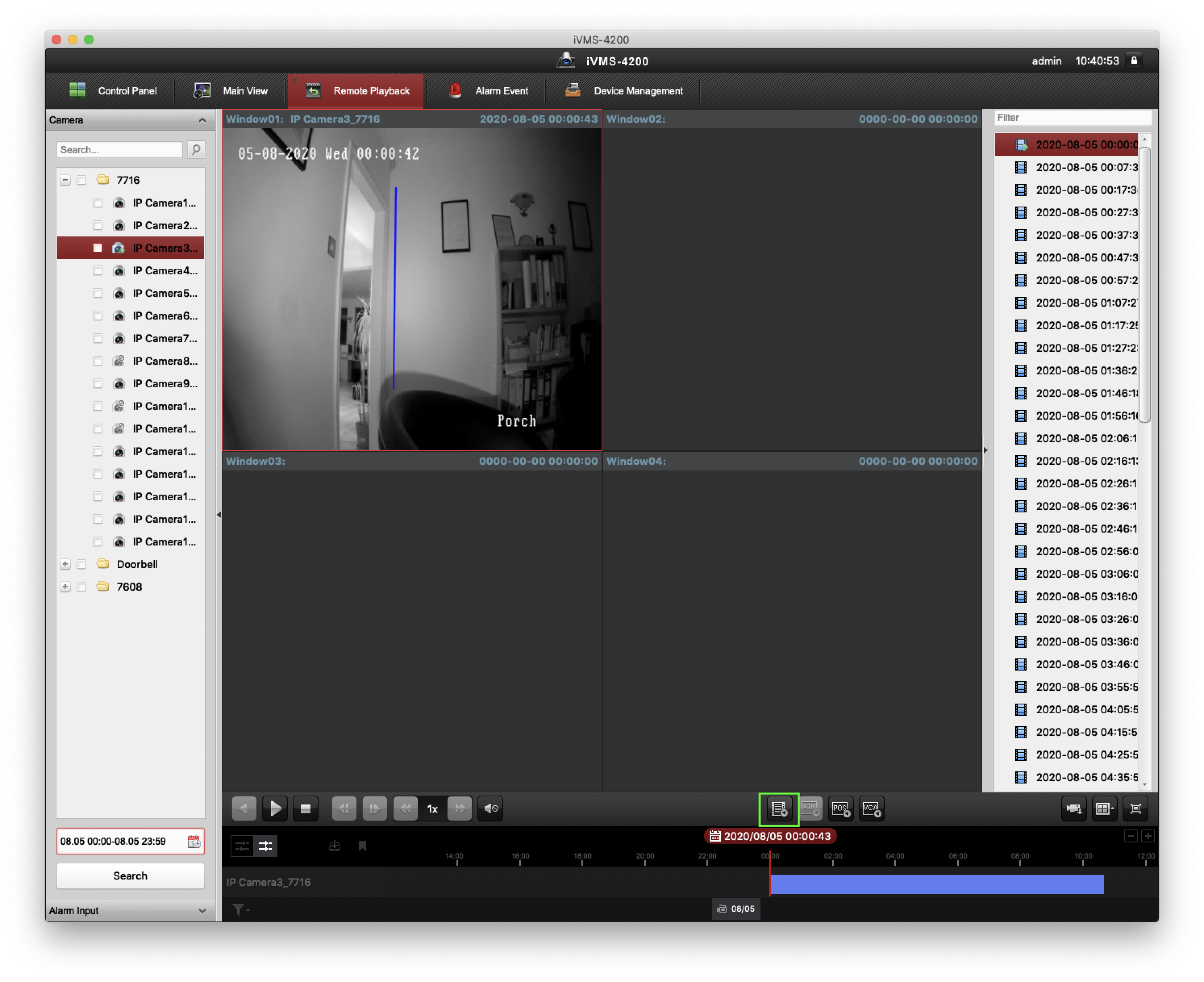

Event Notifications - If you enable a smart event of your choice in the camera settings you can then go to playback in iVMS-4200 and view the standard continuous playback or click the event playback icon at the bottom of the playback window (highlighted in green) to search for event notifications from that camera.

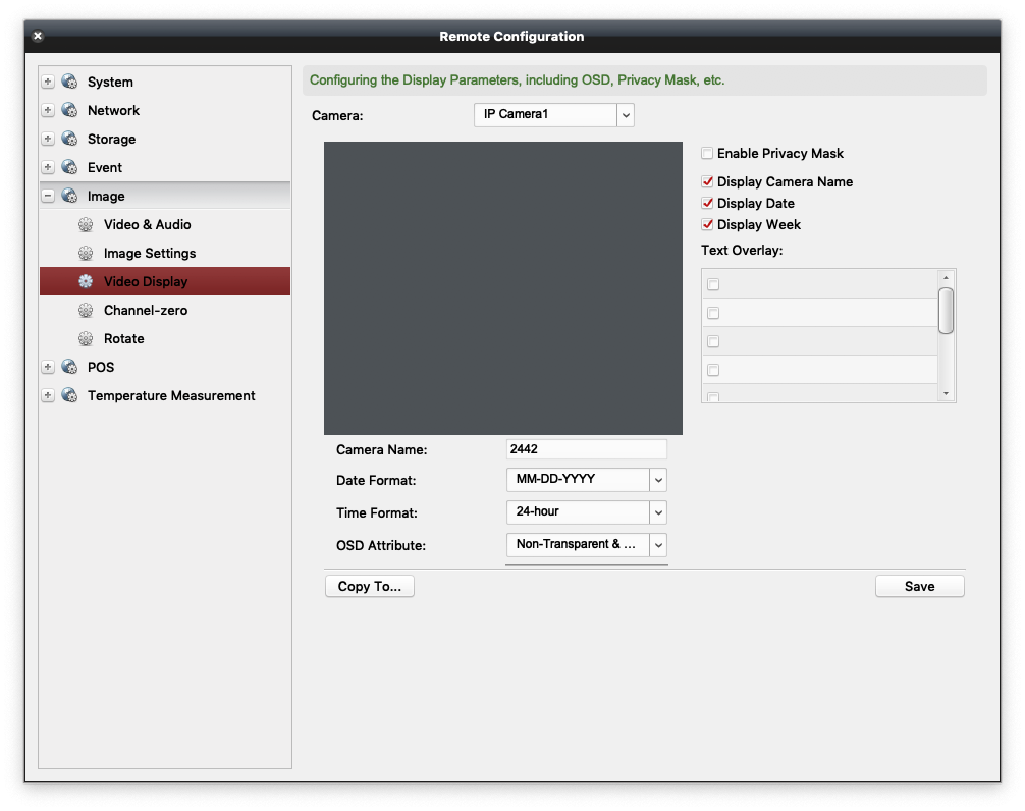

Watermarked name - to change the onscreen name of the camera you need to go to remote configuration > Image > Video Display and change the camera name

Thanks for the reply and questions. Replies...
Yes - DS-2CD2385G1-I 8MP
Attached

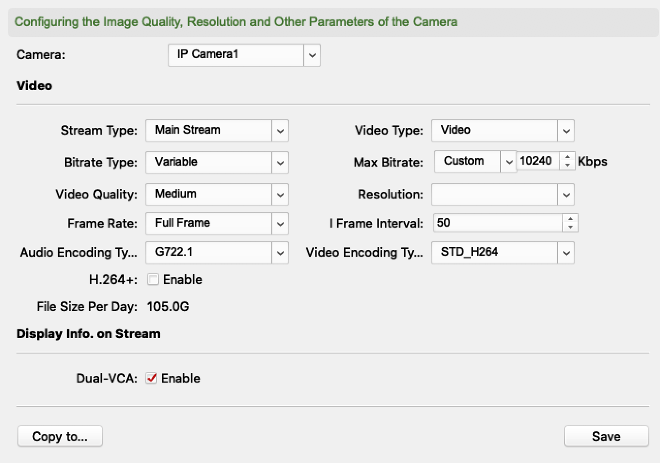

It looks like the video settings are different on those 2 models, we have seen with those 2385G1 cameras that they sometimes come with very low default bit rates which can strangle the cameras resolution output.

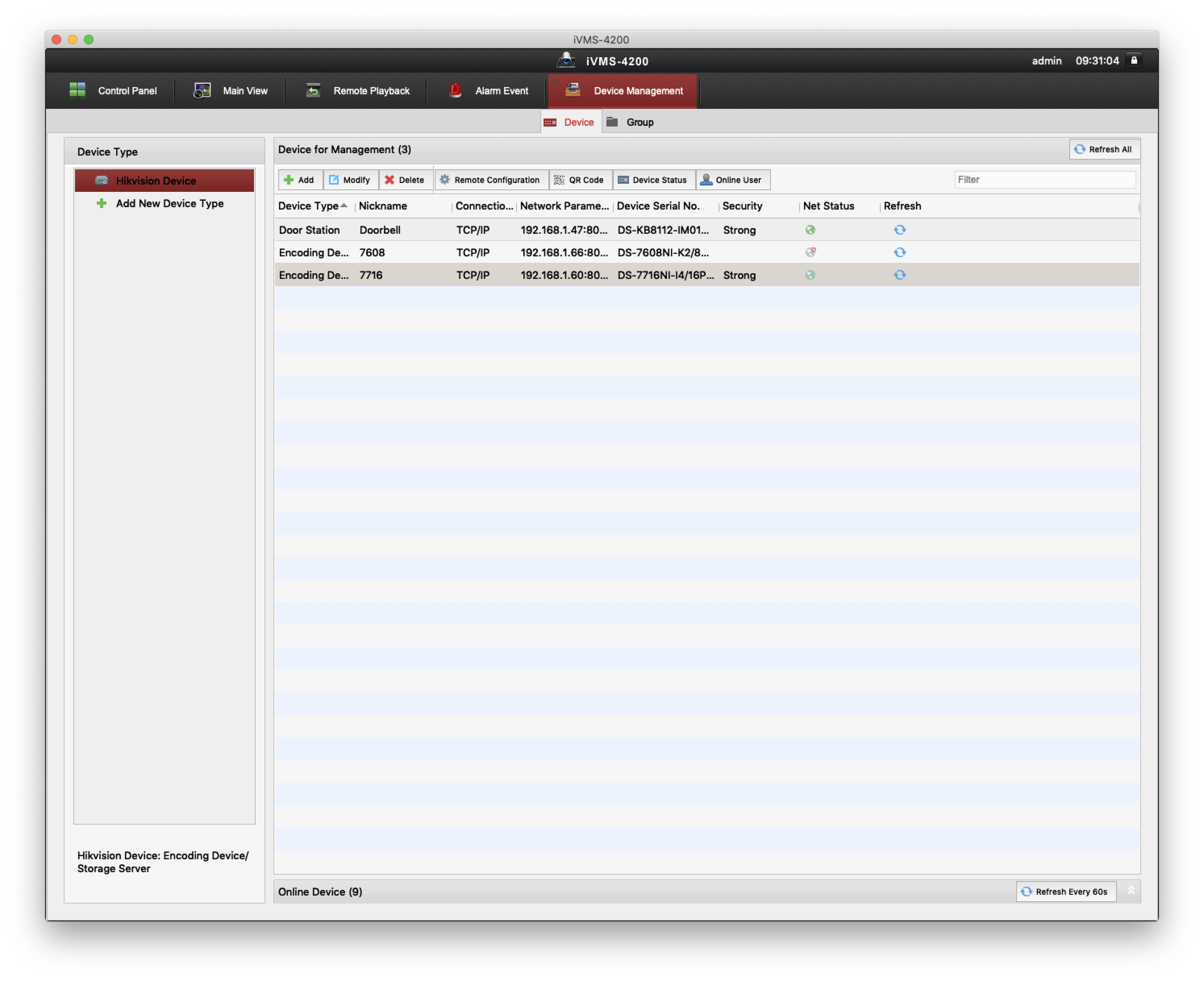

You will find the resolution and bitrate settings for each camera by going to Device Management > Select the NVR > Click Remote Configuration

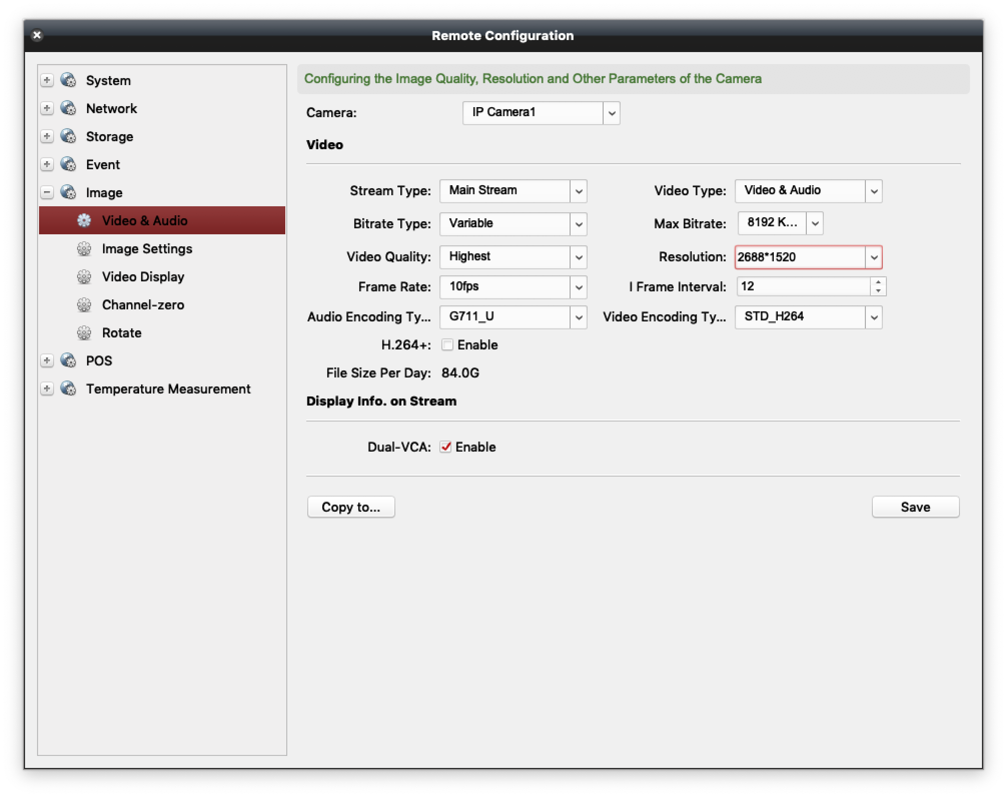

You should then see the below pop-up and will want to go to Image > Video & Audio > and then compare the video settings of the above 2 cameras and see what has been set differently.
Thanks for this. Attached is a screengrab and they're all actually the same! So i guess that because there is nothing selected in resolution there is some other setting or influence on the resolution. Worth noting the camera with the low res at night, is fine / hi res in daylight.
Before i change settings for the cameras, do i do so and copy yours, or are there other considerations i should make?
I'm still a little stuck on what changes to make to try and get the one camera up to the correct usable resolution. Anyone any ideas please?
