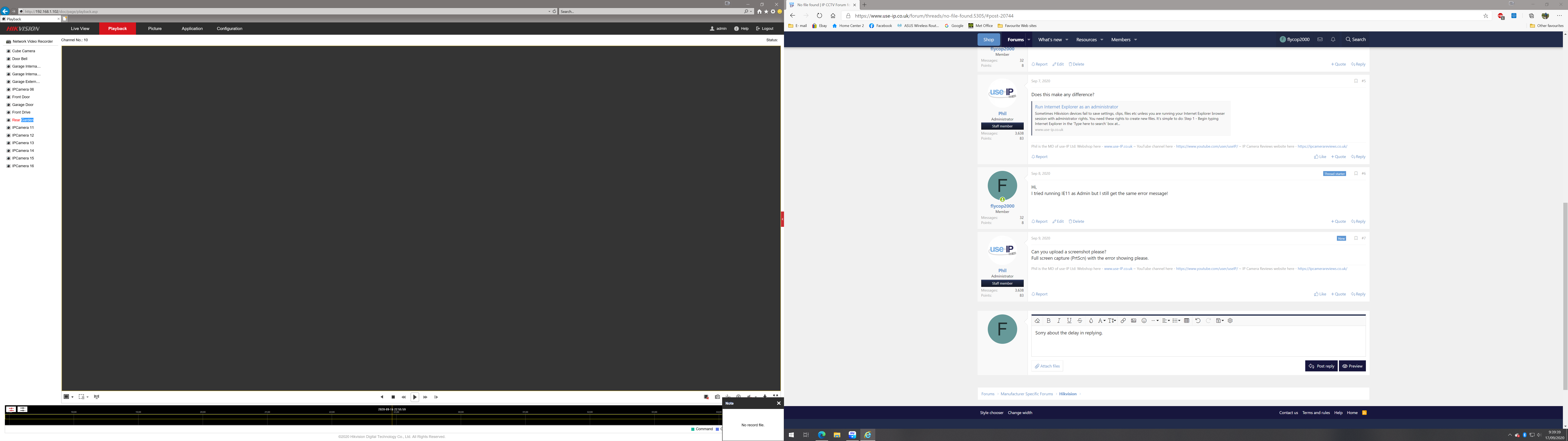

Can you upload a screenshot please?
Full screen capture (PrtScn) with the error showing please.
flycop2000
Member
37
8
Sorry about the delay in replying.

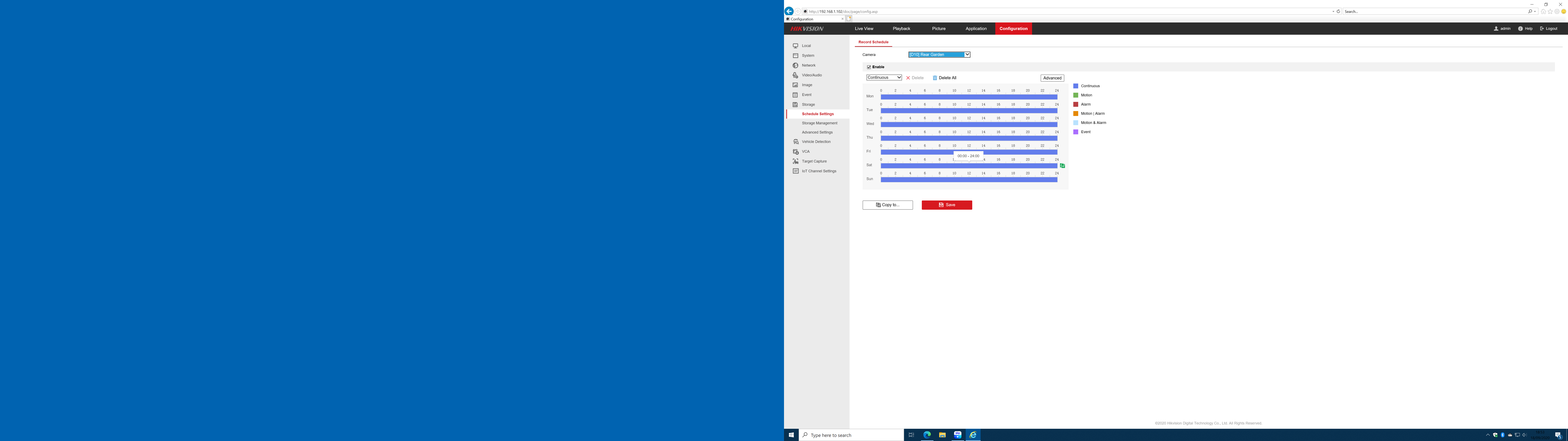

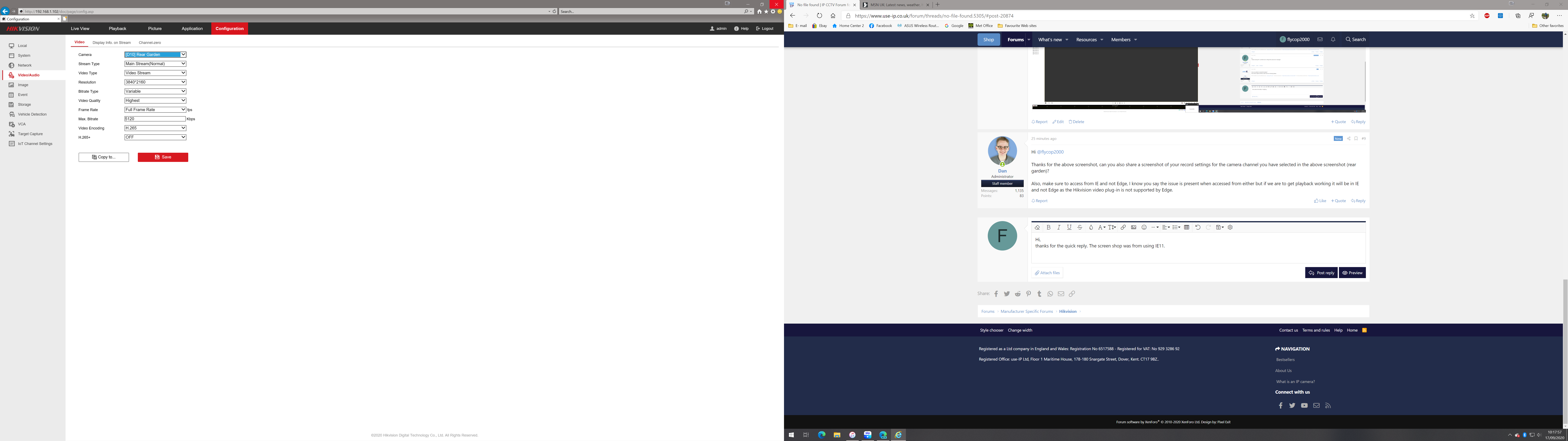

Thanks for the above screenshot, can you also share a screenshot of your record settings for the camera channel you have selected in the above screenshot (rear garden)?
Also, make sure to access from IE and not Edge, I know you say the issue is present when accessed from either but if we are to get playback working it will be in IE and not Edge as the Hikvision video plug-in is not supported by Edge.
Dan
Administrator
Staff member
1,221
83

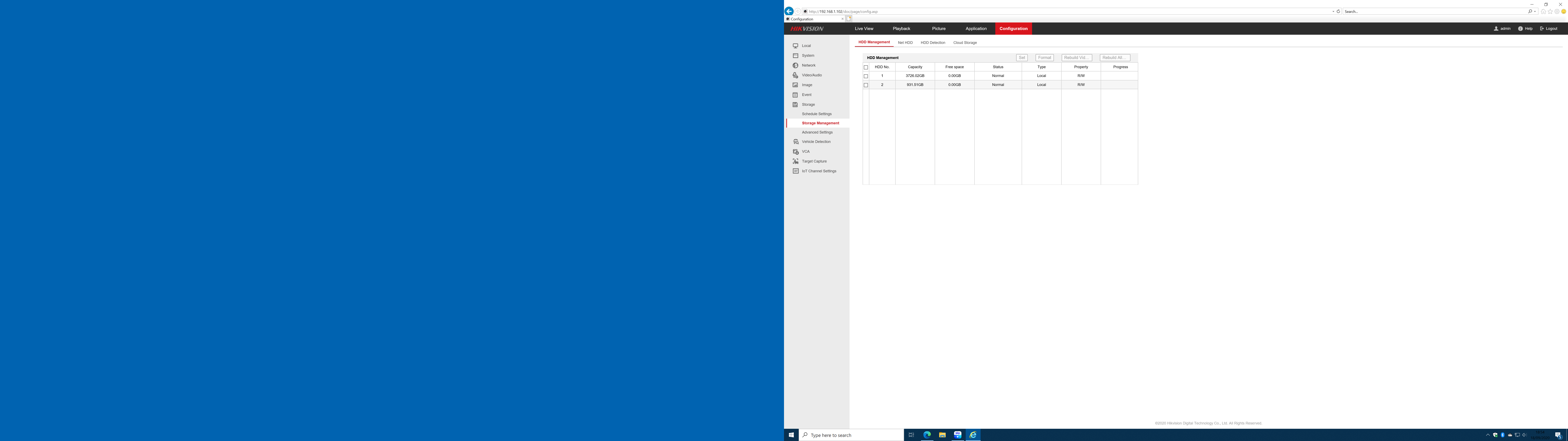

Ok, can you also share a screenshot of your record/storage schedule for this camera and the storage management menu?
Dan
Administrator
Staff member
1,221
83
Thanks @flycop2000
It looks like you will need to format your HDDs, they usually only show 0.00GB of free space if they are new HDDs which have only just been installed and never formatted, which is something you should always do after installing a new HDD.
To format both of those HDDs simply tick the boxes for each HDD on the left side of the HDD list and then click the Format button at the top of the table. Once complete the HDD free space should display as almost the full capacity of the HDDs. (e.g. the first HDD should have free space of around 3600-3700GB)

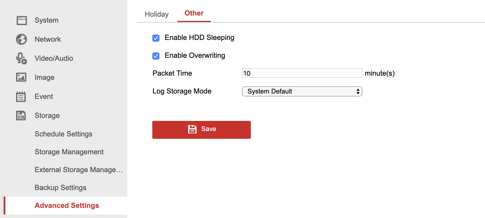

After formatting make sure to check that Overwriting has been enabled because otherwise when all the storage space has been used the cameras will stop recording, you can find the overwriting settings under the Advanced Settings of the Storage menu. (see below)
