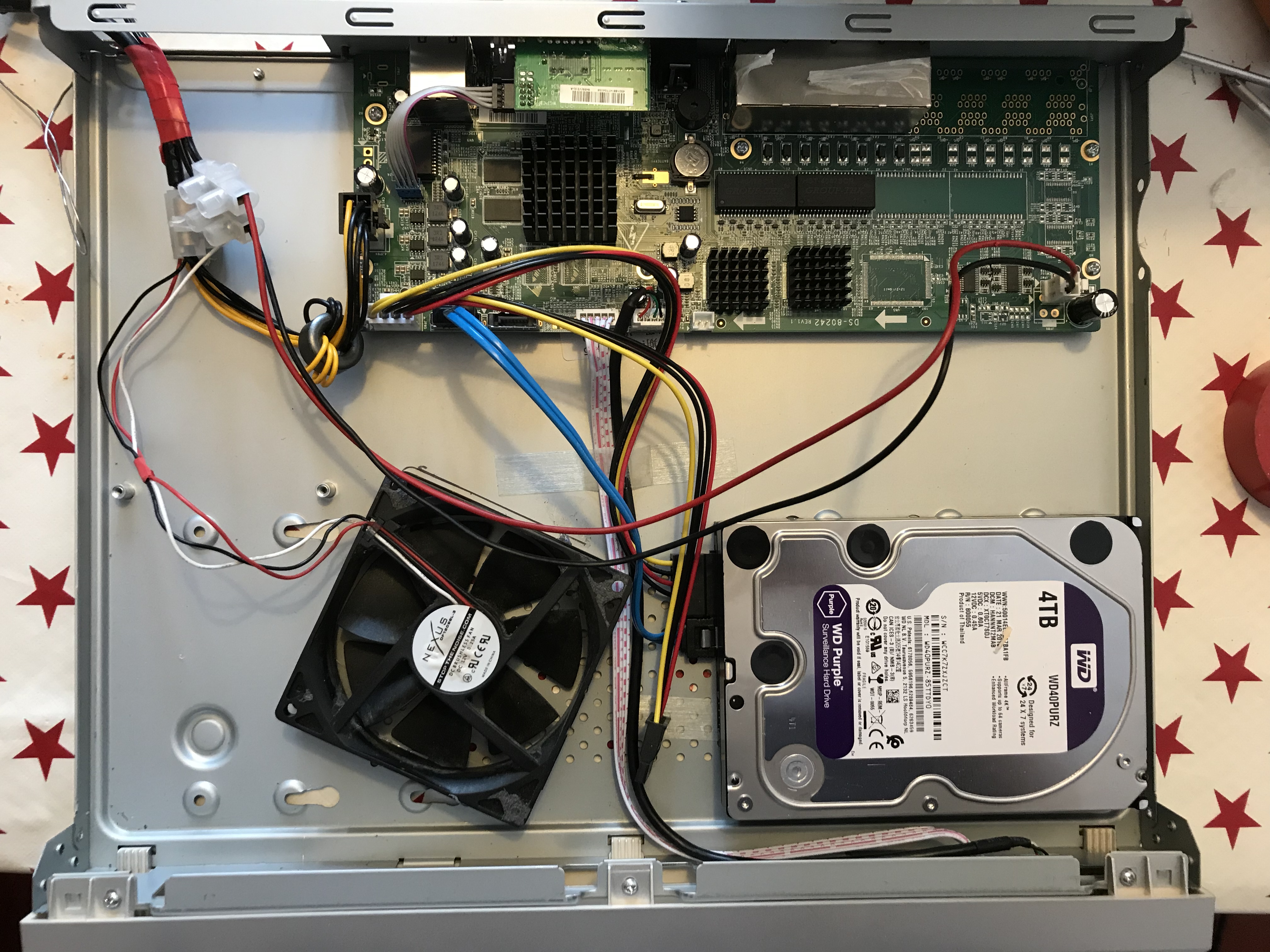

Carefully checked all the positive and negative voltages on the existing setup and the new bricks and labelled positive really carefully.
Removed the old power supply
Cut the pigtail off the old power supply, chopped the plugs off the end of the power bricks, and used chocolate block connectors to connect a to b
I wired the fan into the same 12v power rail and hot glued it to the bottom of the case where the holes are.
And then reassembled and plugged it in. Works fine (pictures enclosed)

Adding nice connectors to be able to plug and unplug the two power supplies, and closing off the old hole where the power connector is. Mine is basically wired into a cupboard so I'm not too fussed. But you can have some grasping cable entry grommits and there are screw holes around the hole to fit a plate. That would definitely be a good thing to do.
On connectors.
Originally I'd planned to get sockets for the PSU plugs so you could plug and unplug the two power supply units in, rather than having the bricks permanently attached. I didn't because the two power supplies have a similar enough plug you could very easily plug the 52V into the 12v and fry everything. It would however of been much nicer, so if I were going to do this, I'd look to replace the 52V plug with an oversize plug and socket to make it impossible to plug into the wrong one.
Hole
Cutting a hole for the fan (especially if you had a second hard drive so couldn't use the existing vents) might be good. There is lots of room when the power supply comes out to do this in either the lid or the base. There are enough holes in the base for this to work fine without if you don't need the second drive, but a nicer hole, a fan gasket and some fan mesh would be better. Cutting neat holes in aluminium isn't straight forward at home, so a fit from the outside fan mesh which covers your work is a nice thing.
Rubber Feet
The NVR has small stand-up metal feet to get the base somewhat off the surface below. So the fan does actually work fine like this, but some nice rubber feet for the NVR will improve airflow a lot and reduce noise further. I couldn't find any feet in the bit box, but will probably locate some. If you were fitting new fan meshes you'd definitely want the additional clearance.
Fan gasket
I hot glue gunned the fan down, which provides for an air tight fit over the holes, but means it's tightly coupled to the case, and the case is nasty flappy unbraced aluminium which normally contributes to a bad noise. If you can afford a nice silicon fan gasket it'll reduce the noise substantially again. They always seem very pricey to me for what they are.

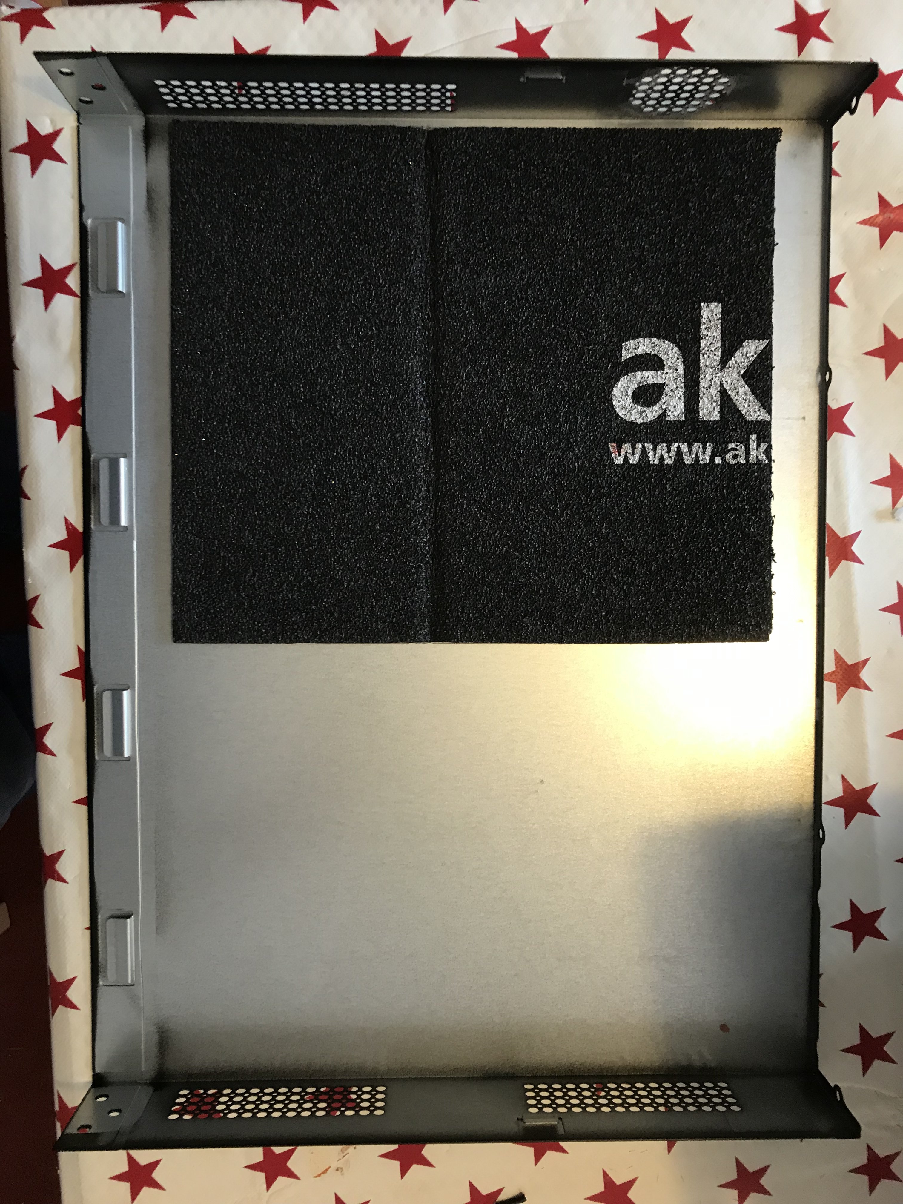

Case damping or noise adsorption material
I used a little (just what I had lying about spare) on the case above the hard drive. This stuff is always over-hyped, it's not going to make a big difference on it's own. But I do find it helps in improving the overall quality of the noise, even if the total volume is about the same. If you were going for a thorough solution I'd cover the whole of the case roof and any exposed large surfaces of the floor.

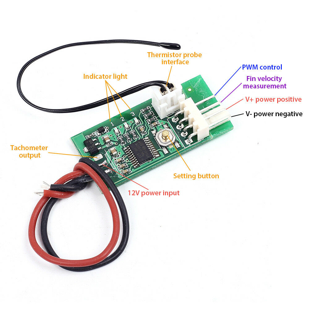

I just purchased a Hikvision DS-7732 and it is incredibly noisy. I have found 60x60x15 12v fans that perform better than the original ones and will add this programmable temperature based PWM fan speed controller. The hope is that the fan will either not spin or spin very slowly at low temperatures and only speed up if really needed. This mod should be very easy to do for both the chassis fan and the PSU fan...
Also, if I really want to gamble with warranty, I can replace the original heatsinks with much larger ones. There is lots of room in the chassis so it should be easy to find ways to make this thing more quiet. I too am planning on adding foam. I'll report back once I have made the mods. I have an audio meter so maybe I can also try to do some proper measurements of before and after... we'll see.
2574
The controller above is available from many sellers, this is just one:
https://www.ebay.com/itm/PWM-4-Wire-Fan-Temperature-Controller-Speed-Governor-for-PC-Fan-Alarm-DC-12V/333236585449\
