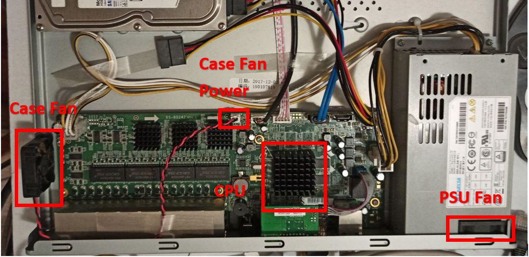

From what I see online, the DS-7608NXI-I2 8P has similar fans and layout to my DS-7616NI-K2. Is that correct?
The K2 case fans are capable of 4500rpm and in excess of 25db at full speed but I don't think they ever reach that level, even with 14 cameras attached.
Try taking the lid off the NVR to maximise airflow, see if the PSU fan relaxes a bit.
Does the NVR case fan run fairly quietly?
Is your layout similar to the following?

It is similar, I measured 56db, very noisy. The NVR is 1.5 mounth old, it was like this since arrived.
Even with the lid open has the same "volume", fan from PSU (power supply unit) is at high RPM all the time.
Evem computer PSU`s has a RPM controller and depending of the load and heat they ask for a high or low RPM.

Is there much height between the top of that small black heat sink on the CPU and the top of the case.
Knowing how amazing PC cooling has advanced over the past decade of so, it's a shame to see these excellent NVR's looking like they have cooling systems designed in the 1980's :(
I've seen the mods to cut a large hole in the case for a 100mm or so silent PC fan and that seems an excellent idea.
I wondered also if a thin profile fan could also be screwed into the fins on top of that heatsink to cool it directly?
I'd happily chop a case around myself, to get air inside the whole unit, Some Noctua perhaps?
