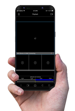

Waiting for so long, but still can’t see anything?
Or just stuck in few frames,
could not see a fluent recorded view?
Sometimes the problems caused by poor internet connection in remote playback will really drive you crazy!

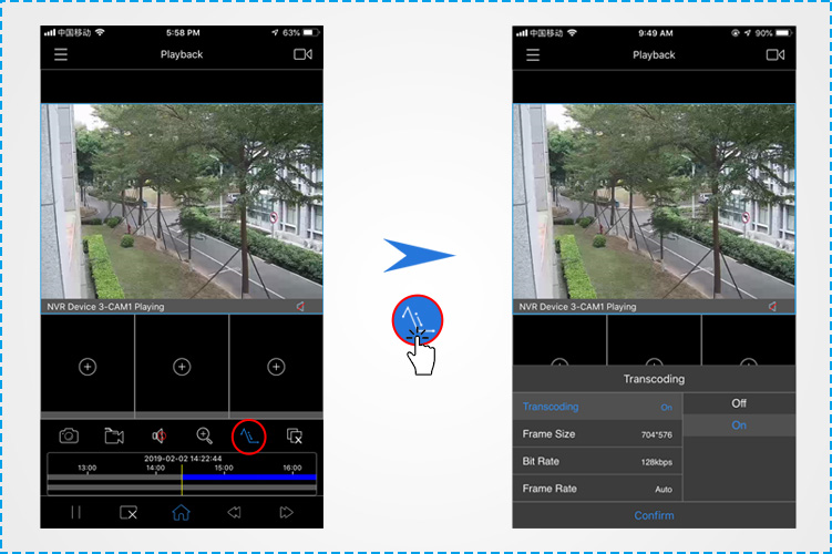

Transcoding
(For Milesight NVR models end in H)
Transcoding could be set at M-Sight Pro or NVR web page to transcode the recorded stream into a smaller one, aiming to reduce the network load and provide better playback performance. For example, when M-Sight Pro under a poor internet connection, it could play successfully in a flash by transcoding, other than fail to play the view. So transcoding is recommended to turn on before playing the view, if under a poor internet connection.

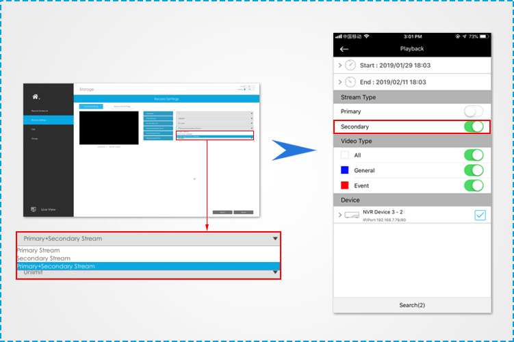

Dual Stream Recording
(For Milesight NVR models end in T)
Enable to record in Primary+Secondary Stream. In that way, you can get a quick and smooth playback just in a second with Secondary Stream for the remote viewing need and primary stream for local playback.
