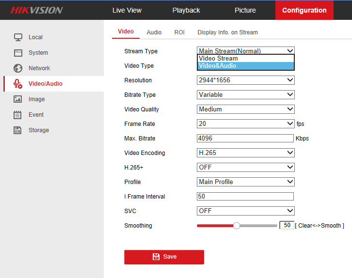

Hi Phill, i just bought the Hikvision DS-2CD2555FWD-IS this model has a built in mic when i connect it to the NVR i cant hear any sounds?

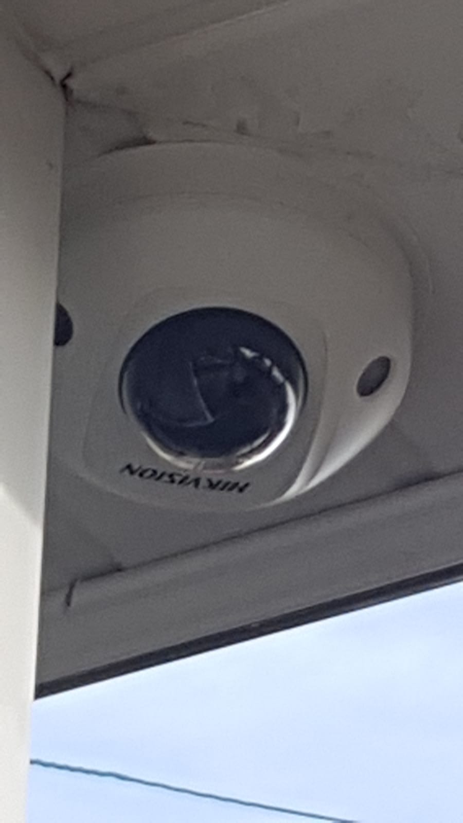

Hey I managed to open the dome camera and install it successfully. I did envision it would over more of the area. Covers the front door and the driveway.
However still no success with the sound.....when I spoke to someone from your company they did reassure me that the Mic is preinstalled and I just require an Ethernet cable. Is this the case?

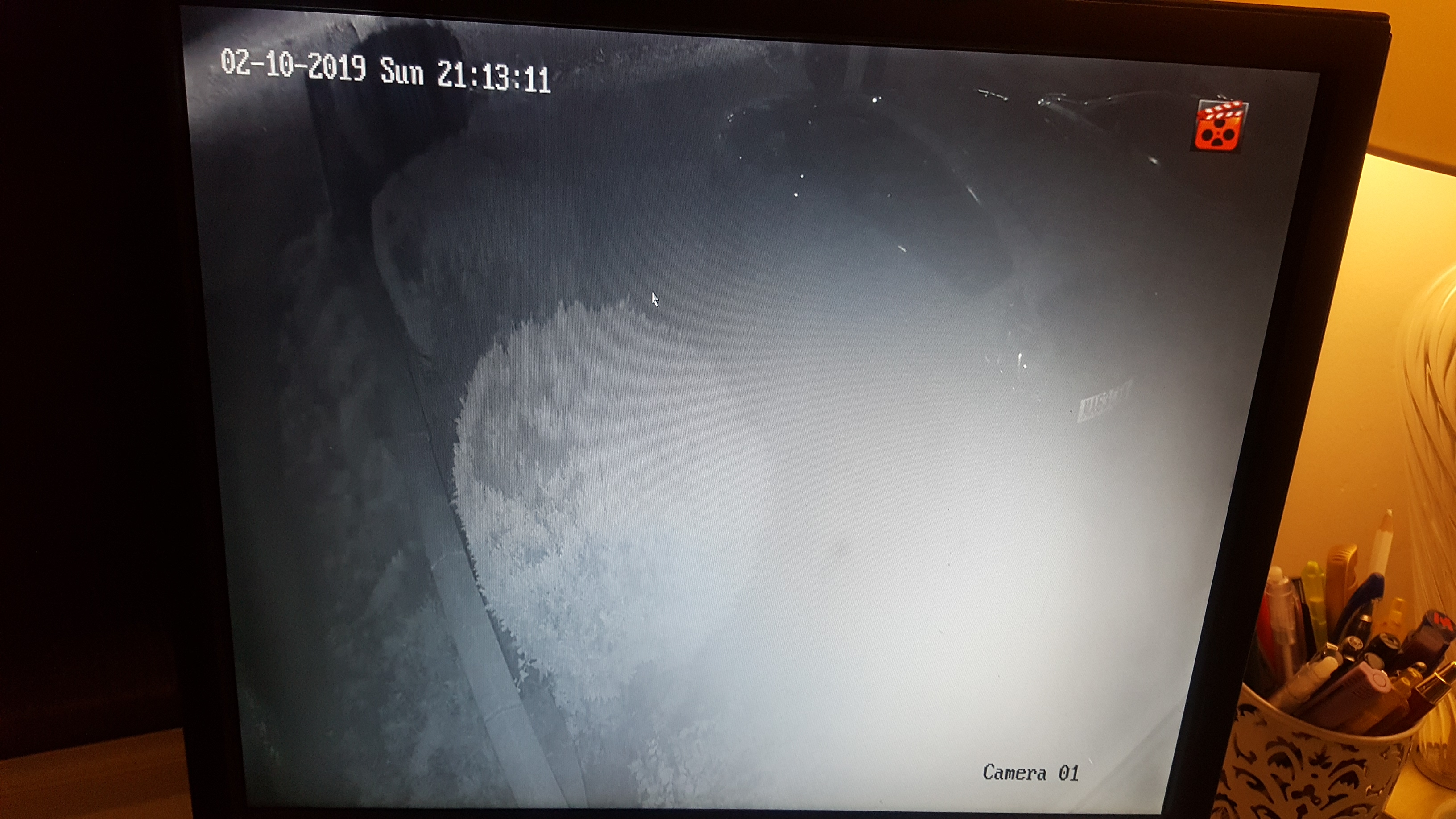

Thread starter #13
Hi Phill
The night vision is being impacted by the street light reflection on the mini dome - is there anything you can recommend? It defeats the purpose of the camera....should I have gone for the turret instead????? I think the light is reflecting on the window on to the cam....but when looking there isn't any reflection on the actual window. Is this the IR

Hi Phill
Yes, that looks like infra-red reflection.
Can you upload a photo of your camera installation please?

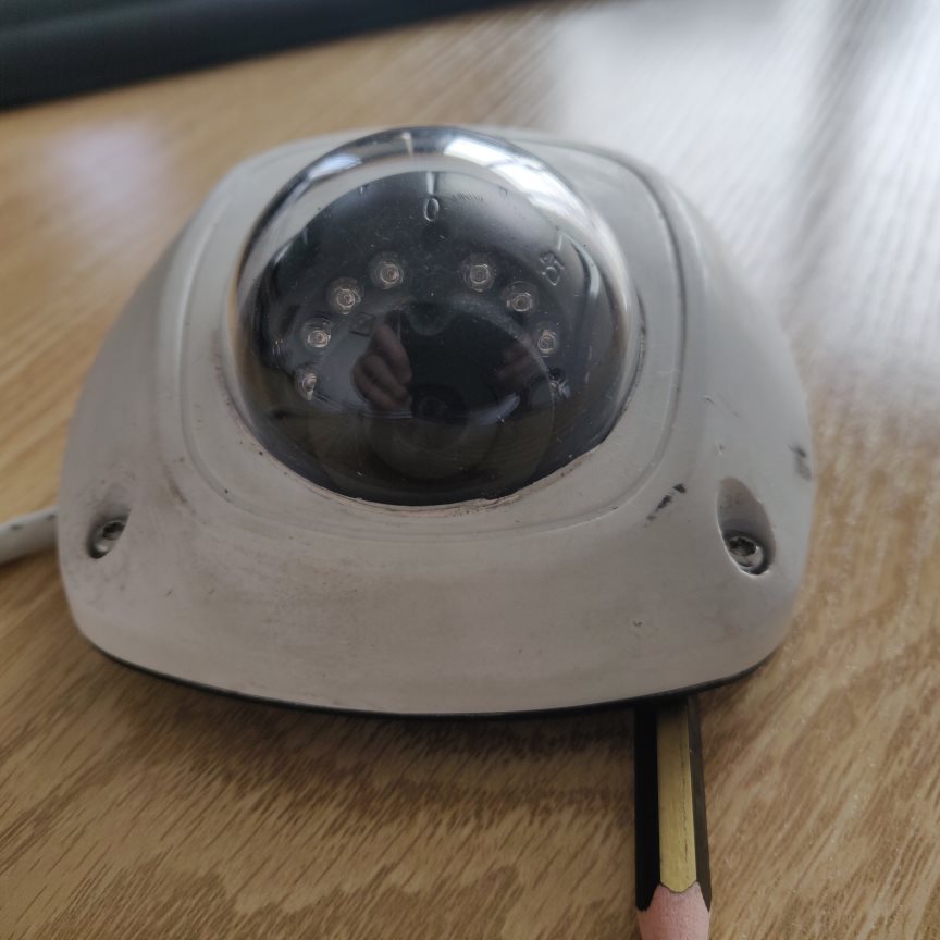

Are the IR lamps canted over back into the dome body at all?
Is the dome cover absolutely clean?
Perhaps, try it with the cover off.

#19
If you end-up with an installation configuration / mounting position where you are looking virtually horizontally through the dome, then you end-up with some of the IR LEDs being directed internally into the camera's insides:
(which causes the effect you are seeing)
This is known as internal reflection, there are a number of causes (some external too), more information here:
IR Reflection Troubleshooting Guide (blurry night image)

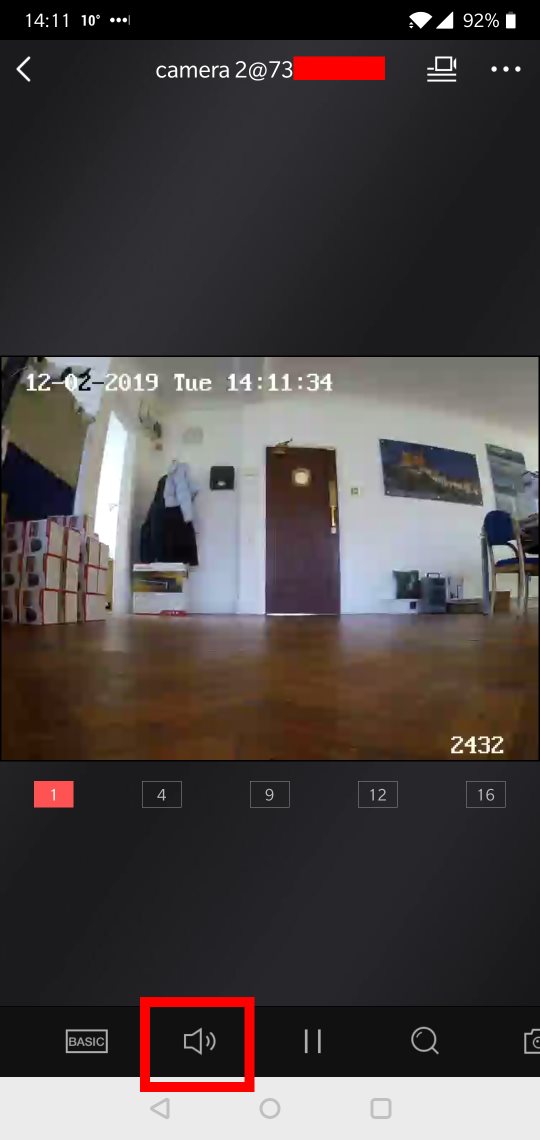

#20
Also I have enabled the video and sound. But when I use the playback functionality on the hik connect app I can't hear anything?
Have you enabled sound in the App?
I think there's a small speaker icon you need to click on.
And turn your phone's volume up fully.
