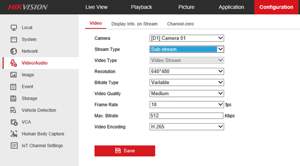

Have you set each cam's maximum resolution and bitrate for substream viewing in that cam's interface - not the NVR's interface?

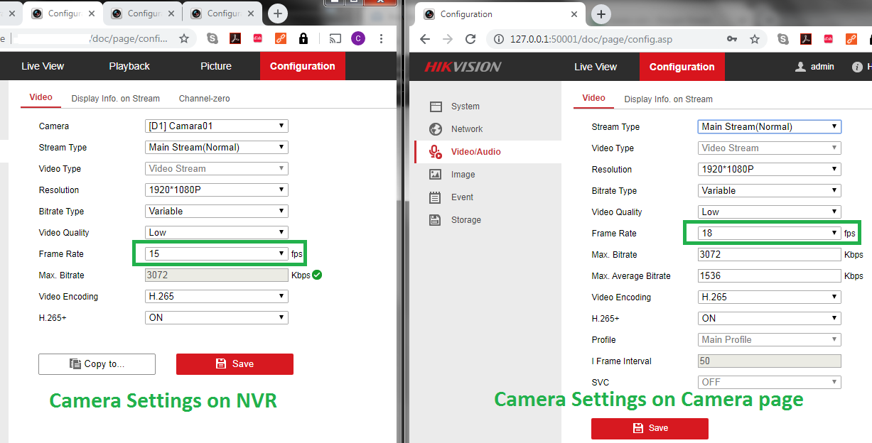

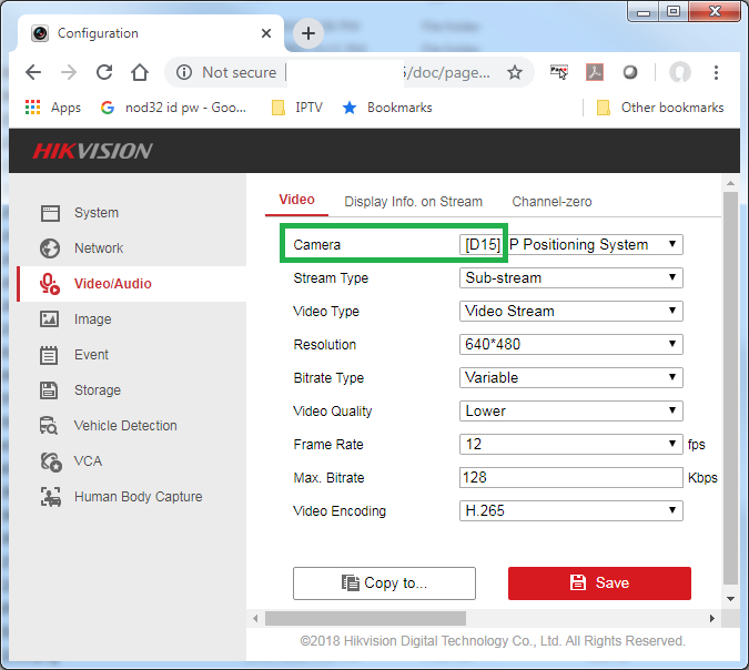

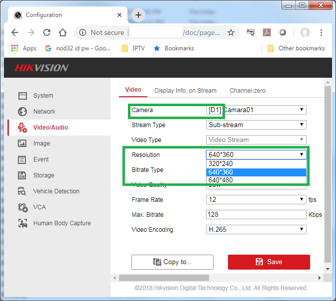

I am not at the site so it will take some port routing to get to be able to get to the cameras. It would take some doing but I can do it if necessary. It might not be. I think the NVR has the camera settings and sets them. See below. Notice how the list of supported resolutions is different between the two cameras. The NVR rejects me when I try to "copy to all" because of that one camera is different (PTZ).
Do you think it would be beneficial to dig into each camera directly?

Yes, it's been a problem. You need to set it on each cam's individual page, not the NVR page. Then it will be "accepted" by the NVR. Can't tell you why, but it's how it works. Let us know.

You were right.
I managed to get my streams into to VNC using the rtsp urls. I could see the actual bitrates and frame rates. In the NVR menu, I had set all the cameras to 12 FPS. VNC reports 30 FPS.
I had to get into the cameras' pages remotely since I'm not on site. I managed to SSH into the NVR. Then I setup a SSH tunnel to the NVR that directed traffic to port 80 on the cameras pages.
Finally in the camera pages, I see what you mean. The settings were not the same. I fixed them all one by one. By knowing this and having a route into the cameras' pages I will be able to optimize the video quality. Also, there are more settings. Before this, nothing made sense when I'd tweak the settings.

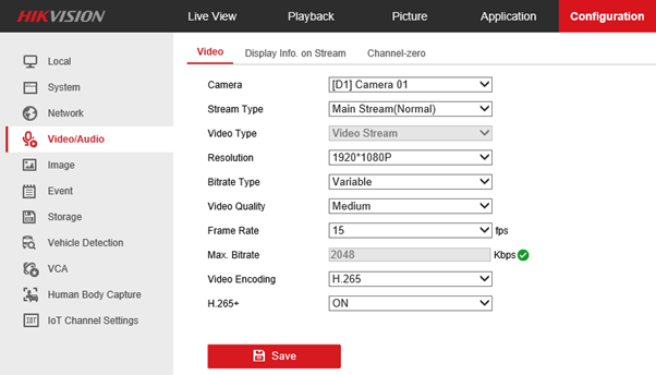

Match the settings of the Main Stream on the cameras and NVR. Since you won’t be using the Main Stream for remote viewing you can set this to at least Full HD.

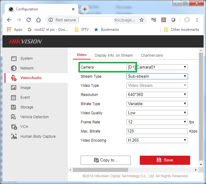

Set the NVR and camera sub-streams to match. Keep the settings to a conservative level similar to:

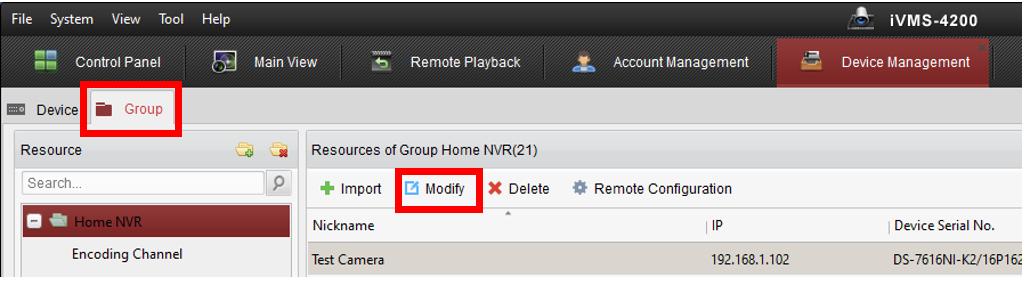

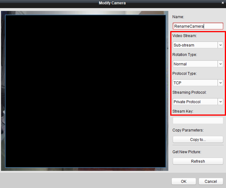

Assuming you have installed iVMS-4200 and have added the NVR, navigate to the Group tab in Device Management. Highlight a camera (you'll have to do it for each one) and click the Modify option.
Here you can set the Video Stream type to Sub-stream. TCP and Private protocol are fine as is.

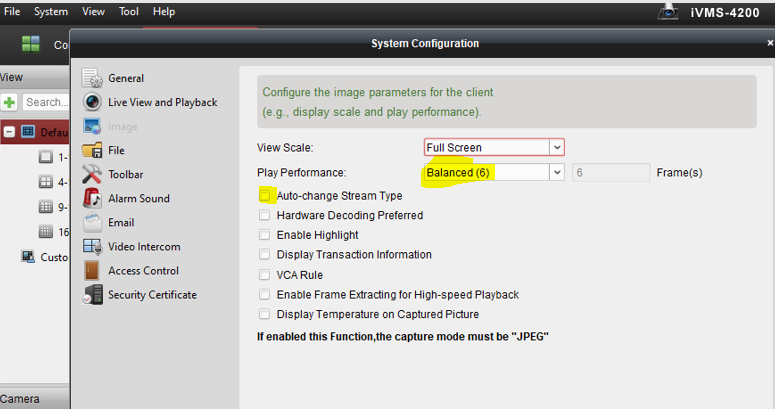

In Tool>System Configuration>Image un-tick Auto-change Stream Type. Set Play Performance to Balanced.

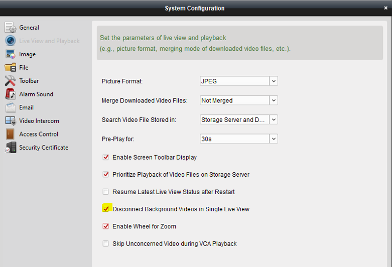

On the Live View and Playback tab make sure Disconnect Background Videos... is ticked.
Save the changes and navigate to the Main View tab.

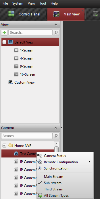

Right click each camera and select the Sub-Stream. This ensures only the the sub-stream loads for live streaming.

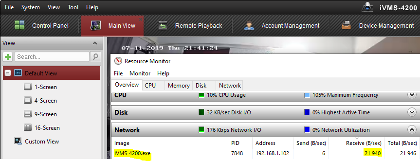

Provided there isn't too much motion/scene complexity you should be able to get a single camera stream under the 50KB/sec mark.
