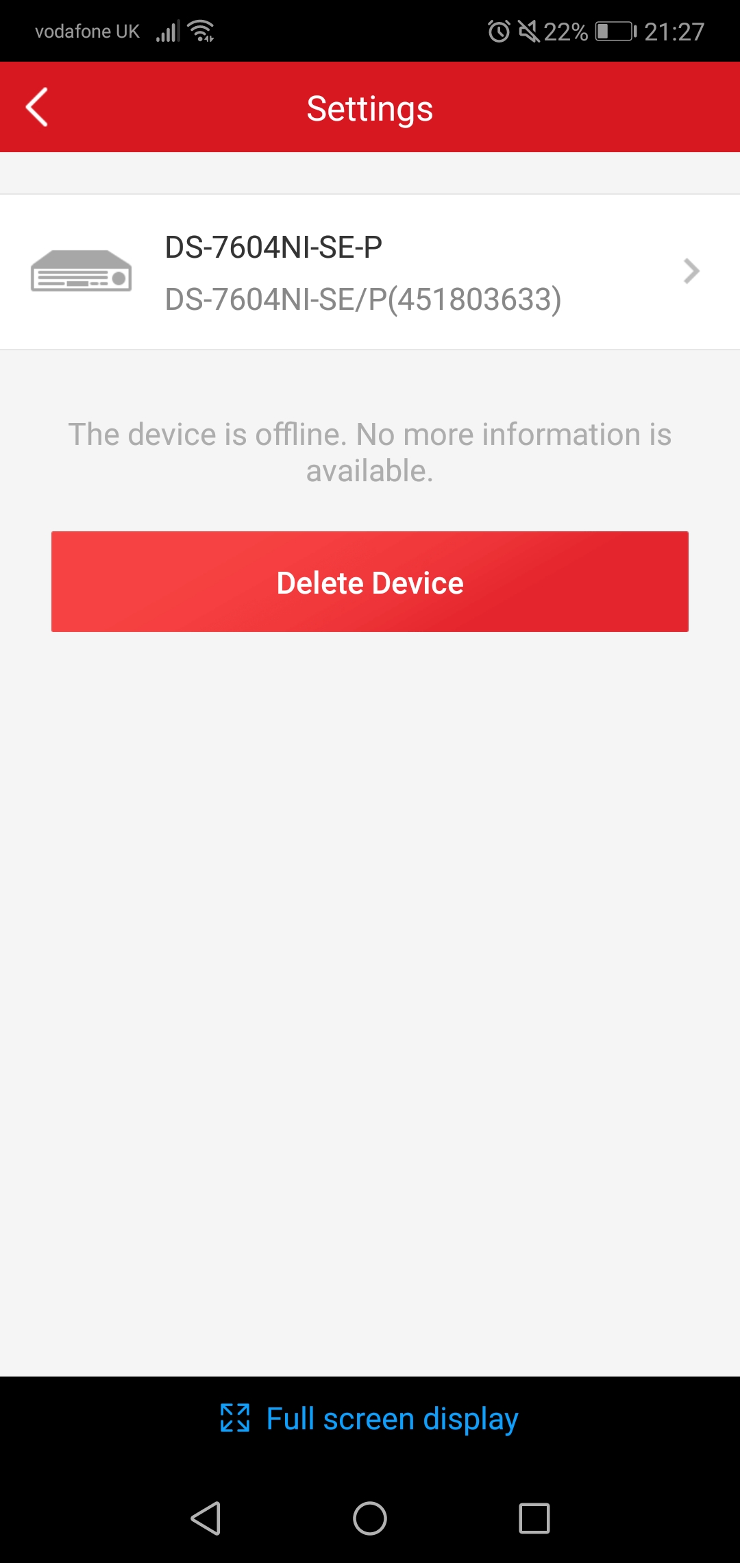

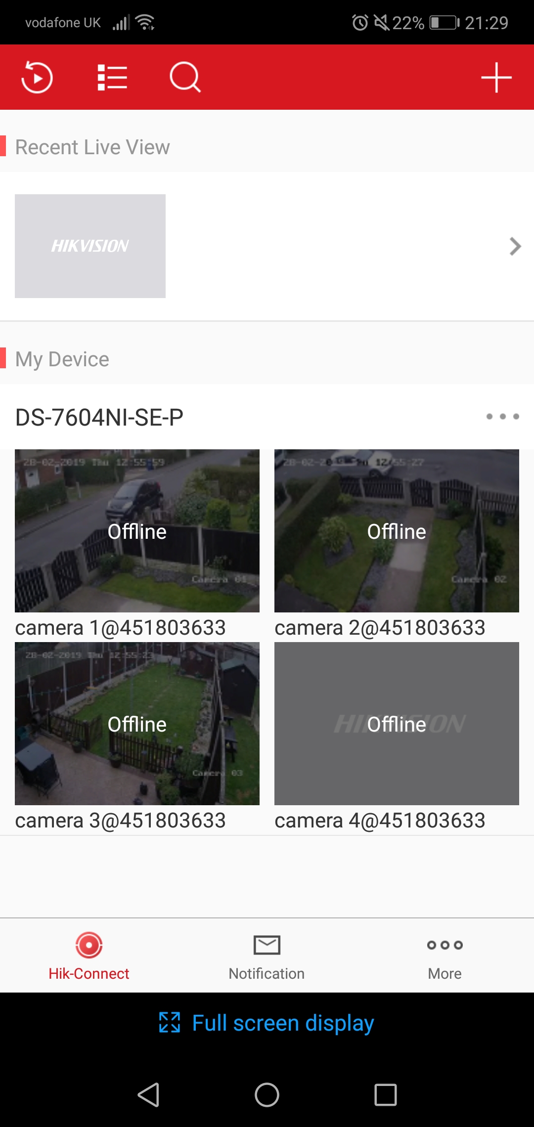

Hi my hikvision app is showing offline can you please help thanks jasin

Is your NVR still accessible on your Local Area Network?
e.g. can you still browse to it?

Can log into just come up with offline think I might have had a hik connect update and not been able to view on my phone

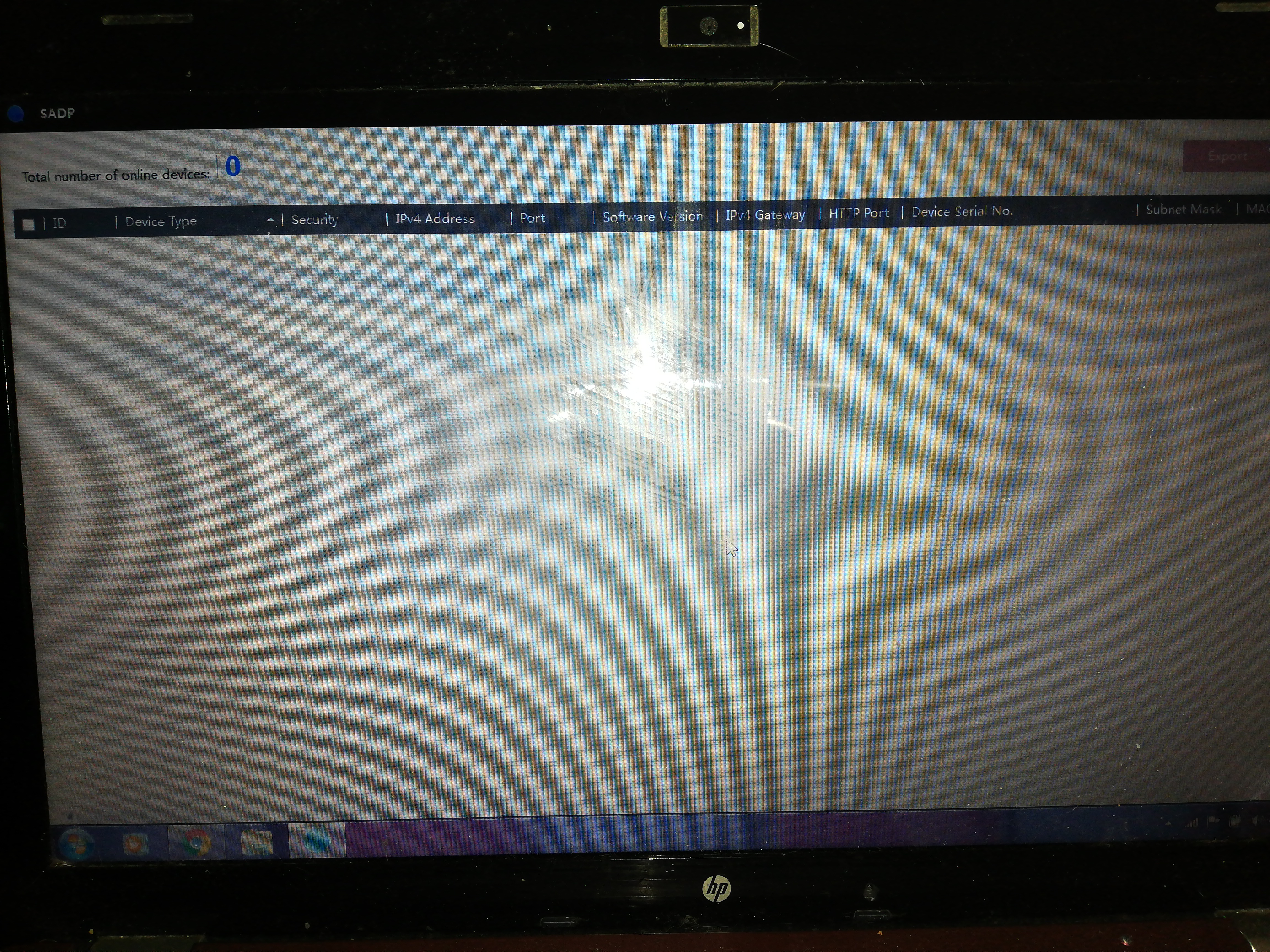

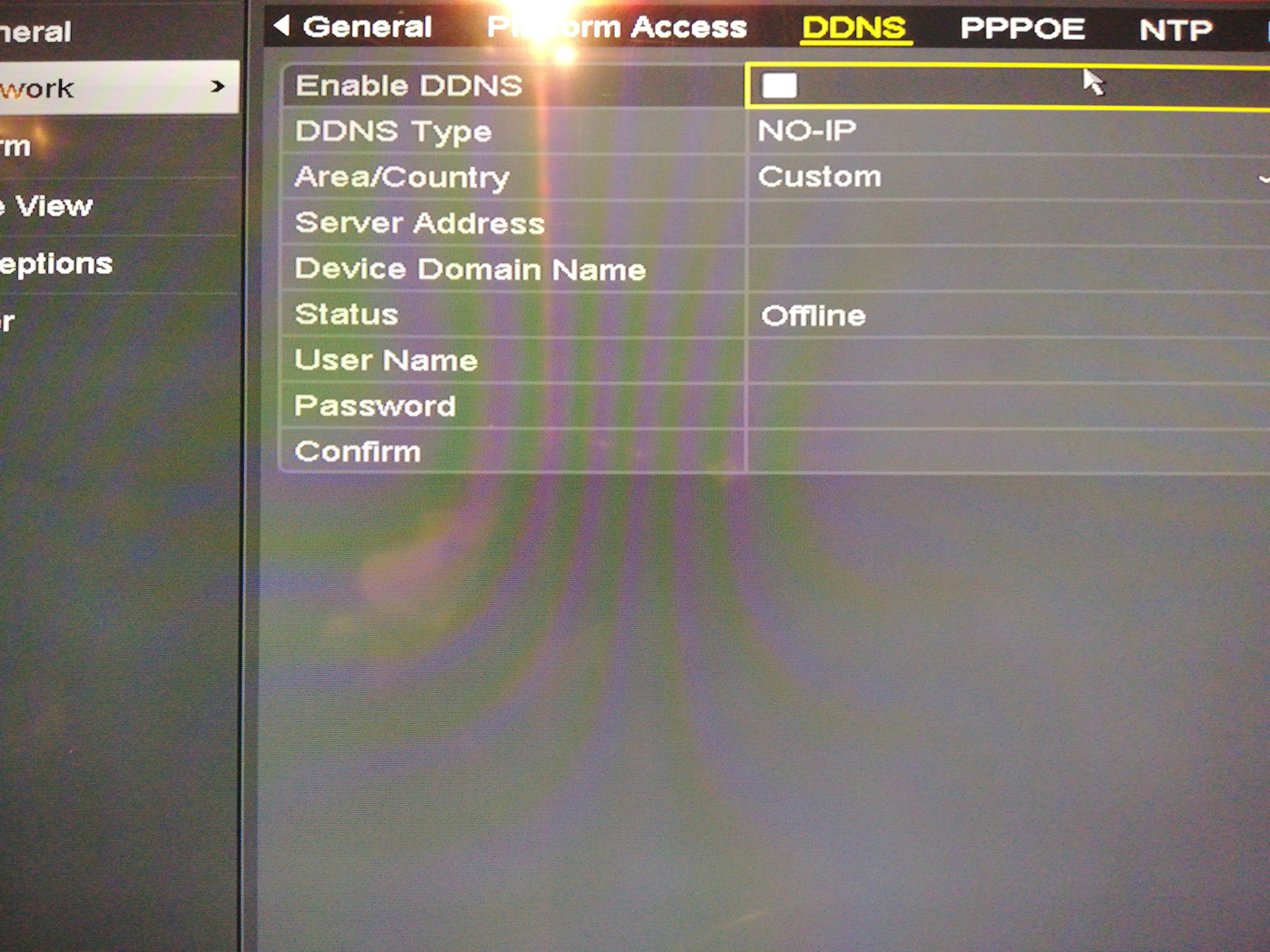

If you run Hikvision's SADP utility on your PC what does that show please?

I will try a new cable when I get in tonight cheers

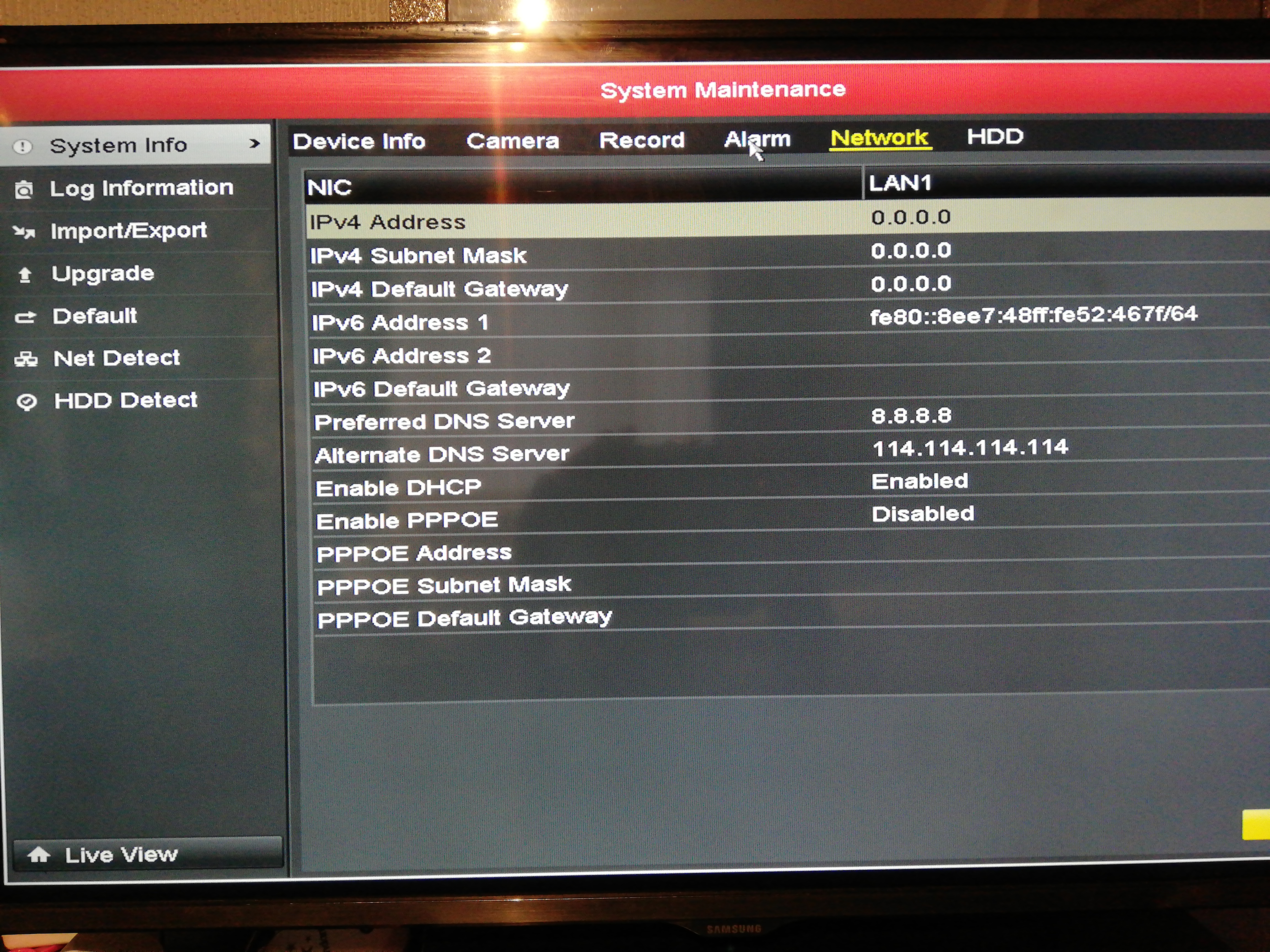

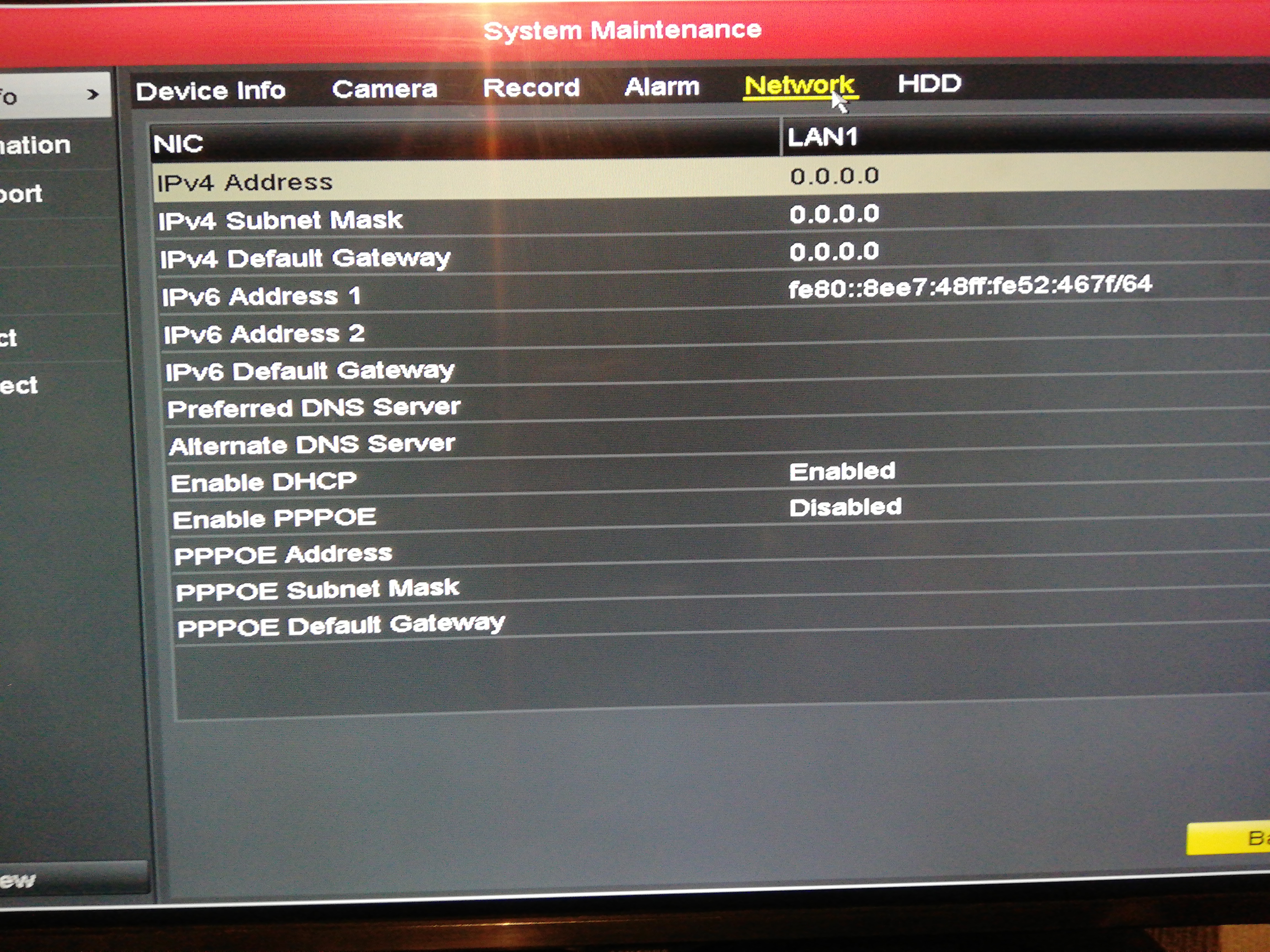

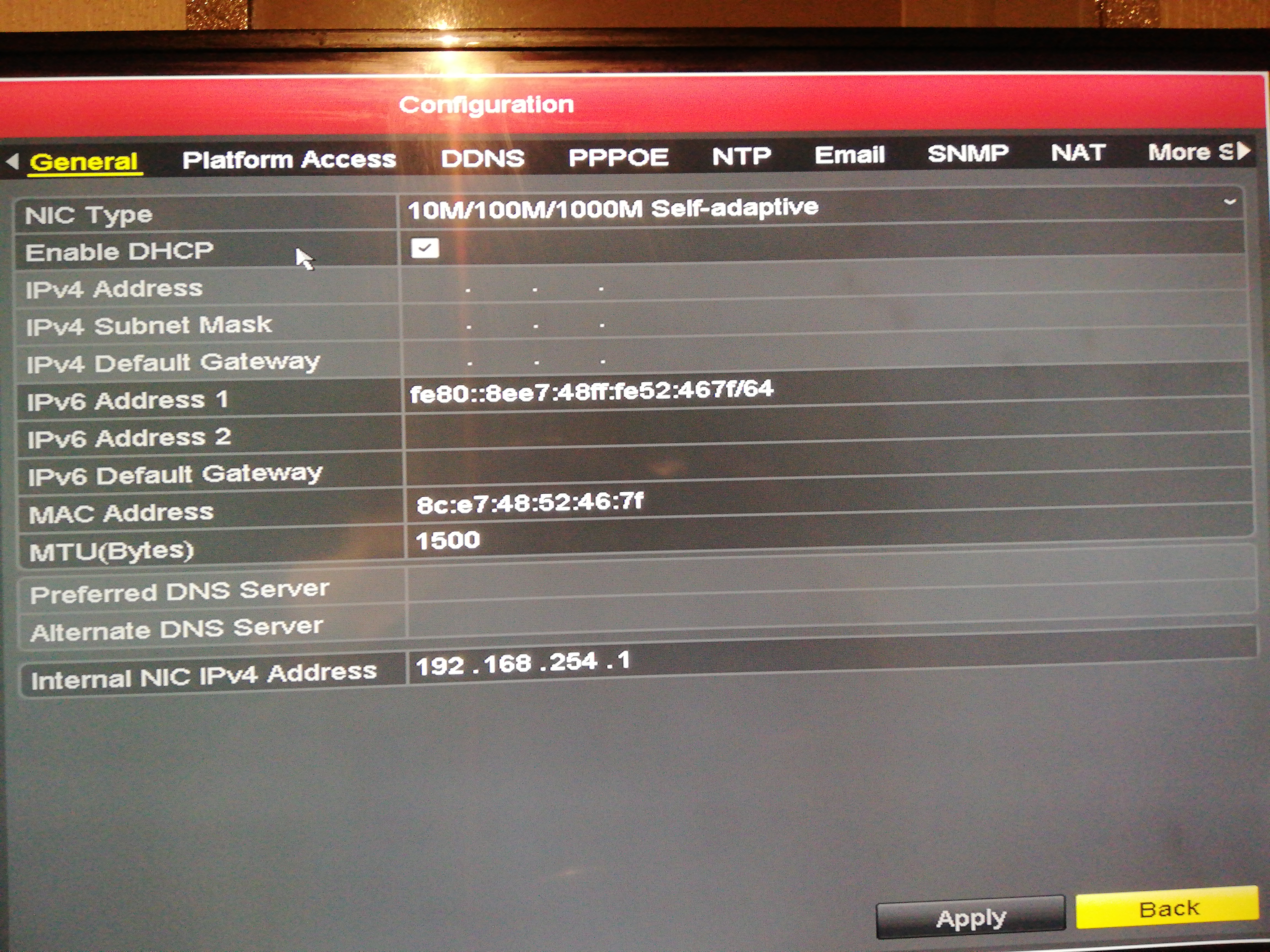

You have no network settings entered - they are all zeros.
Therefore your NVR is not connected to your network.
You will not therefore be able to access it.
I could guide you through setup, but:
SADP should still find your NVR and report it - IF it is actually network connected to your router.
As SADP is not showing anything, I suspect that your NVR is no longer actually on your network.
What started these problems please?
e.g. have you changed your router?
