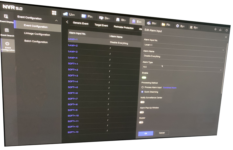

Moving on...... in GUI 5.0 it appears the one key disarming has been renamed to "Quick Disarming". Of course, no explanation by HIK as to WHY. Again, I have not attempted to use or configure the Quick Disarming function. Does it work ? Probably, but I really don't know what defects might be lurking in HIK firmware. :)
The "alarm in" relay in my DS-7616NI-M2 certainly does function, as I have previously tested that.

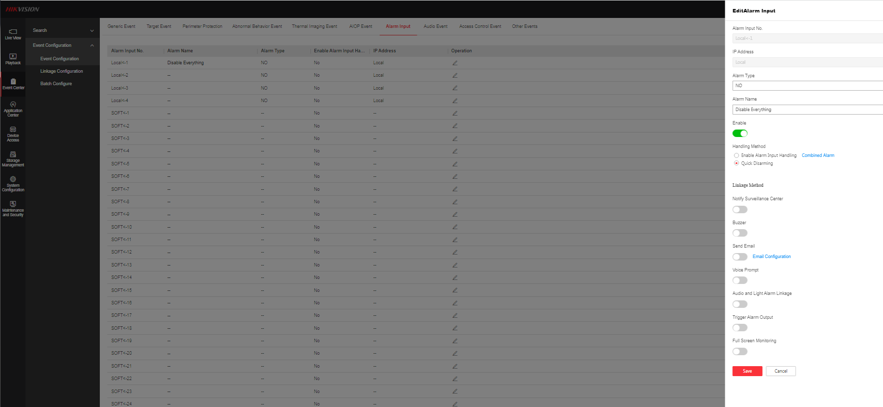

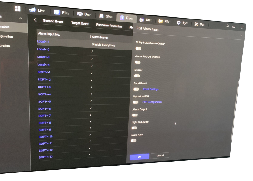

At Firmware Version V5.04.081 build 260112 --> Attached are some screen shots, from the NVR UI and from the WEB UI. If you zoom in, you'll notice there are minor differences in the selection boxes to disable various linkages.

So from the screen you posted with gui5 on your M-series there is the one key disarming or the newest quick disarming
Thanks to confirm that. Of course I assume it works as I don't have element to think differently
The important things is that the feature is available on the M-series
