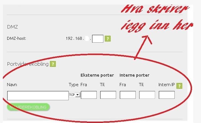

I am stucked with this. I have fiber network from the countrys largest provider and the "housecentral" is set as bridge before the asus wifi router.
The provider has a way to open ports - like this
Where I can open ports - ex. Camera, tcp, 80, 80 and intern ip 192.68.10.94, but when I use the open port check tool Open Port Check Tool it is locked on the extern ip 109.247.xxx.xx
My question is - will the opened port on the intern ip work all right when I later shall do the setup on the camera and on HIKconnect? Or must port be opened on the extern ip?
Thanks again, Phil.
