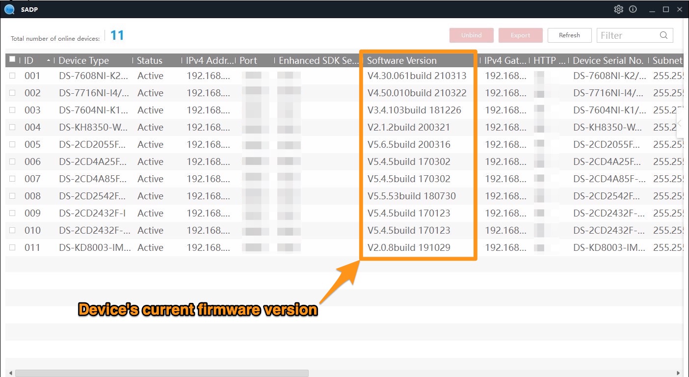

Using SADP:
NB – This will not work for any device that is directly connected to an NVR’s PoE ports, or if you have a partitioned network setup.
Install the SADP Tool on your computer, and run it while the computer is connected to the same LAN / network as the Hikvision device.
This will scan your network for all the Hikvision devices connected to is, and show their network information, you should see a table similar to the one below.
The current firmware version of a device is shown in the 8th column on its row under the heading "Software Version".

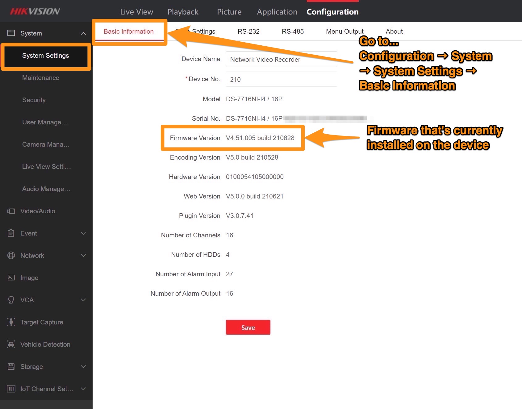

Open a web browser (Internet Explorer tends to work best on older devices), and log into the device by either using its IP address or virtual host links if it’s directly connected to an NVR.
Now, click on the "Configuration" tab at the top, which should take you straight to the device’s "Basic Information" page – this can also be found by following the path:
Configuration → System → System Settings → Basic Information
Your current firmware version is shown in the 5th row:

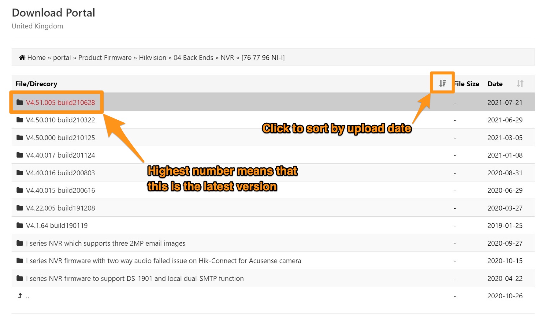

Click on your device type from the list on this page - “Back Ends” here refers to NVRs and “Front Ends” refers to the majority of cameras.
Then, select the platform that your device is from. For instance, to find the firmware of an I-Series NVR, such as the DS-7608NI-I2-8P, then you’ll need to follow the path:
Back Ends → NVR → [76 77 96 NI-I]
You’ll then be shown the range of firmware versions for that device. To find the latest, just look for the largest number - using the sorting icon marked below can help as it will chronologically arrange the firmware date.
Note - Be cautious if using the sorting icon - it will not always put the latest version at the top, as Hikvision sometimes reuploads older firmware.
In this case, the newest version is "V4.50.010 build210332":

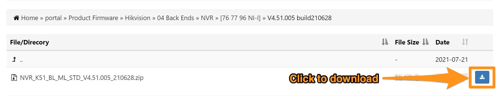

Once you click on the link, you’ll be taken to a page that usually has both the release notes as a PDF file, as well as a ZIP file, which will contain the firmware itself.
Note – As well as explaining the purpose of / improvements made with the specific firmware version, the release notes will also list all of the devices to which that firmware applies to. It is always worth checking that your device’s model number appears here to confirm that you are about to download the correct firmware file if you have any doubts.

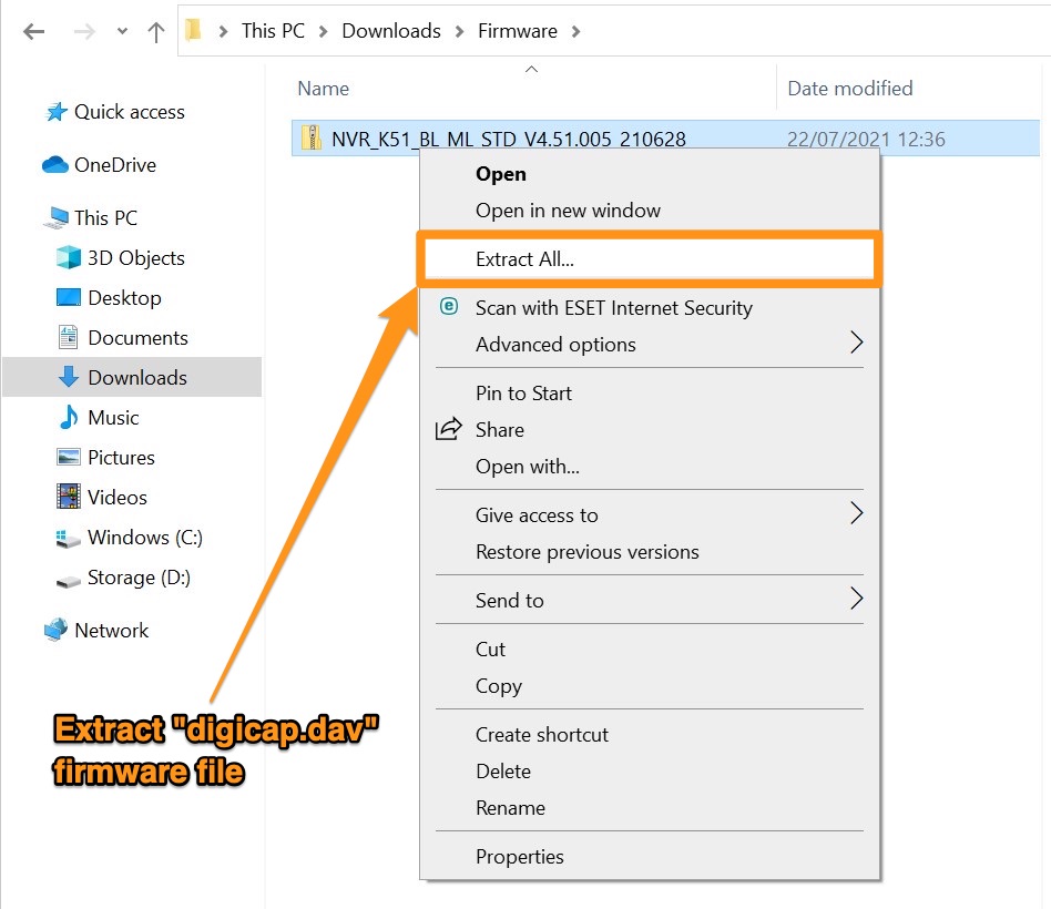

Now, download the ZIP file to your PC:

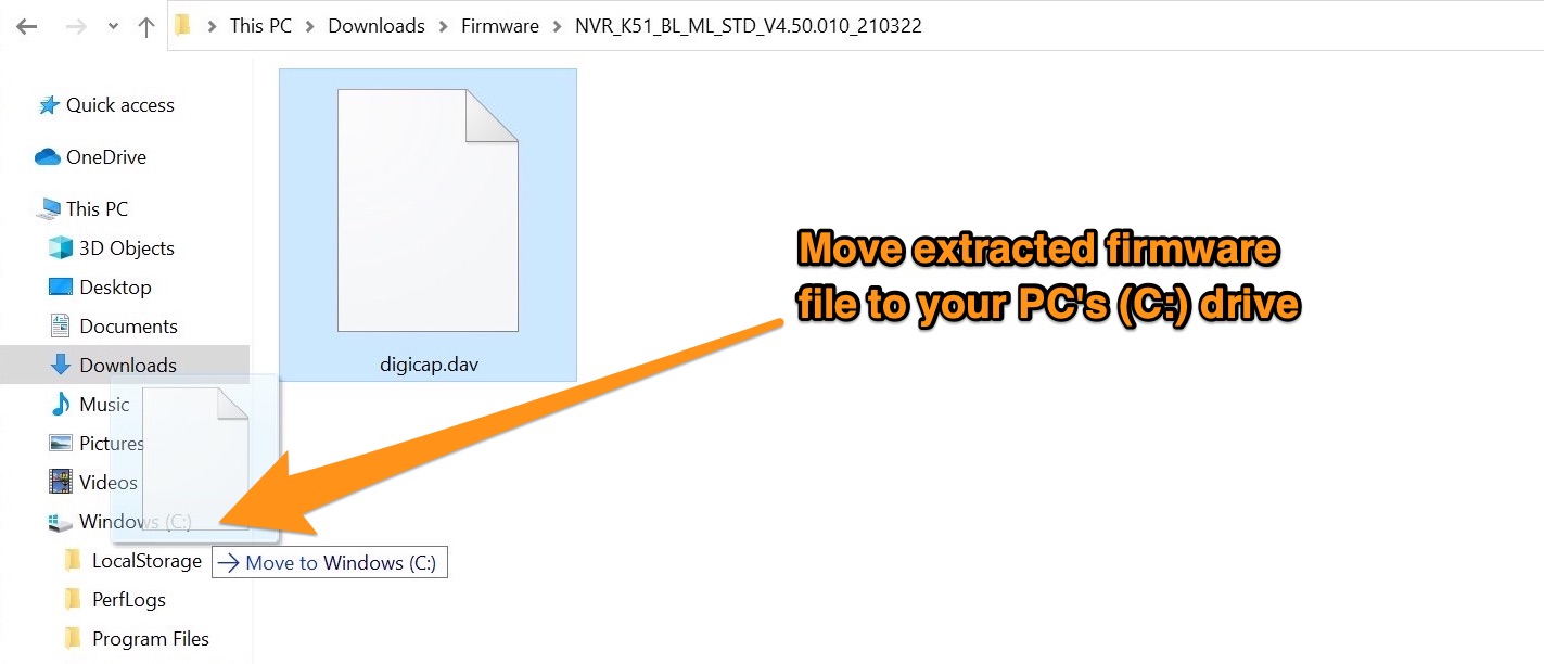

Extract the "digicap.dav" file from it, and copy this to your computer's C: drive.
You'll be asked to either enter an administrator password or to click continue to confirm that you want to move the file here. Do whichever applies - it's safe to move your firmware file to this folder:

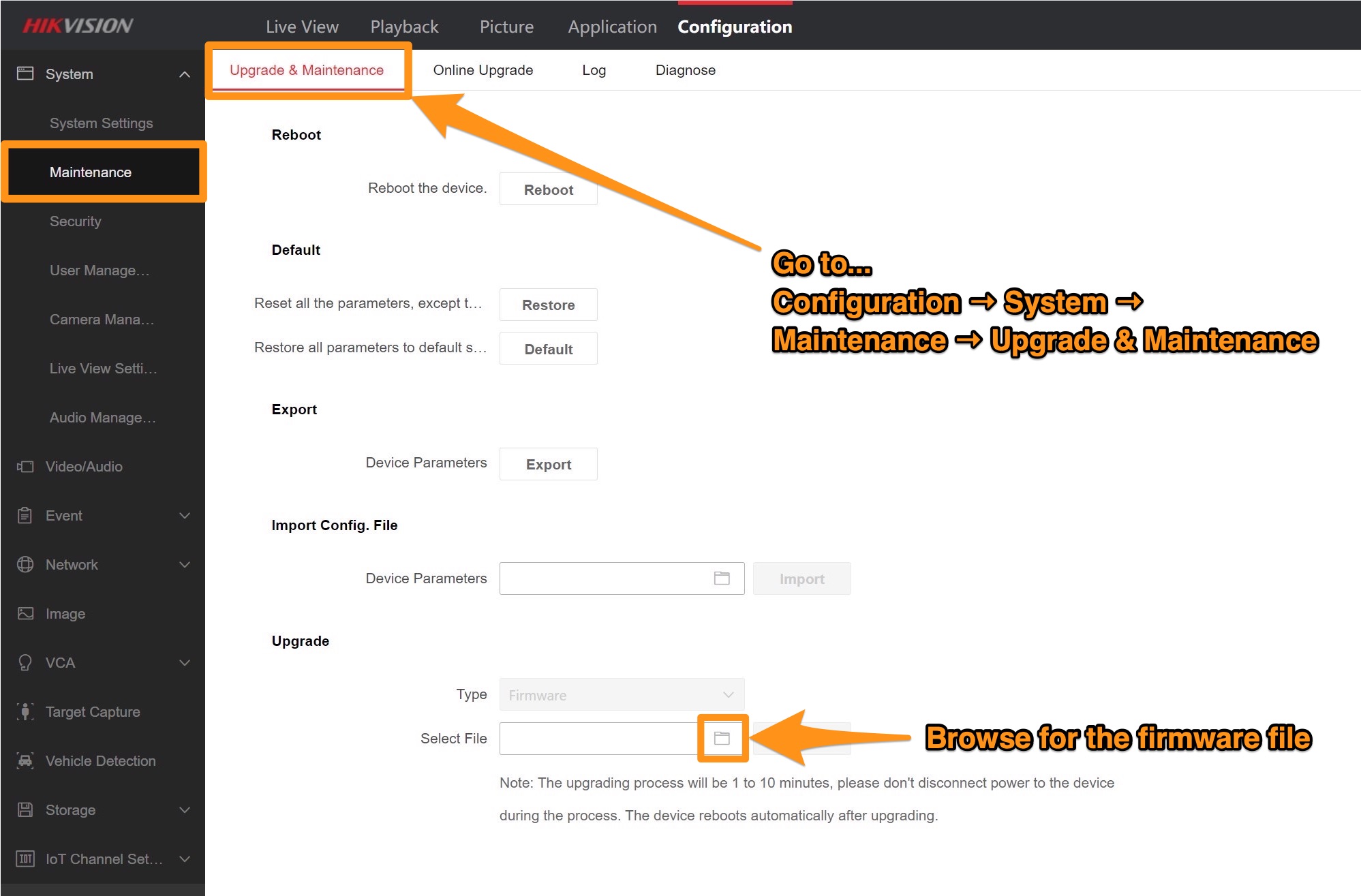

Log into your device again in a web browser, and go to:
Configuration → Maintenance → Upgrade & Maintenance

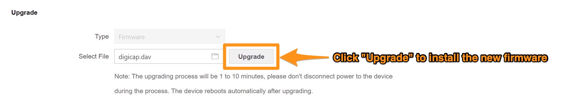

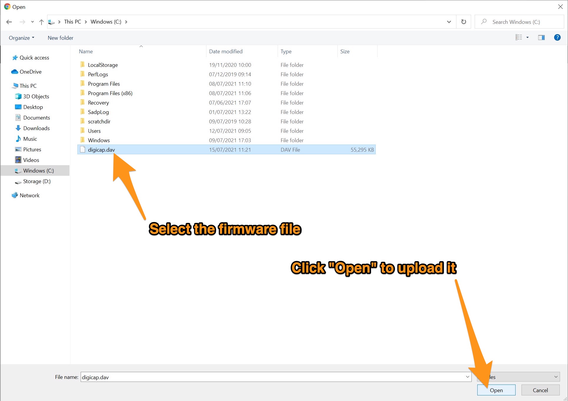

You’ll see an "Upgrade" tab at the bottom of the page, click "Browse" here:
Select the "digicap.dav" saved in your root folder from Step 2, and then click "Open":

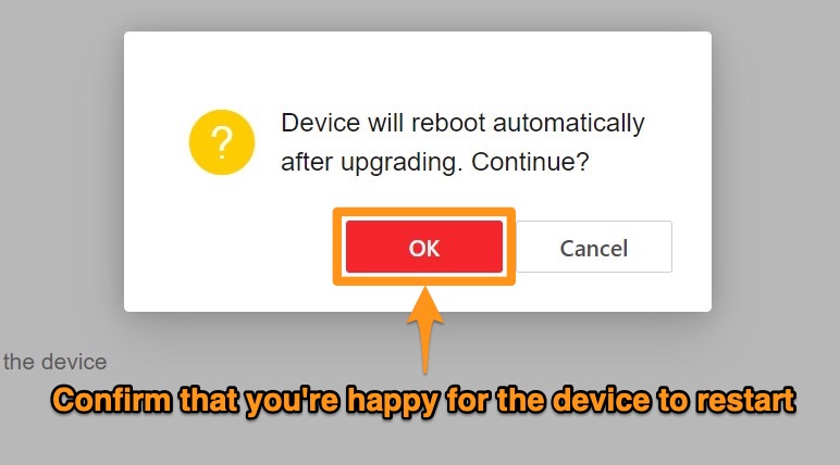

Click "Upgrade" and wait for the upgrade and then "OK" on the popup reminding you that the device will reboot after the firmware is installed:
