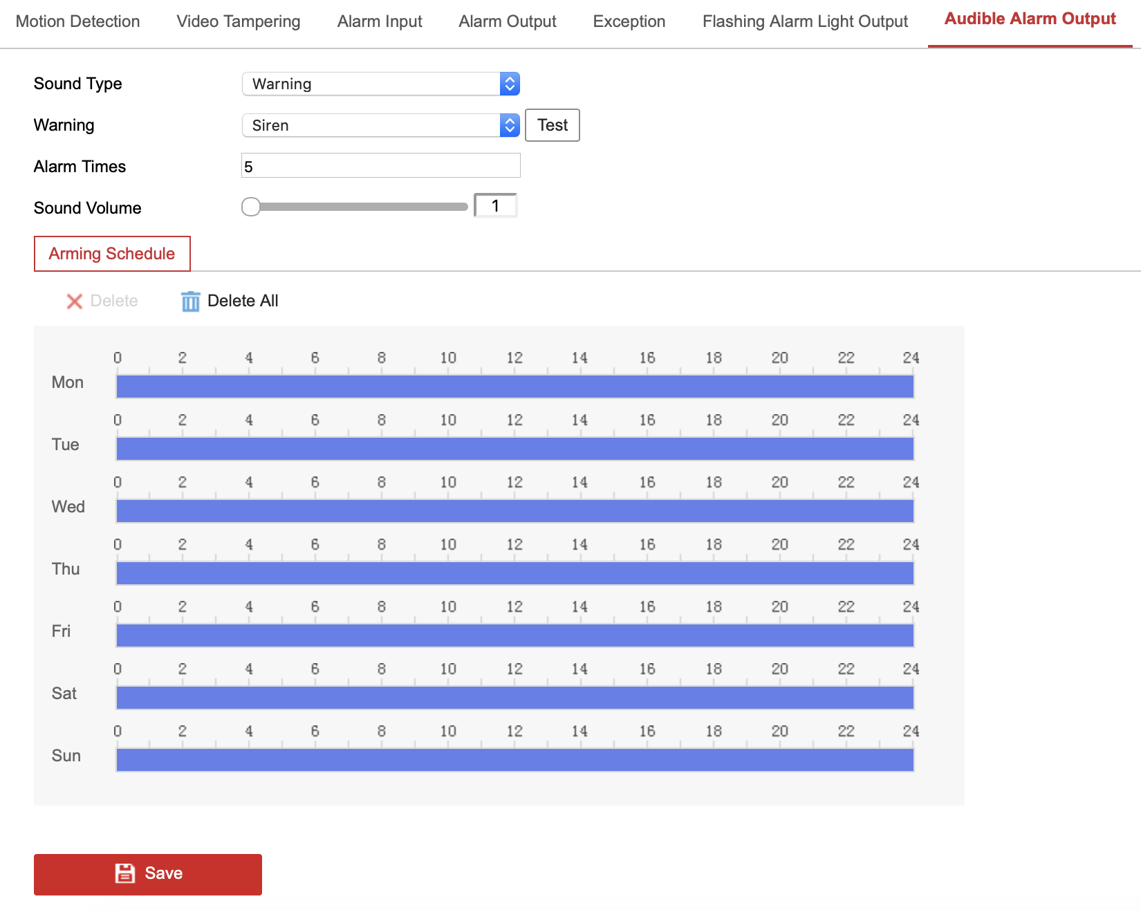

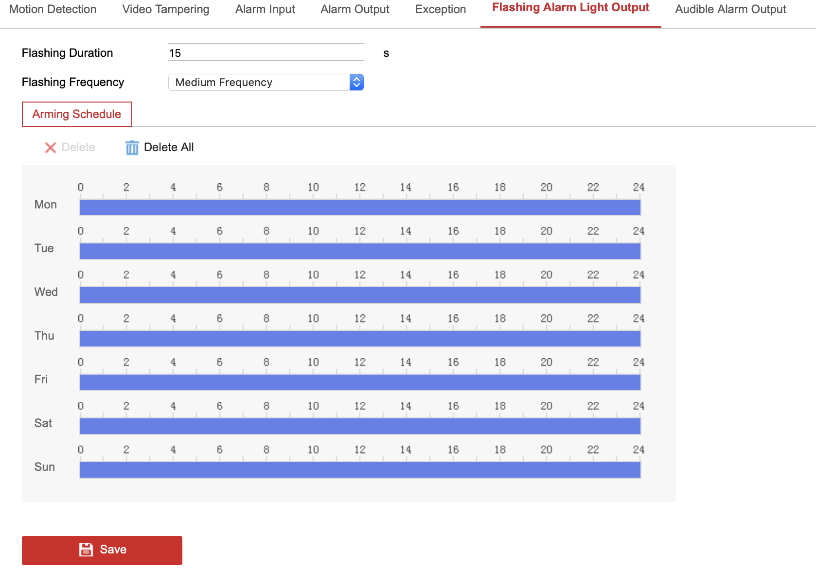

Even if the event is set to trigger the alarm and light - both the audible and visible warnings can be set to individual schedules as per the pics below.
In the Hik Connect app there is an option to temporarily disable all notifications with one click but I'm not sure whether that would disable the siren and light as well. There is however an option in the settings that could be switched across to "Receive events but NOT push notifications, and NOT allow Audio and Strobe Light alarms on device" but that would require a few clicks.

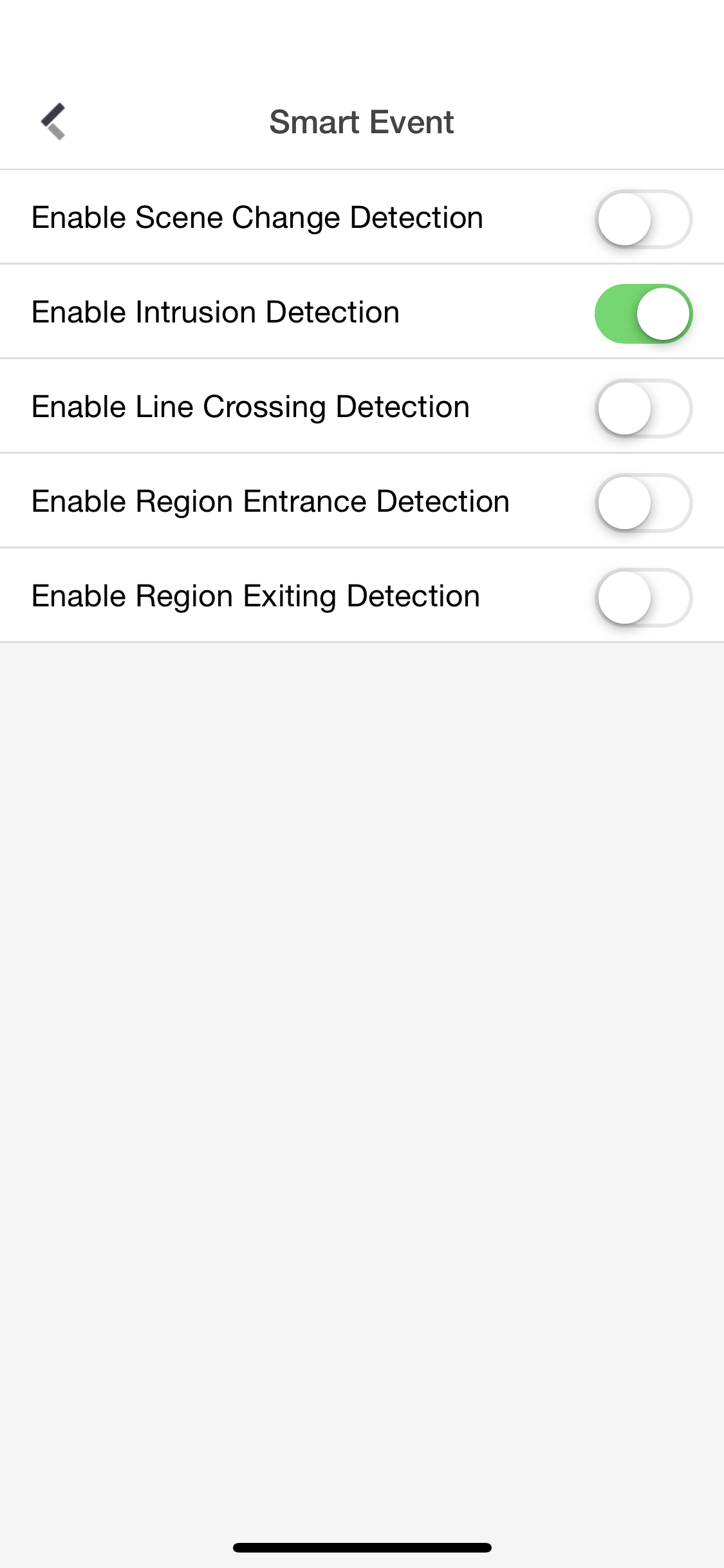

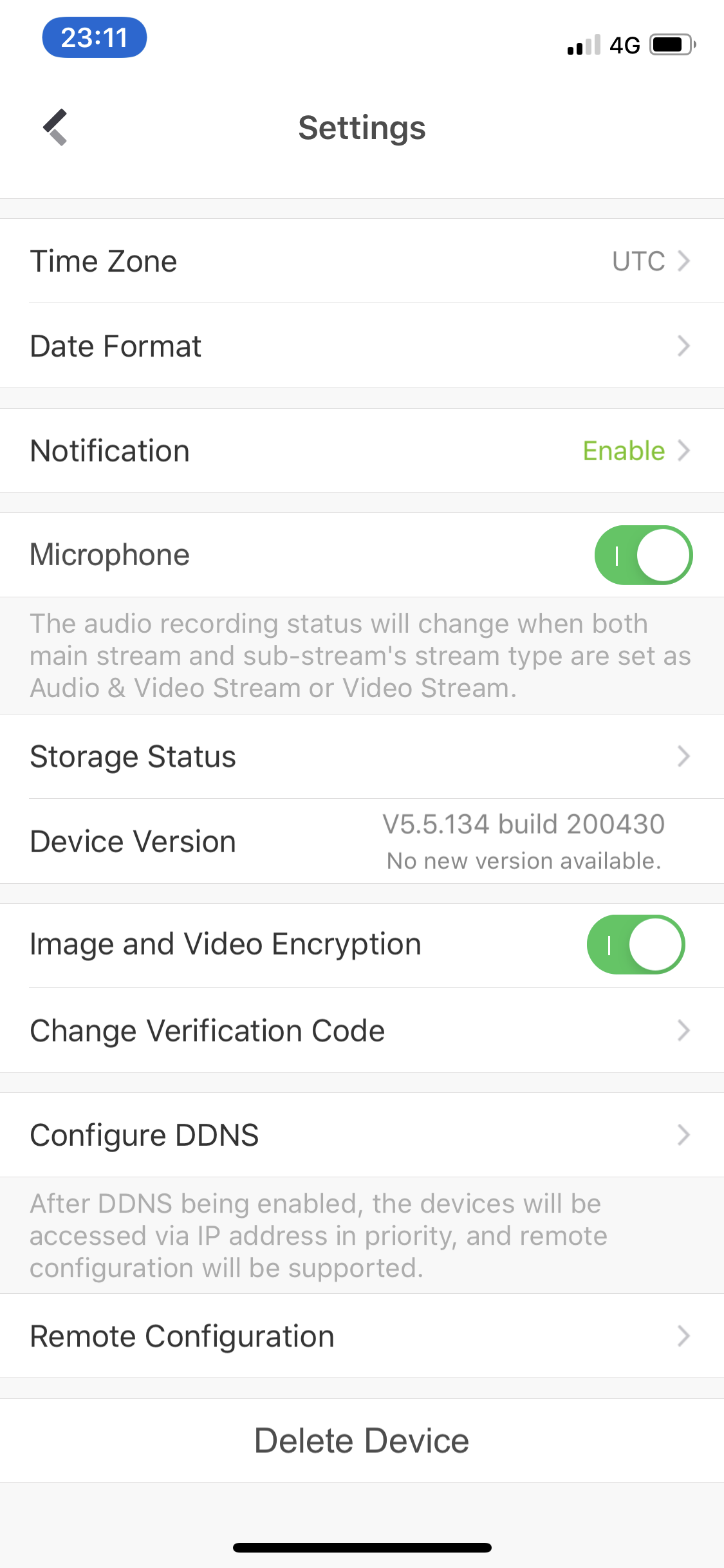

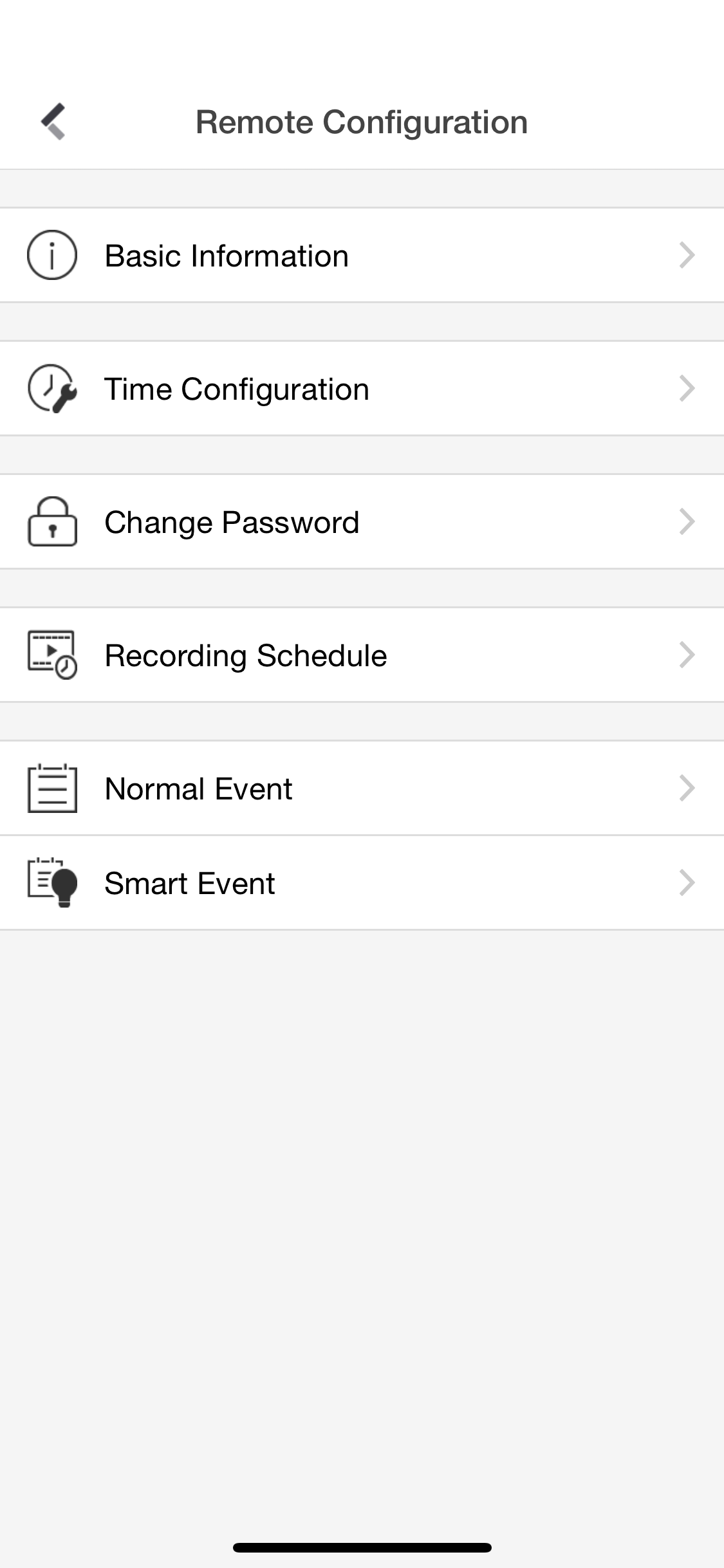

I've just been trying to find away to turn off the Alarm an Strobe on my G2 for a few weeks now.
Tried the One-Key Do Not Disturb function in Hik-Connect, but found out that only stops the notifications an doesn't turn off the Alarm and Strobe.
The only way I have found that dose work to disable the Alarm an Strobe remotely through the Hikvision-Connect app is if you Configure DDNS through the App. then you will be able to toggle off Smart Events.
