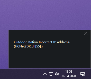

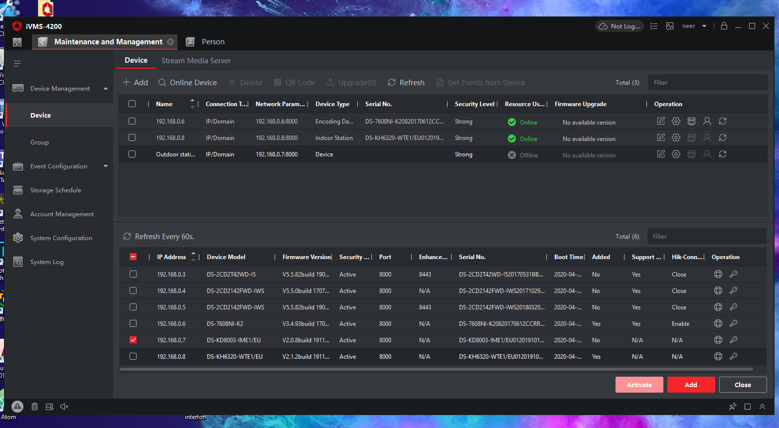

Hello, i have a problem , with the DS-KD8003-IME1. ivms see the 192.168.0.7 the ip for outdoor station and if i want to add to my devices he give me error and device begin to be offline. The ip address is correct, because working in indoor station. How to fix this? The doorbell don't have reset button...

Thanks but my problem turned out to be more basic. My installer had assigned different passwords to my indoor stations without telling me.
for my the indor station the password is 888999, you have been tried?
Mine too but I was talking about the iVMS-4200 password to load the device for tinkering. I was able to get it so problem over.
