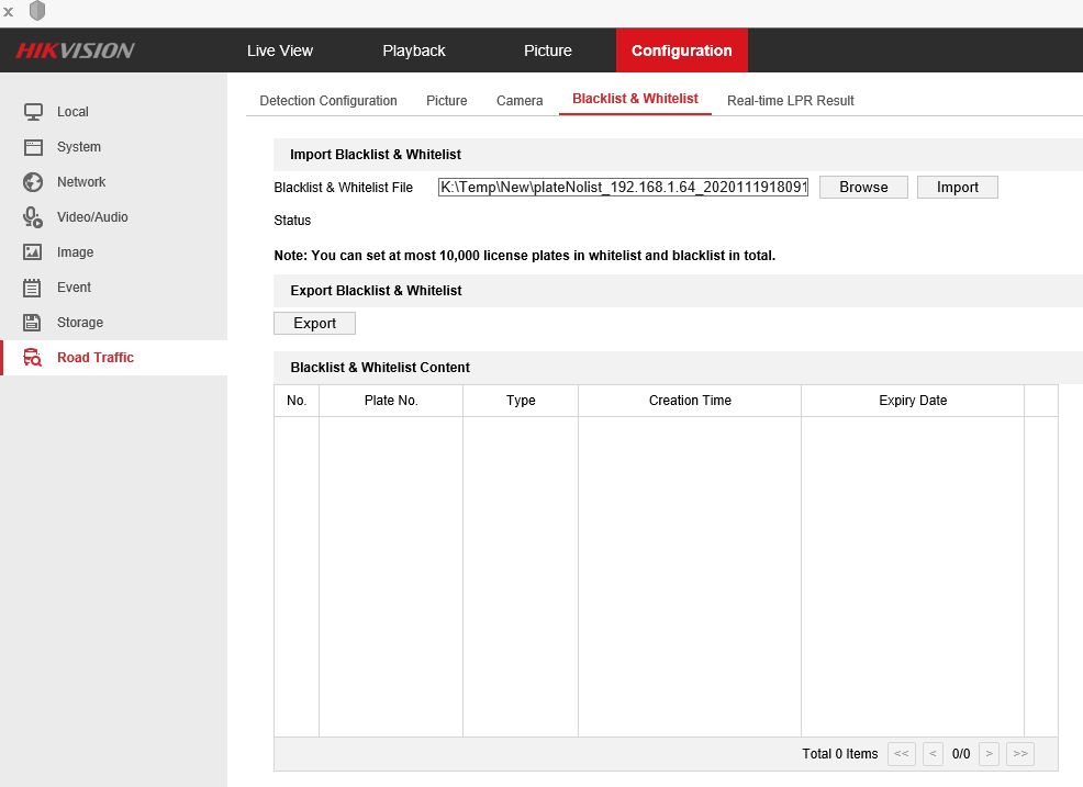

I have a problem with the camera model: DS-2CD4A26FWD-IZS/P firmware: V5.4.7 build 180309

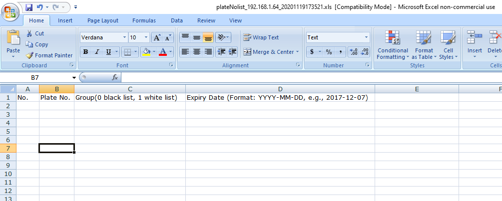

When importing a black & white list, an error occurs: file format is not supported.
EXTENSION IS (.XLS)
Do you have any solutions??

Hello I've had this problem before but with the NVR and have found out that it was because I was using Excel on the Mac, so I found that if I use Excel in Windows it seemed to work first time.

With that firmware working but then I can no longer access the storage! error code: HCNetSDK.dll[-1]

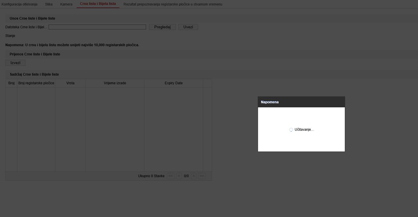

I solved that problem, but another problem arose as soon as I open the black and white list menu! :(
It also prints the loading window and rotates continuously!!??

Open Internet Explorer ( RUN AS ADMINISTRATOR), when editing Excel table edit it as text. It should work.
