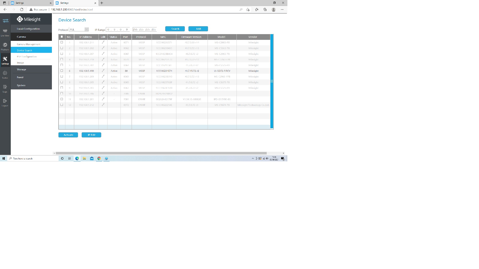

Can you please share a screenshot of how this camera appears in SmartTools?

Hi Dan
Here is the screenshot. Thank you

Hi @CazzaK91
Your new camera is not on the same network as the rest of your cameras.
You need to open the desktop SmartTools app (I can see from that screenshot that you have it open in your tabs at the bottom of Windows UI)
Change the camera IP address and Gateway address to your local network range (IP address - 192.168.1.xxx / Gateway - same as the other cameras listed in SmartTools)
Apply those changes using either the default camera password (ms1234) or the password you set. (you enter the device password in the top right of the desktop SmartTool window)
Once the changes are applied you can login to the NVR and go to the camera management page and add the camera manually with the details you set in SmartTools.
