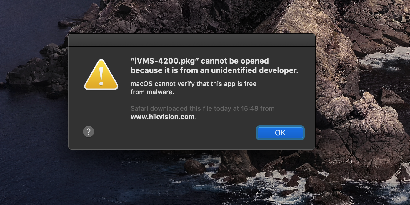

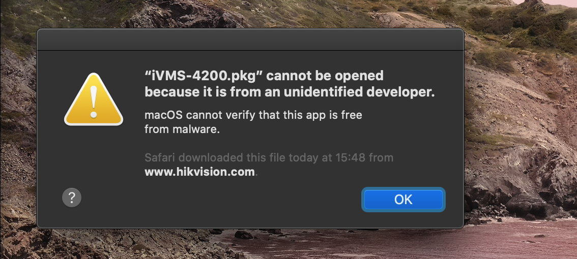

I am running macOS Catalina 10.15.2 and have not been able to install iVMS 4200 since last October when I installed Catalina.

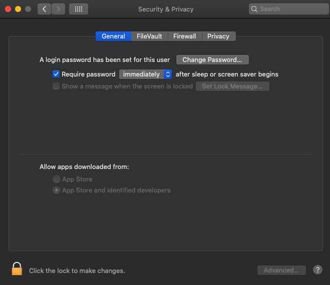

That message has nothing to do with Catalina application incompatibility, thats just a Catalina security warning that you get with all apps which come from developers not recognised by Apple. You need to go to Apple System Preferences- Security & Privacy, then you'll have an "Open Anyway" button under the "Allow apps downloaded from" section.
That being said, even once you resolve your Catalina security issue, the app still won't work because IVMS4200 is unsupported in Catalina - it may install, but it will crash when you launch it. See my post above from HikVision support. I'm afraid you'll have to wait until they release a new version.
Chenas
4
I am well aware of this and I posted the screenshots to illustrate the limitations of this software with Catalina...it is quite simply a workaround on a Mac and furthermore the installation on MS Windows is straight forward.
I have had this software instaled on my iMac since I updated to Catalina using this workaround but it still refuses to connect to the cameras!!
