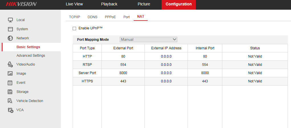

We could try a process of elimination. To begin with, please post screen captures of your DVR network settings, the Platform Access settings and one of the camera's stream settings, both Main and Sub.
Hi @StewartM,
Please see screen caps (I've blanked out info that might be sensitive):
Hopefully this is what you were looking for? Camera 01 is set as Main Stream but I changed the drop down to Sub Stream and took a screen cap of that.. not sure if it's correct?
Dan

Settings look good.
