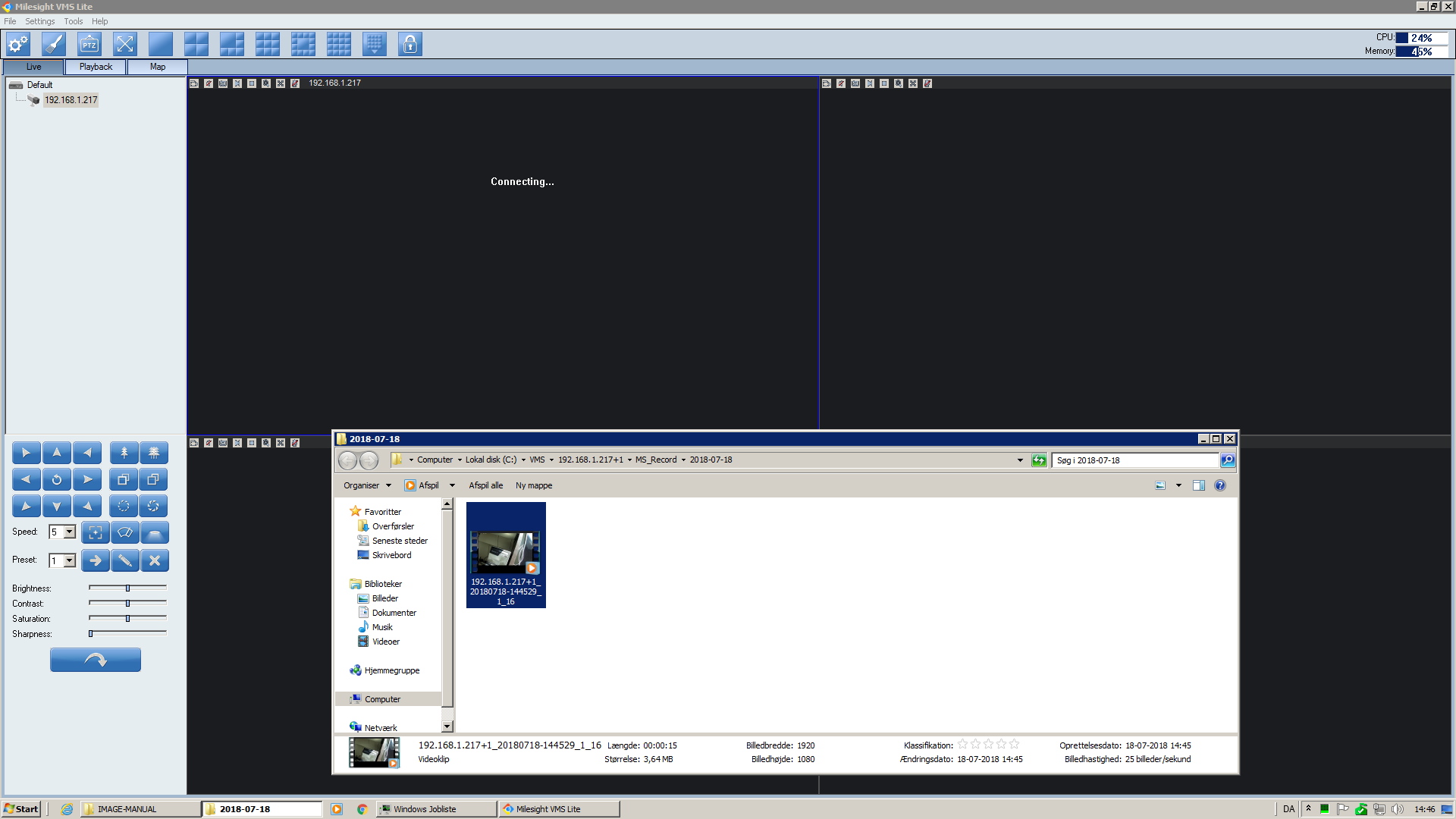

Q: Milesight VMS Lite can't connect
Lille
Hey all.
I'm brand new and hope this is the right place to post my question..
I try to connect my "onvif" ip cam to VMS Lite, but on the screen picture it's say " connecting ... " / no images, but recording working..
i hope you understand.. screenshot is attach

Sorry, we can only provide one-to-one support to our customers.
We checked here, and VMS Lite was able to find cameras from various manufacturers on our network.
I'm not sure why it's not working with your camera.
Some cameras may need a separate user role for ONVIF use:
ONVIF Issues & Solution with new firmware
Hello.
I got the very same issue. I fixed it downloading an upgraded driver for video card. Computer was using some kind of generic Microsoft driver.
