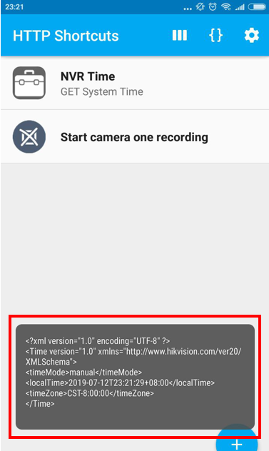

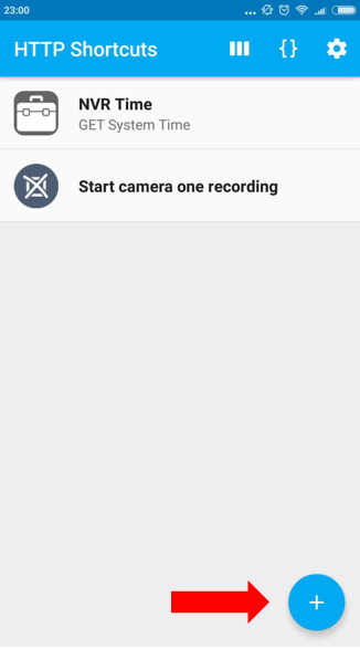

Great. Please install HTTP Request Shortcuts onto the tablet. This app allows the tablet to submit HTTP requests to the NVR.

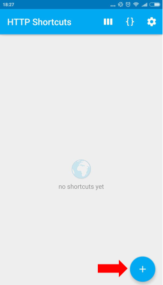

Open the app and create a shortcut with the plus button. Select 'From scratch' when prompted.
2388

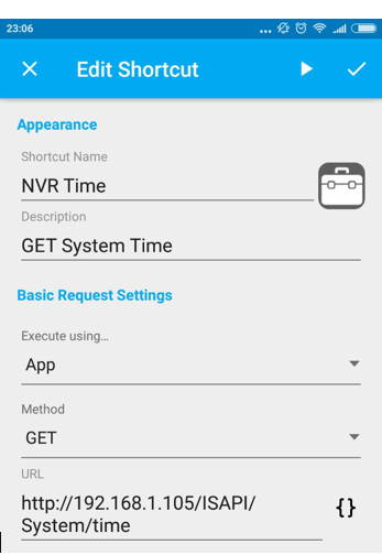

We need to test whether your NVR will accept the requests. Start with a simple time check.
Copy the settings below remembering to replace the IP with your NVR's in the URL field:
2389
2390
Click the tick at the top right to save the shortcut.
Next run the shortcut and hopefully you see a response like the one below.
2391
Let me know what the response says and we can go from there.

Greeat news!
I just tried again jsing a different android device and for some reason it worked and gave me the time!

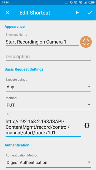

Ok, next step is testing on your side. Create a new shortcut.
Select from scratch.
2393
Give your shortcut a name.

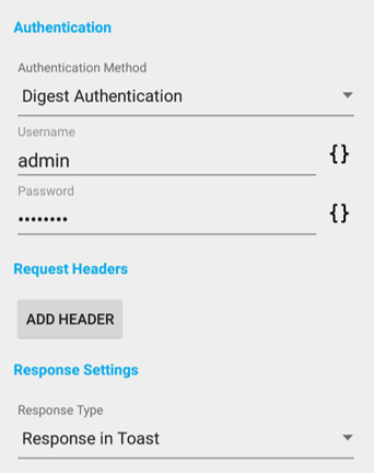

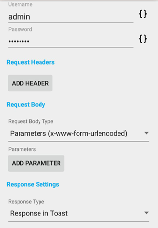

Copy the rest of the settings as below and paste: 192.168.2.193/ISAPI/ContentMgmt/record/control/manual/start/track/101
into the URL field. The 101 at the end of the URL is the camera on channel one (1) and its main stream (01).
2394
2395
Once you have copied all the settings click the tick in the top right corner to save the shortcut.

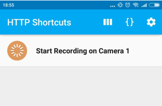

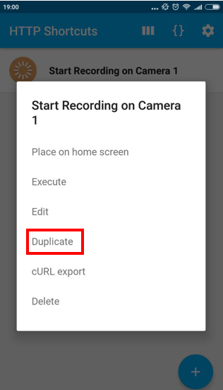

Press and hold the shortcut you just created until a menu appears:
Select Duplicate.
2397

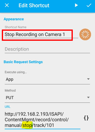

A duplicate shortcut will appear marked as (copy). Press and hold the new shortcut till the menu appears and select Edit.
Amend the shortcut name to reflect stopping the recording on camera one. Edit the URL field to match (just replace 'start' with 'stop'):
192.168.2.193/ISAPI/ContentMgmt/record/control/manual/stop/track/101
2398
Click the tick to save the edited shortcut.

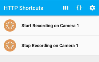

You should now have a main screen similar too:
2399

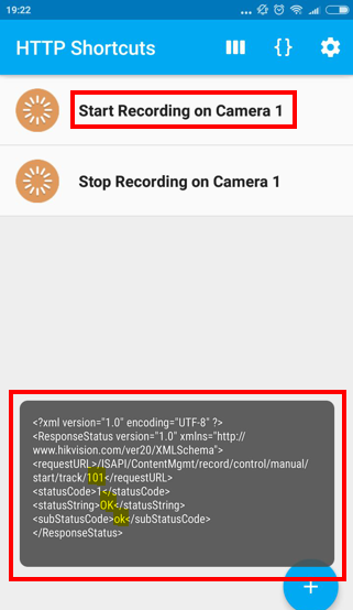

Run the shortcut 'Start Recording on Camera 1'
Hopefully you will see the following response:
2400
If you don't receive the highlighted 'OK' please post the response and we can trouble shoot from there.
If you do receive the OK response you have successfully started the unscheduled recording.
Run the 'Stop Recording on Camera 1' shortcut too and let me know the response.

I used both the start and stop jobs and it worked fine and I was able to access the recorded movie.
My NVR did not reboot.
