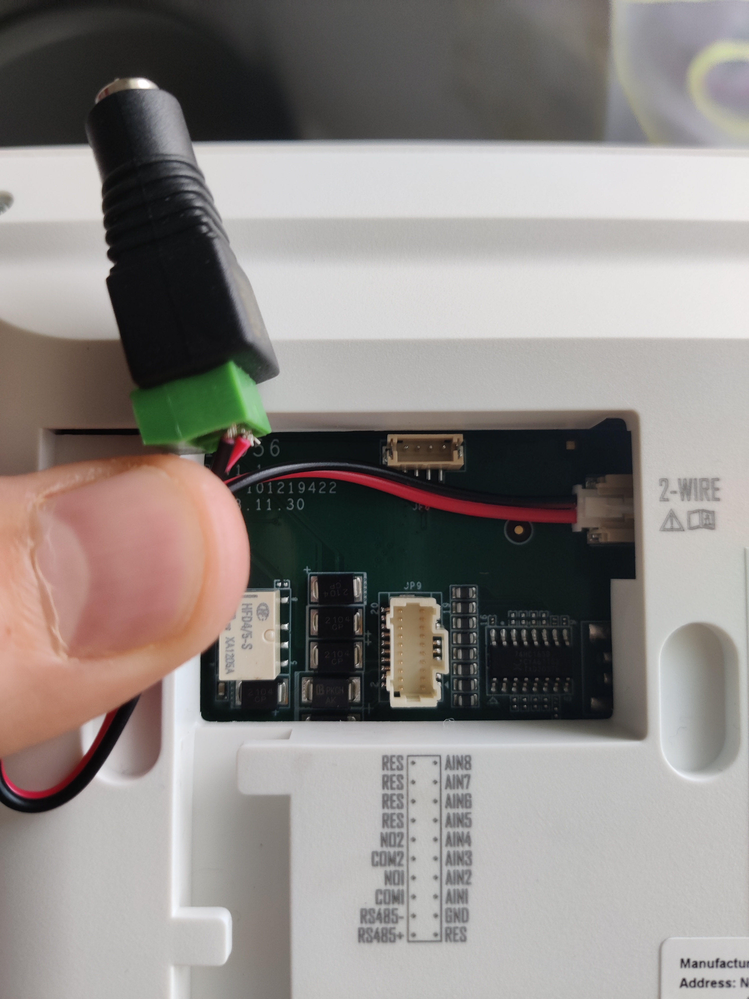

The indoorstation is in the same networt via wlan connection. I cant use an ethernetconnection on the indoorstation (See attached Picture)

You have KAD706 that's on your local network?
You have KH6320-WTE2 ( 2-wire version). Try connecting KAD706 to switch where you connected outdoor unit.
No, i dont have a kad706 on my network, as IT was told from the seller, that i can use the indoorstation with wlan alone as long as i take care for the powersuply.
Is the kad706 mandatory?
We are official distributor of HIKVISION equipement in Croatia. We never sold KH6320-WTE2 without KAD706 and never told anybody to use KH6320 WiFi for communication with outdoor unit.
As far as I know it's not meant to work that way. You have do other options to try ( besides the one you tried). Can you borrow KAD706 from your reseller and try?
