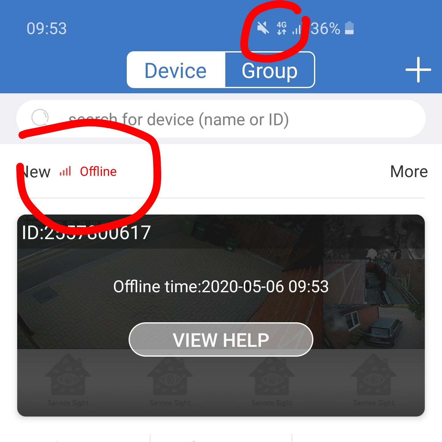

For some reason whenever my phone comes off of WiFi and on to 4G the CCTV system shows as OFFLINE on the phone which means I can't view it remotely which is a feature I most definitely need!
WiFi = ONLINE
4G = OFFLINE

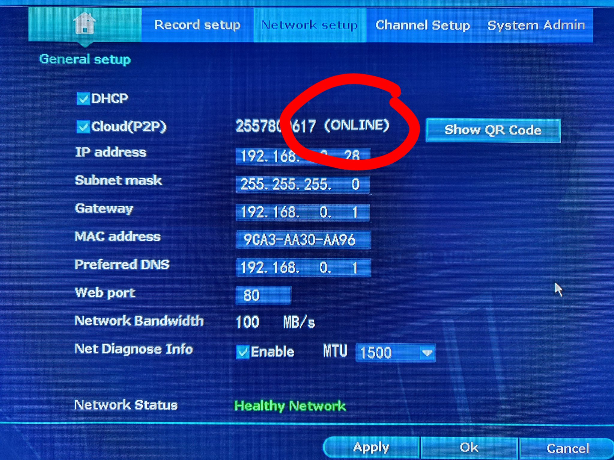

The actual system when viewed via HDMI on a TV always shows that the P2P is ONLINE so I don't believe there is anything wrong with the setup of the actual DVR itself (maybe).
P2P = ONLINE

  • Tried 3 different devices to rule out any settings or mobile network restrictions on the devices
  • Logged out and back in on devices
  • Uninstalled/reinstalled apps on 3 different devices
  • Unchecked DHCP and Cloud P2P in the DVR settings, applied it then rechecked them and reapplied them (as suggested by the manufactures website)
