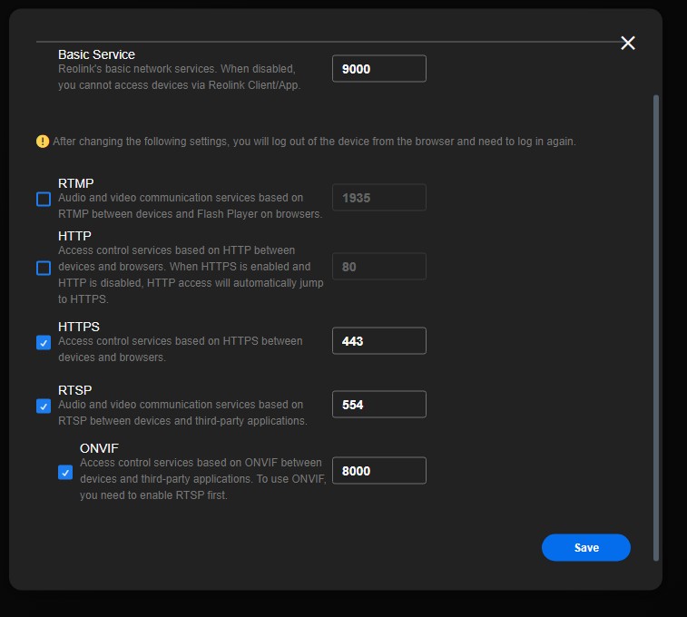

Took me hours to get the Reolink RLC-810A to display on a Hikvision NVR DS-7108. I did not give up since I read the previous post that gave me hope. But in my case a few other items of note. My Router uses the 10.0.0.1 Gateway, the NVR assigns 192.168.254.* series IP's to the cameras as internal which must stay that way apparently. So separately I assigned 192.168.254.5 as the IP in my case its camera #3. Also ONVIF was not enabled in the camera settings which caused much wasted time. There is a setting under basic service RTSP port 554 must be checked to enable the ONVIF port 8000.Hi
After much frustration eventually got Reolink camera working with HIK NVR.
It just needed the default ports that the Reolink uses changing.
Standard is Management port 8000 and HTTP port 8000
The NVR expect ONVIF management port to be 8000 and the HTTP port to be 80.
The built in camera Reolink app can be used to change these.
Settings
Network
Advanced
IP can also be changed to what you need it to be.
