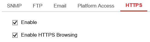

By the way, these are the two check boxes that cause this trouble:
