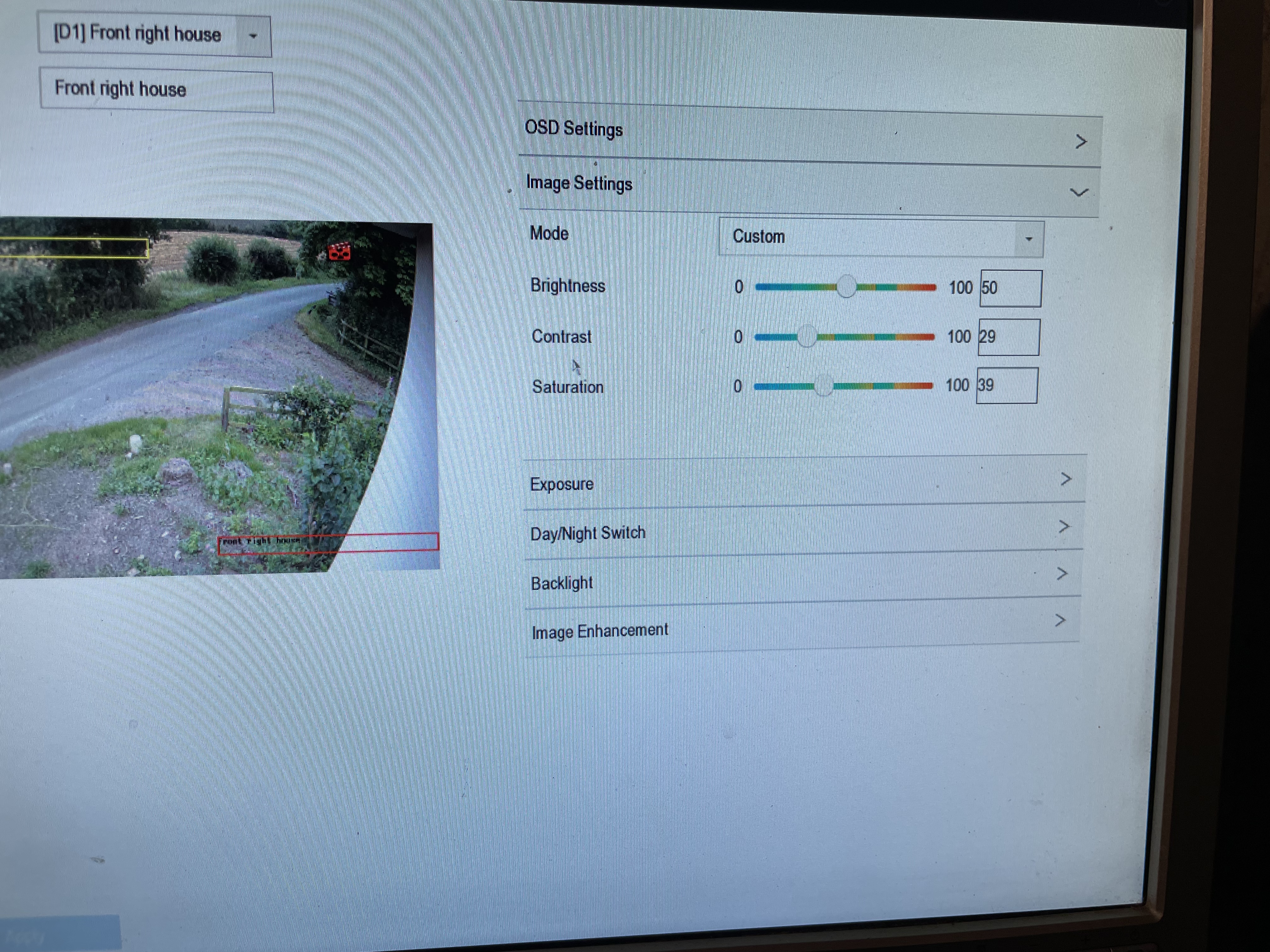

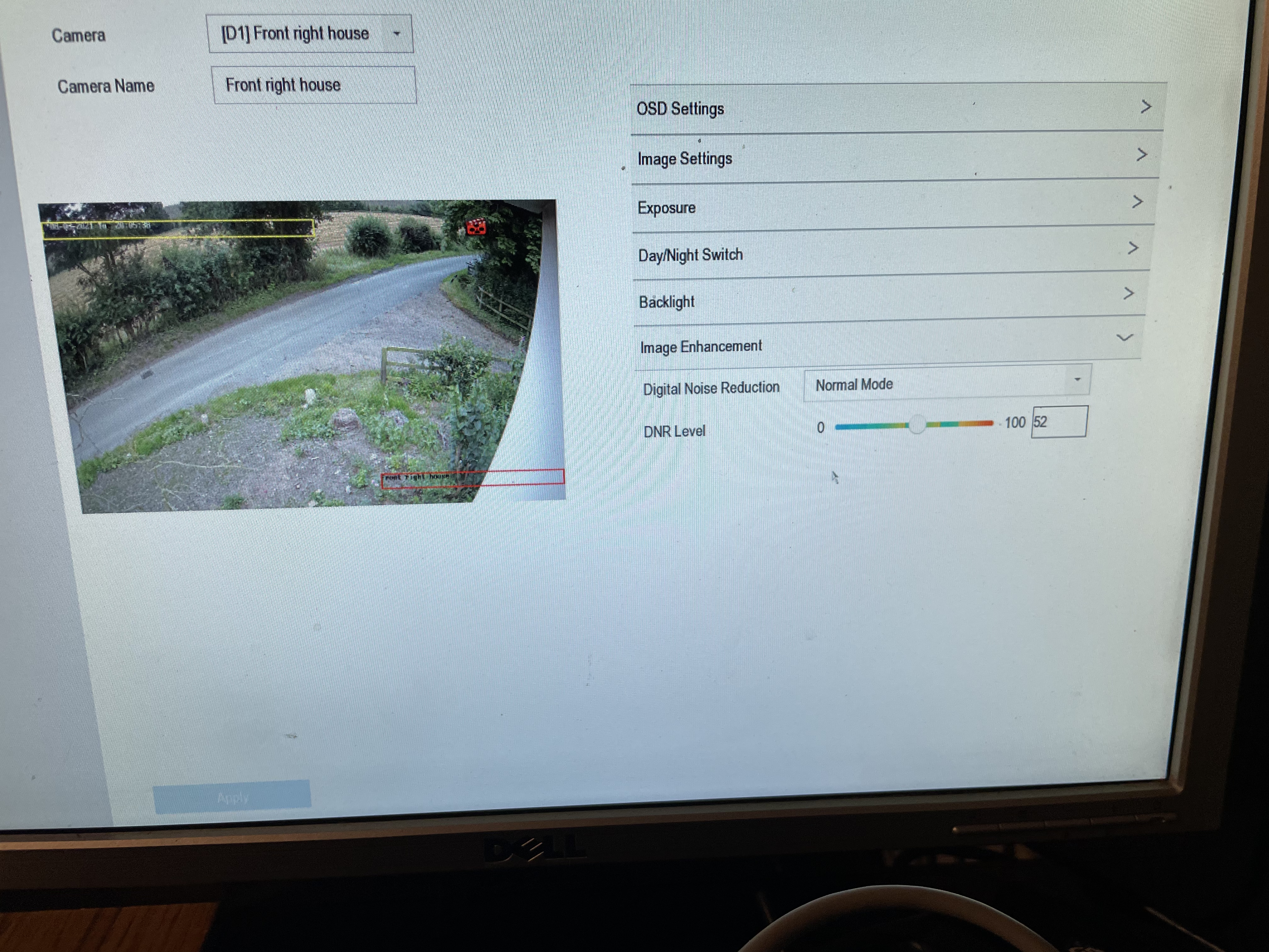

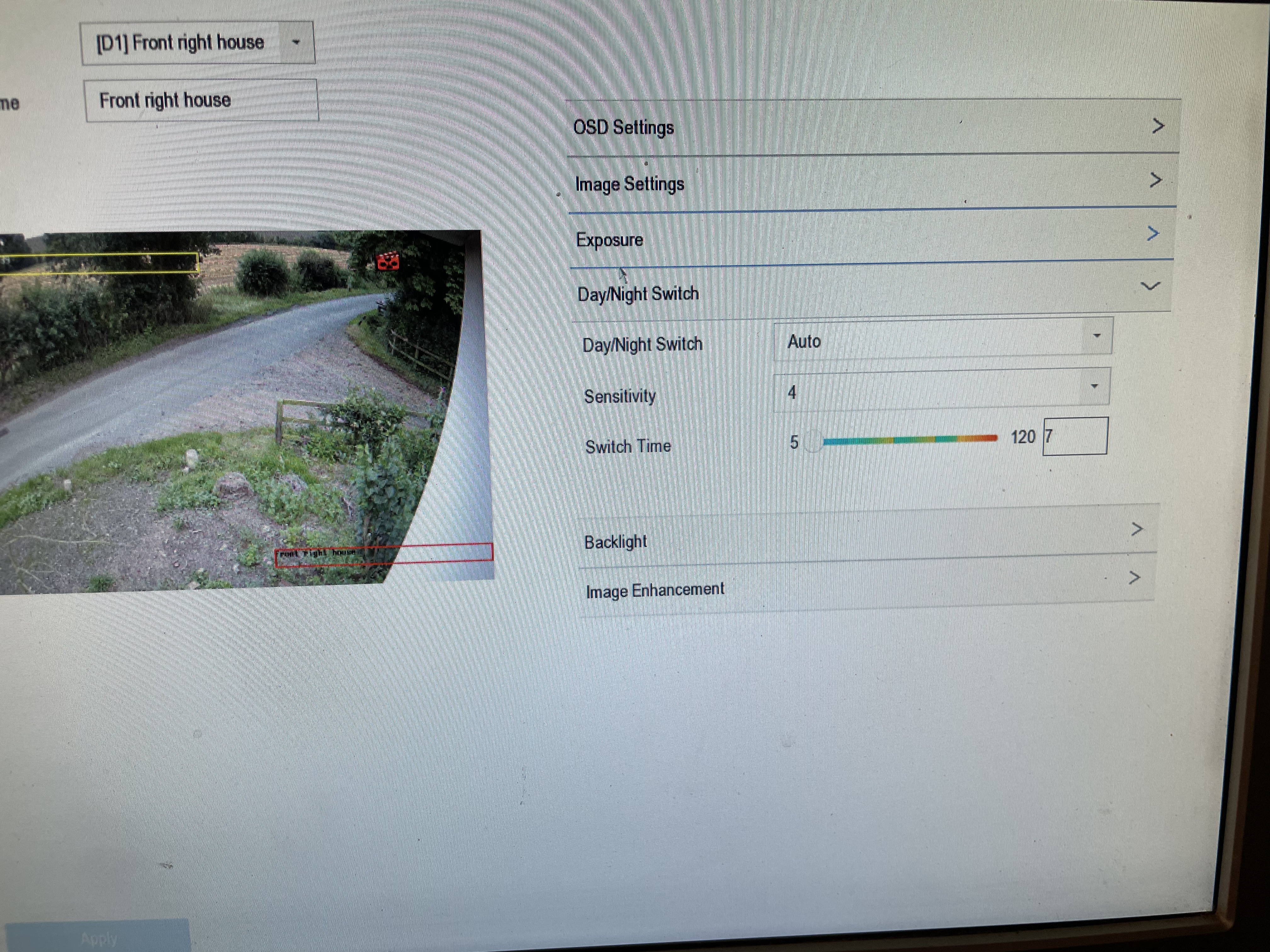

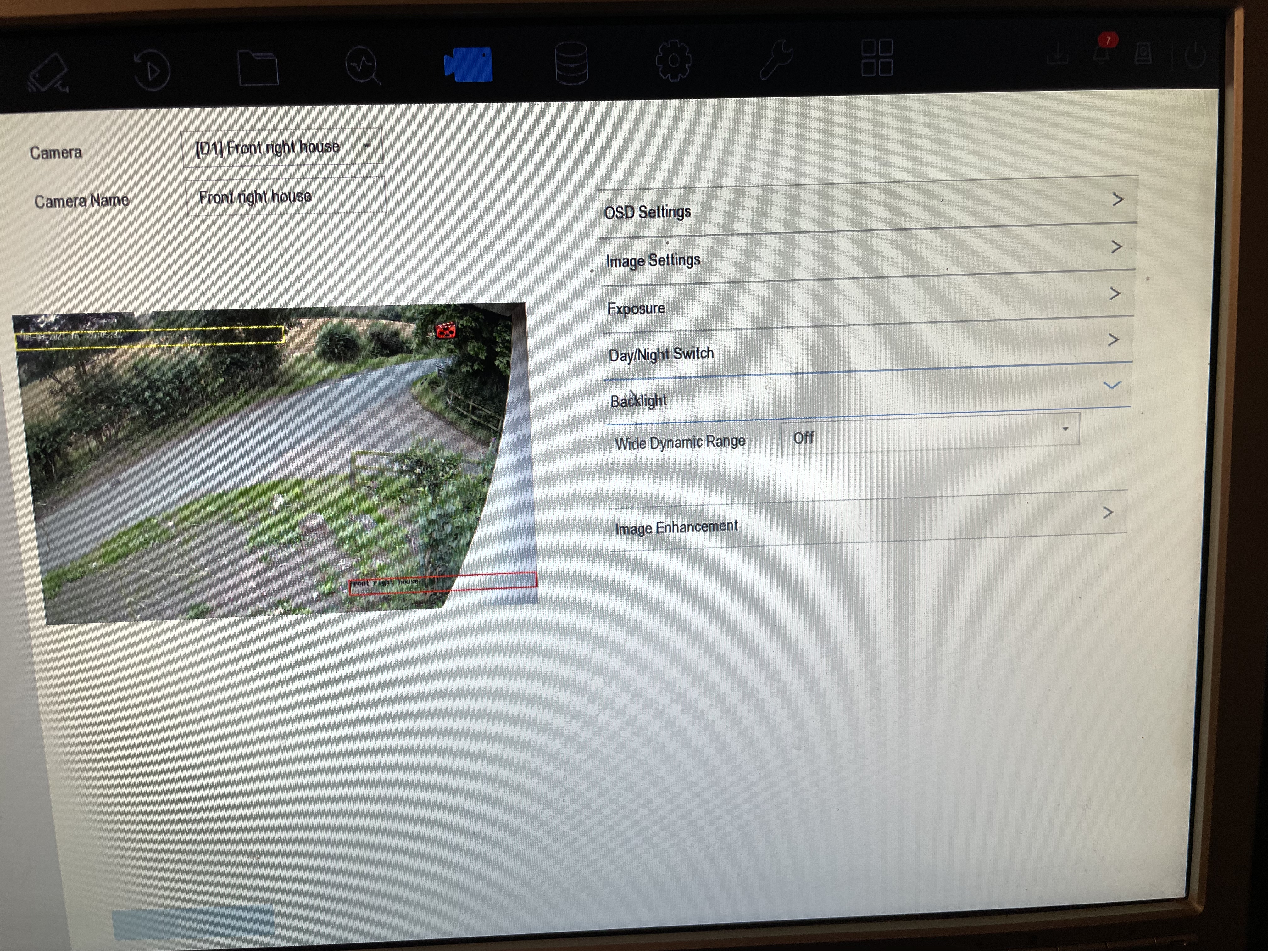

Shortly after this someone in my house spotted someone from the road eyeing up the house. The chap was no more than 20–25meters from the camera, but the image of his face was pretty poor for a 5mp camera. Checked all setting and have made some tweaks which have upped the quality somewhat.

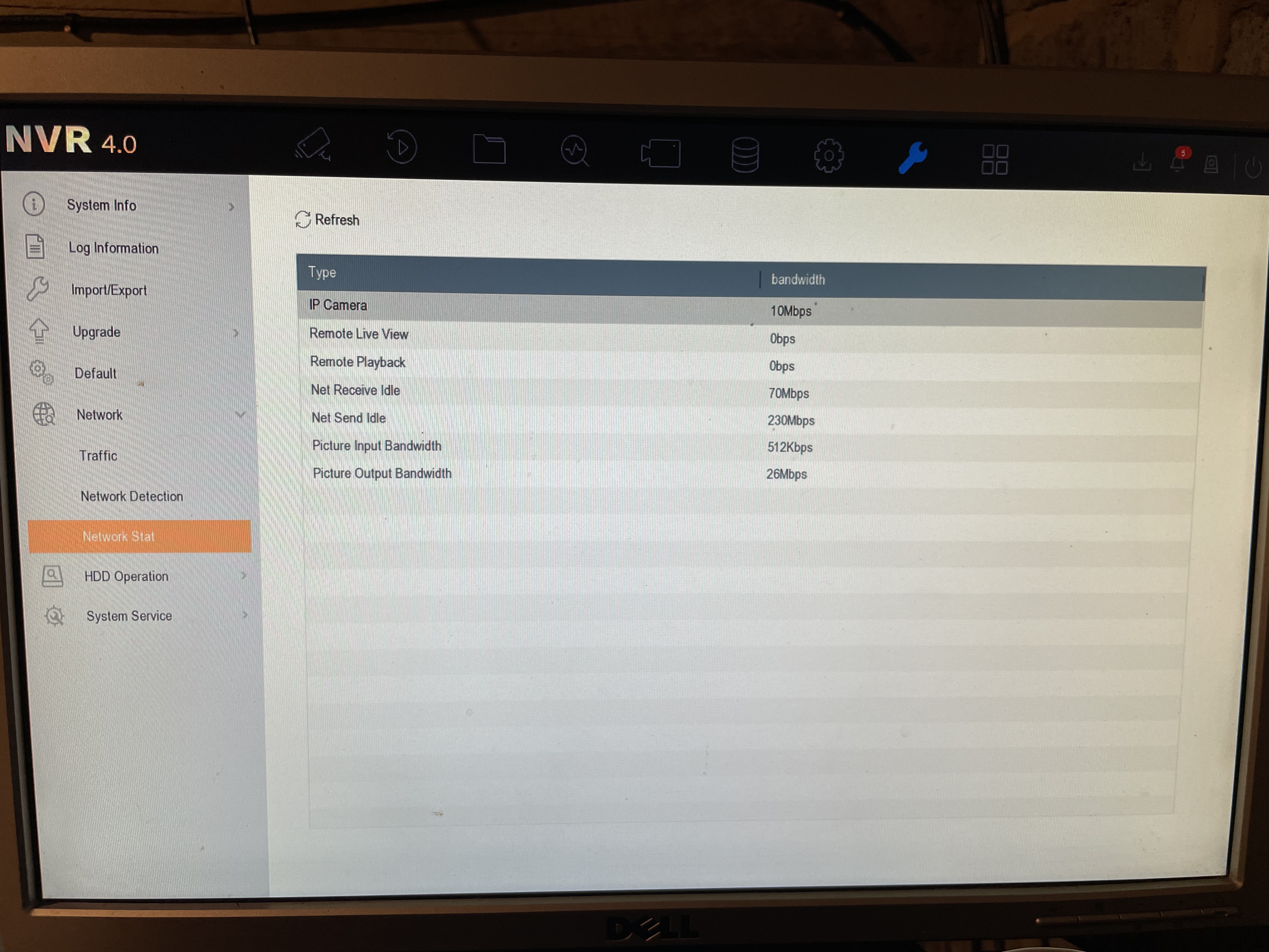

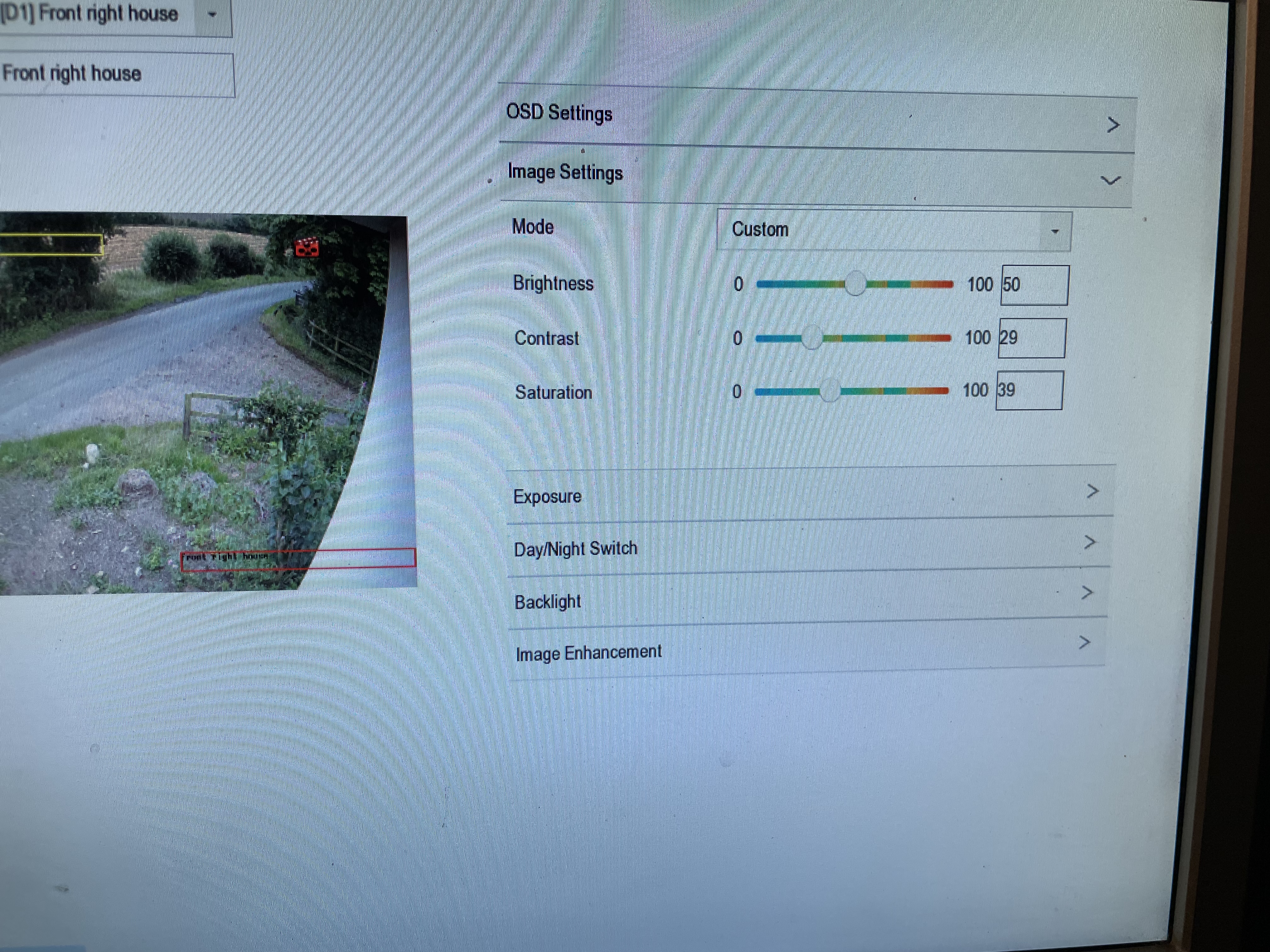

Can anyone offer any guidance? I’m at the end of my tether with the IP Stuff. While it might be more reliable in terms of notifications, it’s a pig from a config standpoint.
DS-7608NI-I2/8P 12MP 8 Port PoE NVR running a Toshiba S300 4TB Surveillance 3.5" Hard Drive
Linked in is just ONE DS-2CD2386G2-ISU/SL
Issues are:
Cant playback footage via Hik-Connect, or directly from the NVR without the video skipping. The bits that can be played do to have audio either when played on app.
The 2 way audio doesn’t stay connected when in live view. The image however is near on perfect in live view, both on the NVR and Hik-Connect.
unable to set up area for smart event, the screen is just black when the camera image is.
Have spent best part of 2 hours in the loft messing around can’t find the problem.
I now wanna go back to the loft and do a video of me smashing the bloody thing up and posting it online as a product review.
JB1970
Well-Known Member
869
63

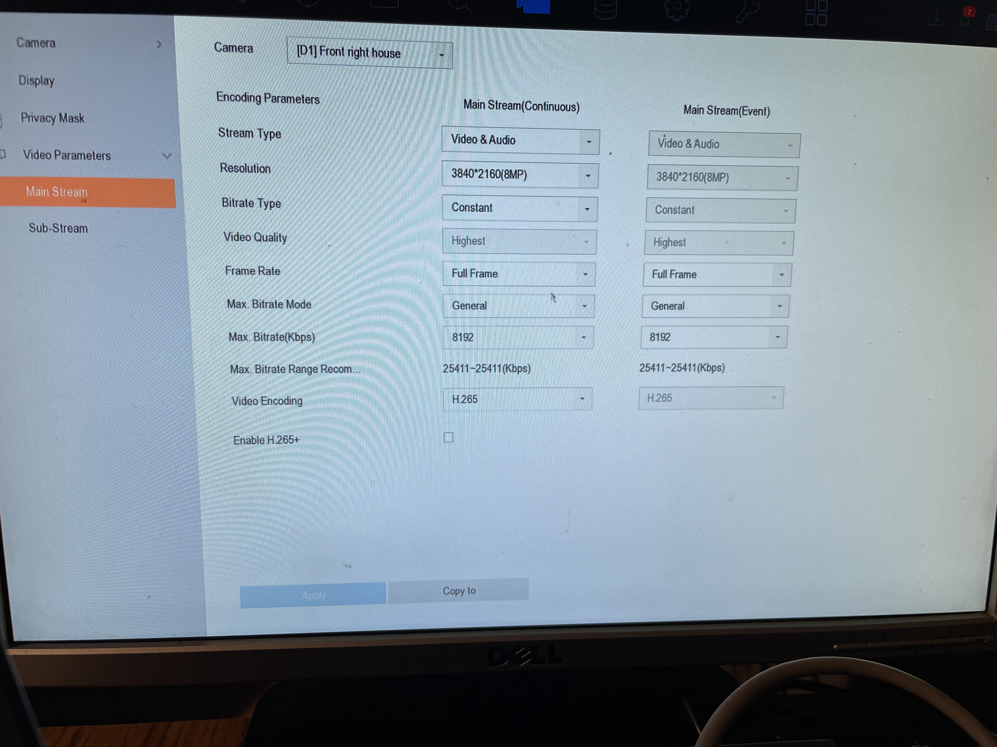

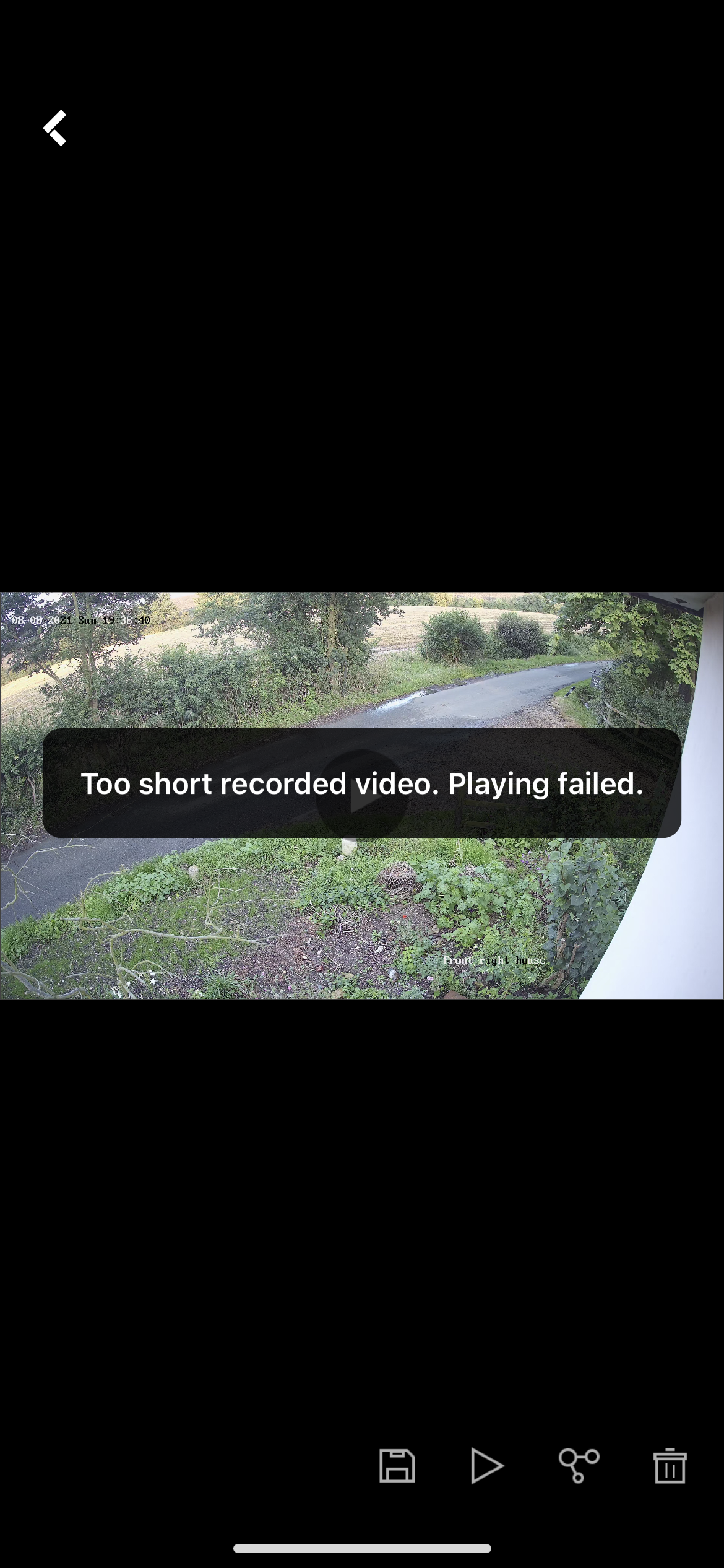

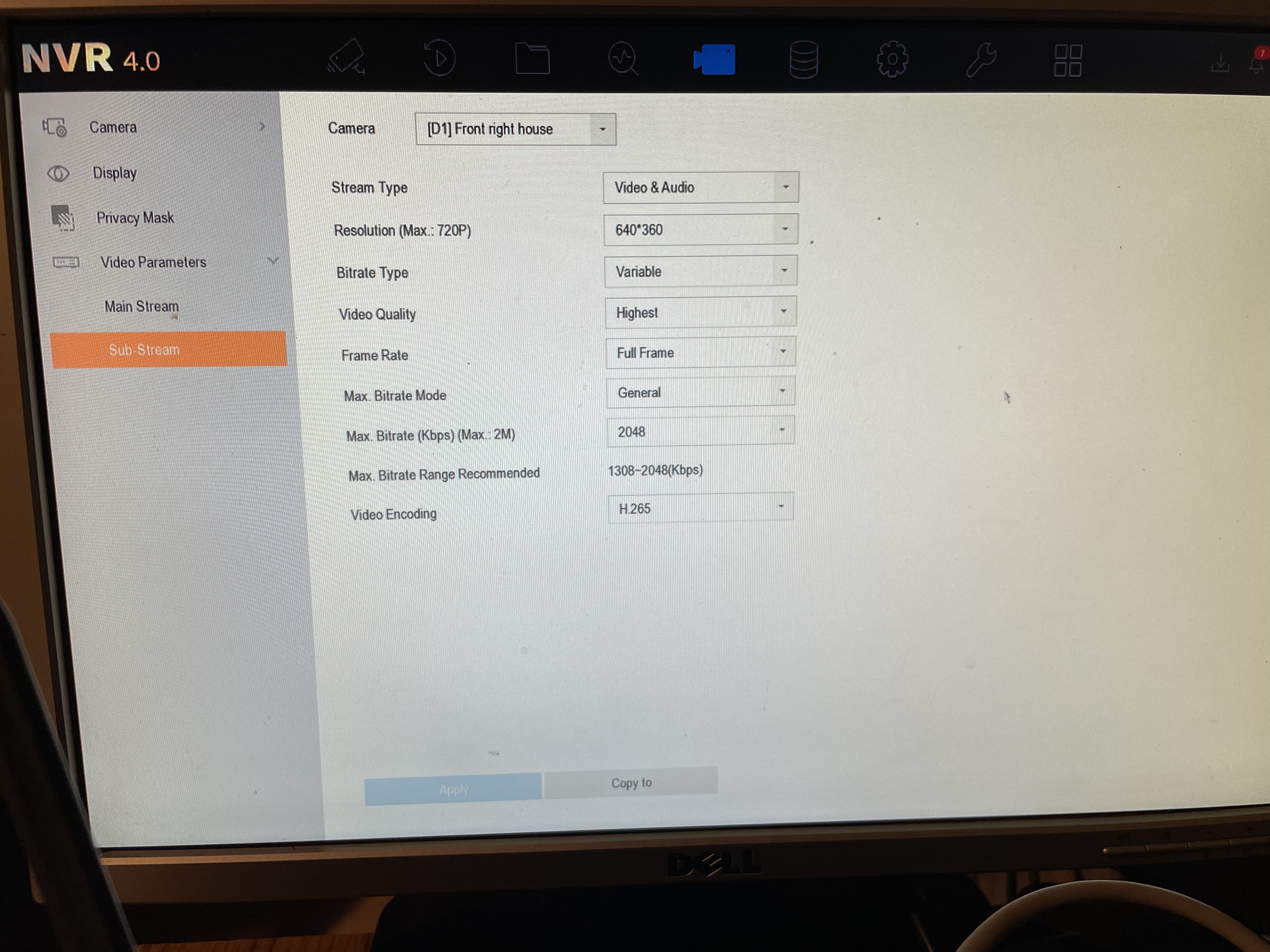

Issues are:

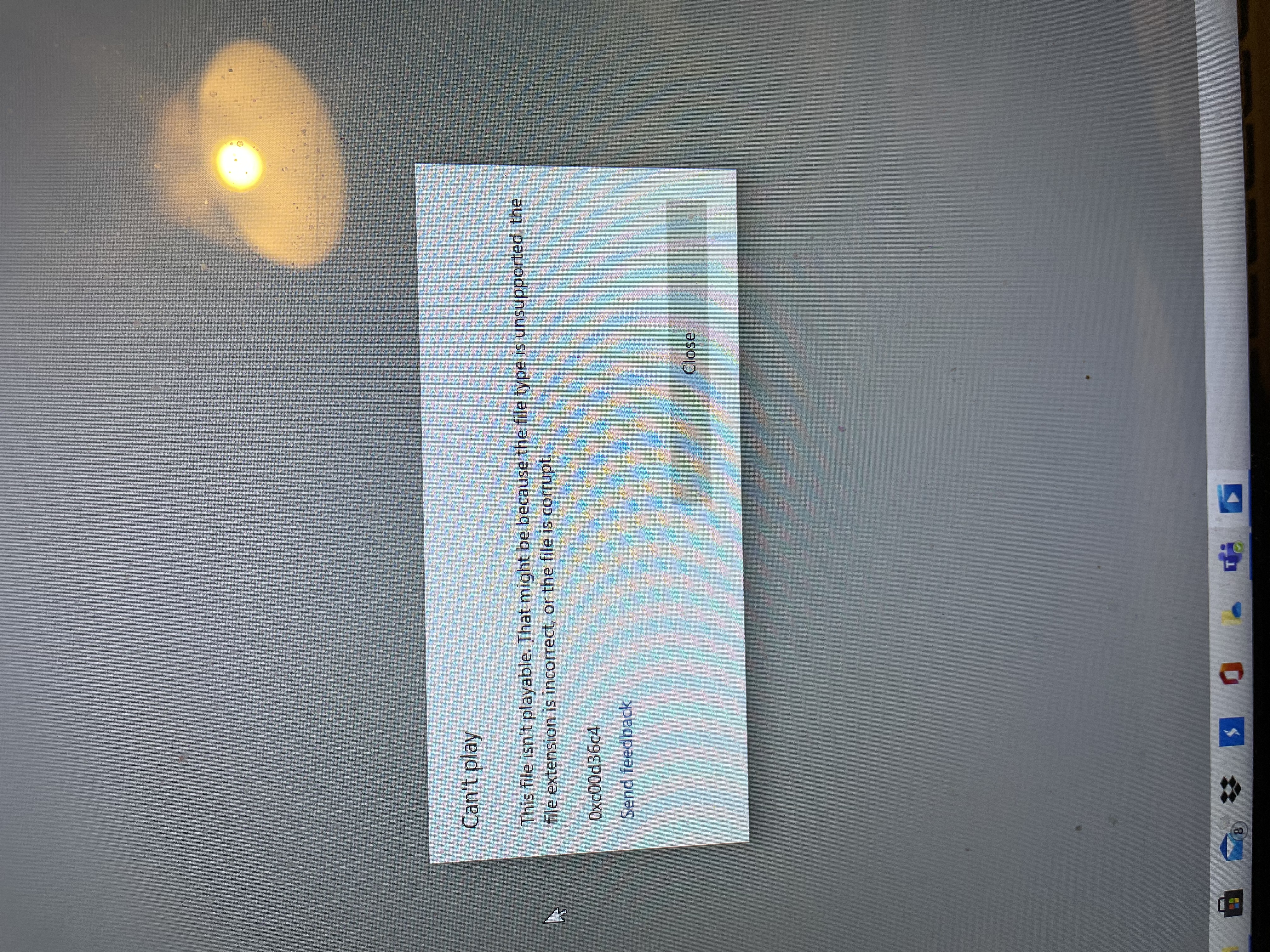

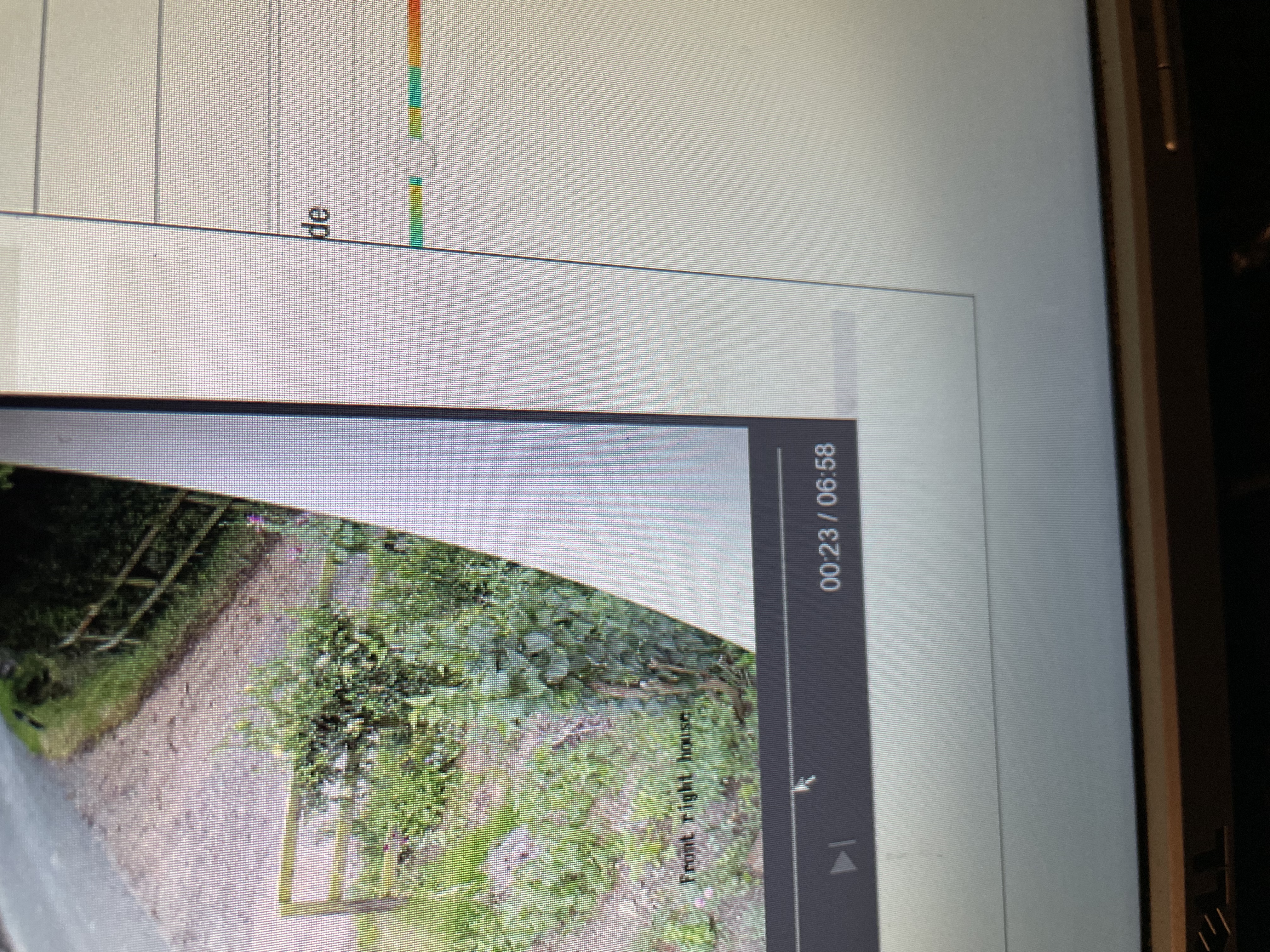

All most likely down to settings: First check the video parameters for the camera in the NVR menu.
  • set to H265
  • In the drop down set to Video & Audio. Do that for both main and sub stream
  • Ensure that the main stream normal and main stream event both have the same settings with regard to frame rate and bit rate.
  • In the storage menu bring up the schedule, click Advanced. In the pop up panel ensure record audio is checked
  • In the same window as above change the pre alarm from 5 seconds to 0 seconds (this along with different settings in video parameters is the most likely cause if skipping)
  • Let us know what video parameters you currently have set
