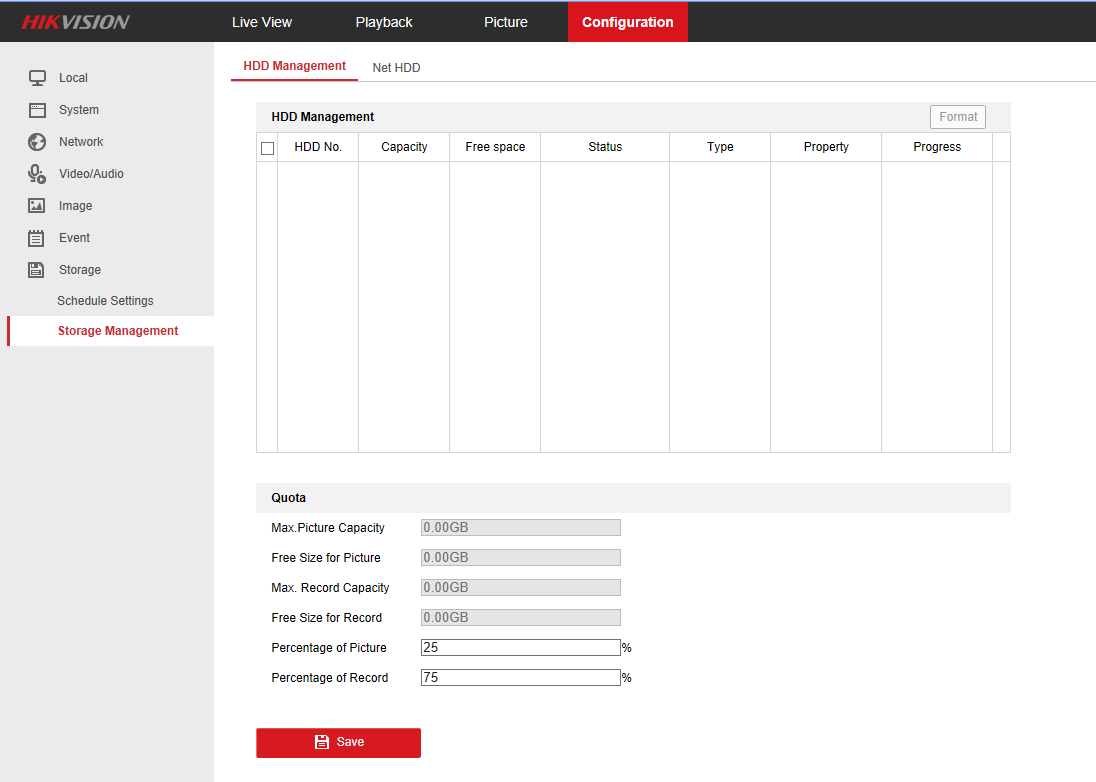

I've not done it, but I'd guess you could.
Add the card and configure in Storage Management:

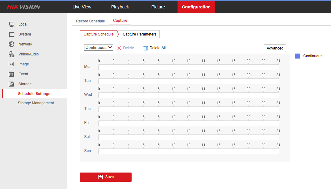

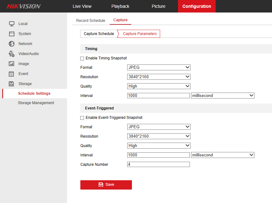

Then configure the capture schedule and capture parameters:

I found a micro SD card from an old mobile phone (only 4gb). And it does indeed work, I can download from the card through the camera interface. I don't think you can delete the images in camera though, looks like you've either got to re-format or leave to overwrite.
Now I know it works I've Just ordered a bigger capacity card.
