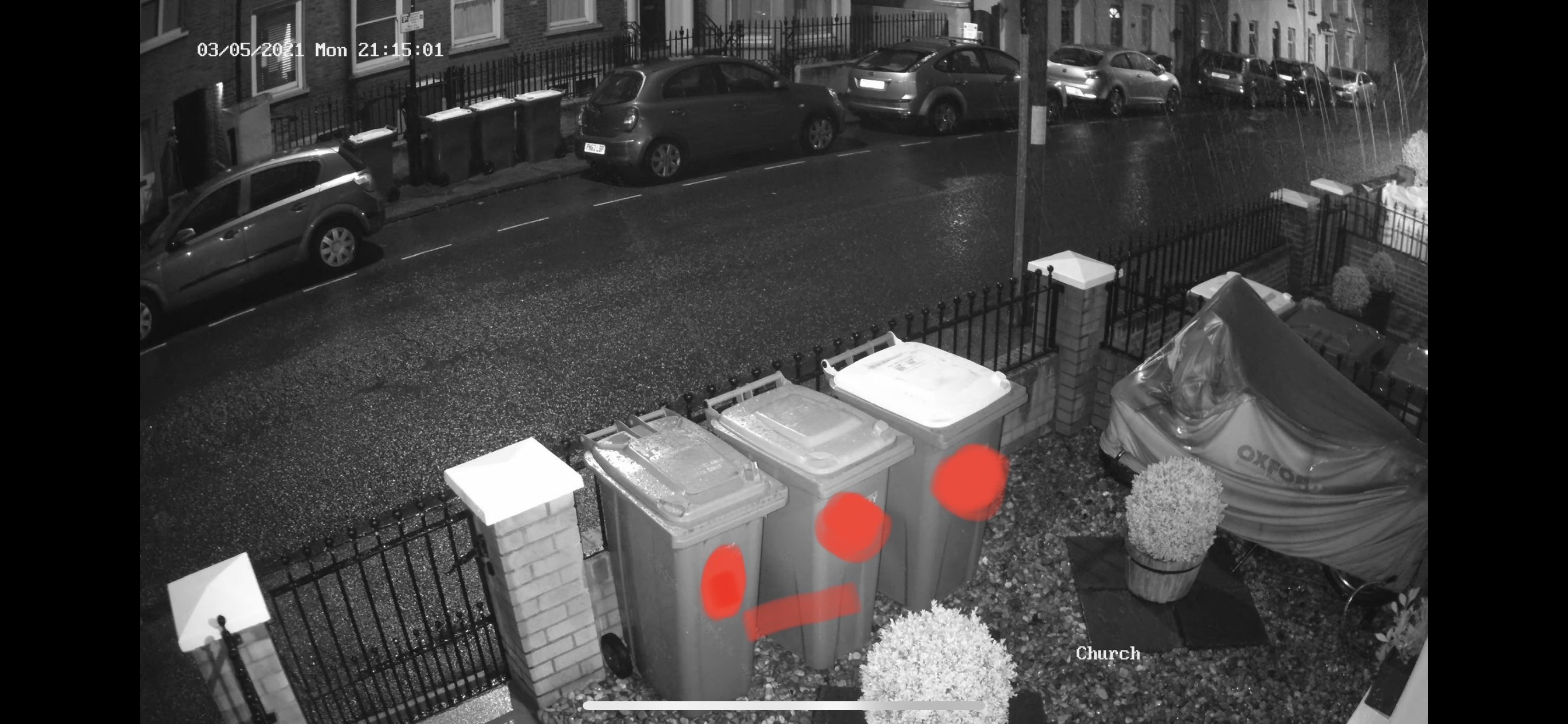

I’ve a number of 2385 and 2386 (and a 2345 in the cupboard) and 4 and 7 series ANPR’s in my system and I have motion blur both day and night on people walking, external light at night is not that bad (in my opinion) with plenty of streetlights. I’ve got out the box settings, any advice? When I people search on the IDS7716NXi they are very blurred on the photos

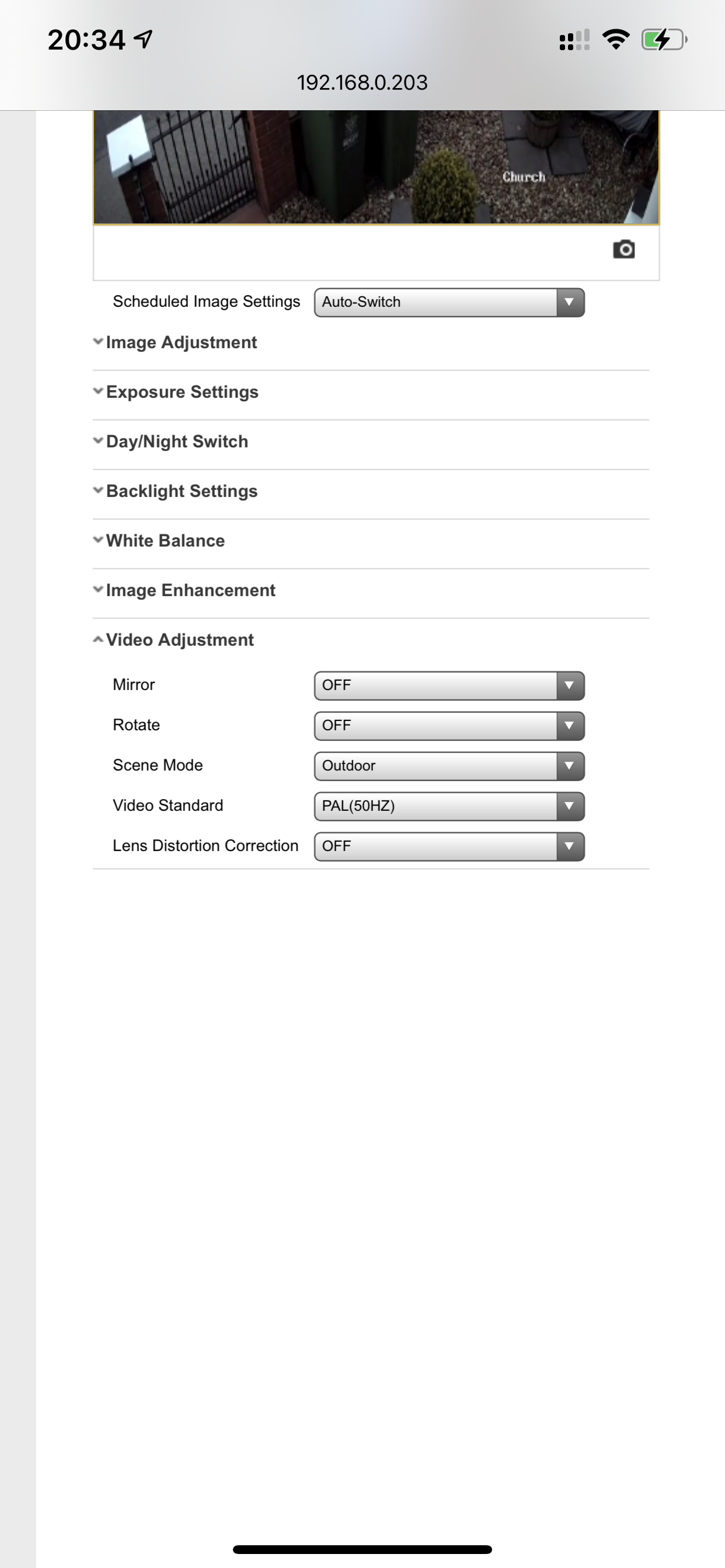

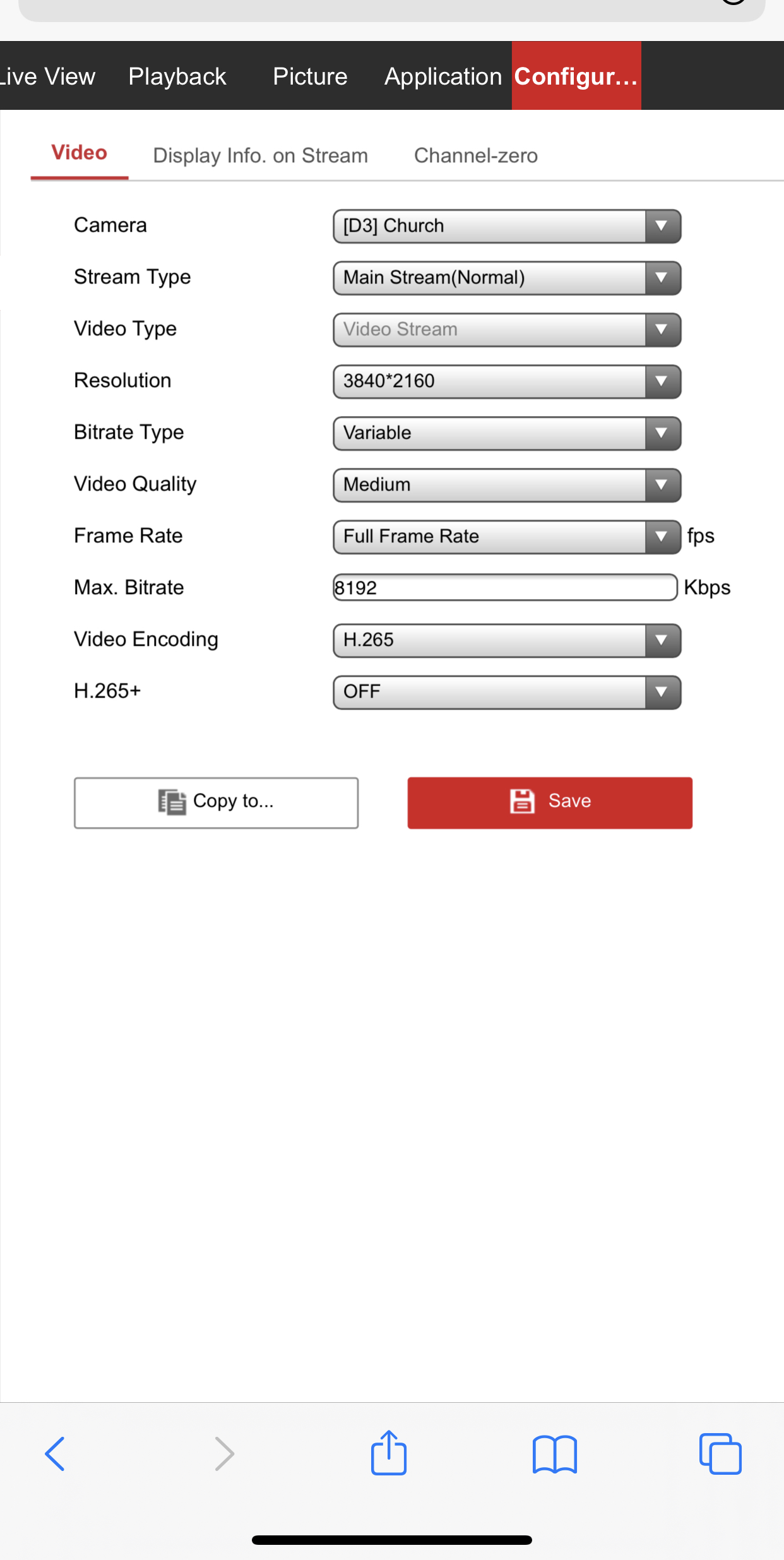

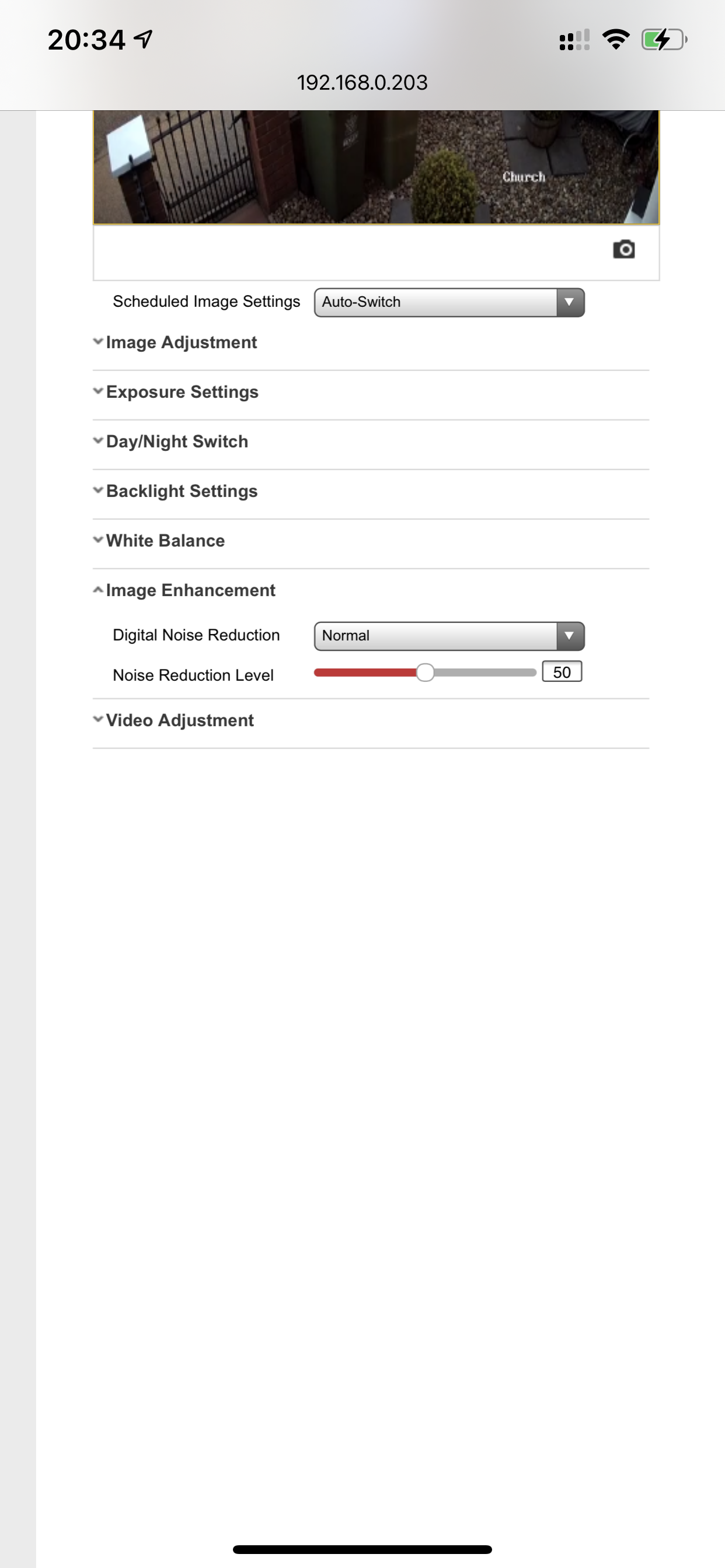

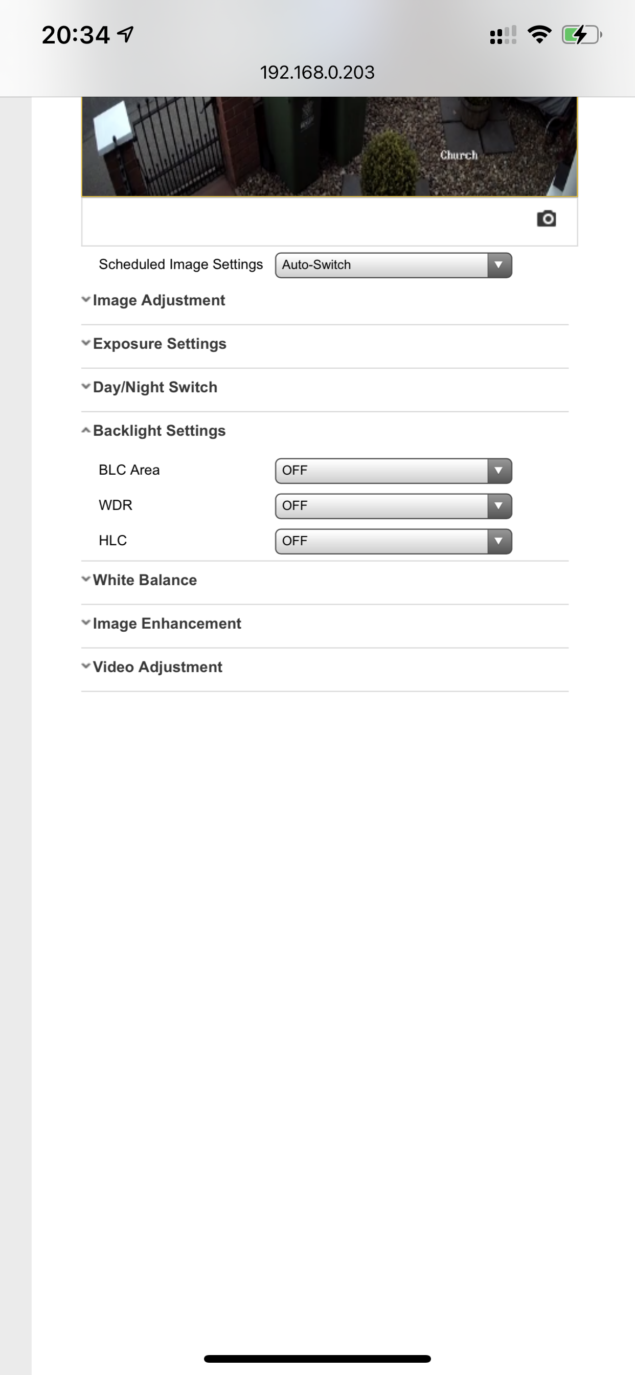

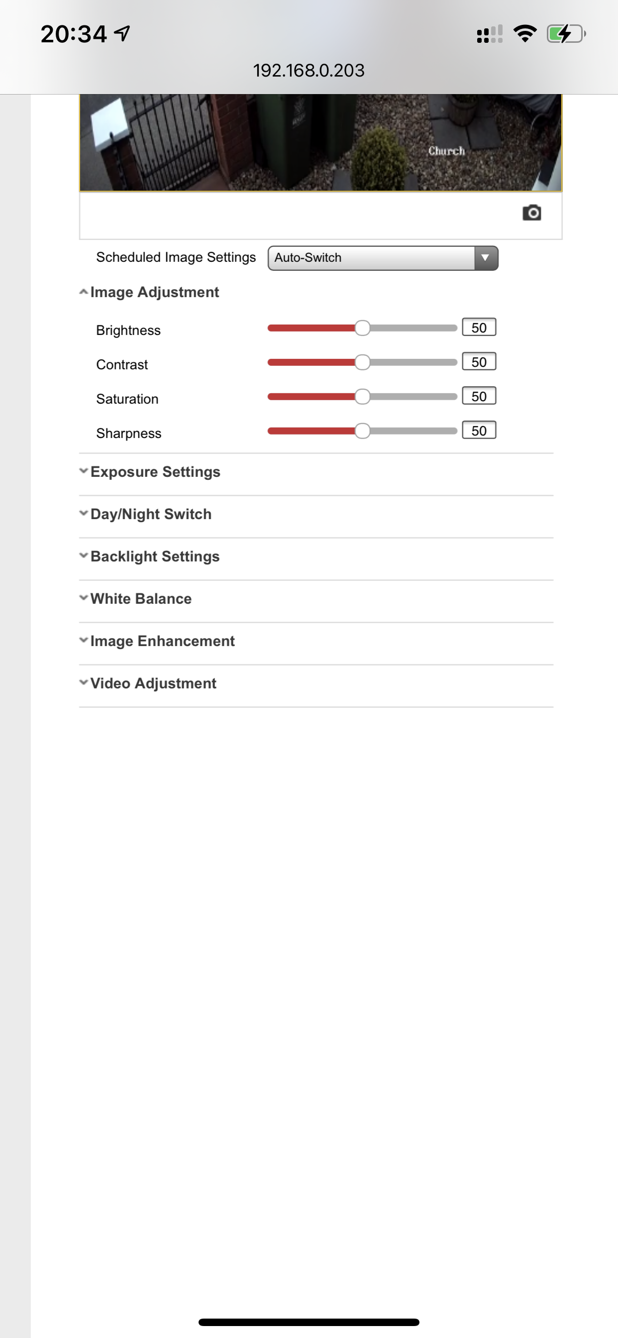

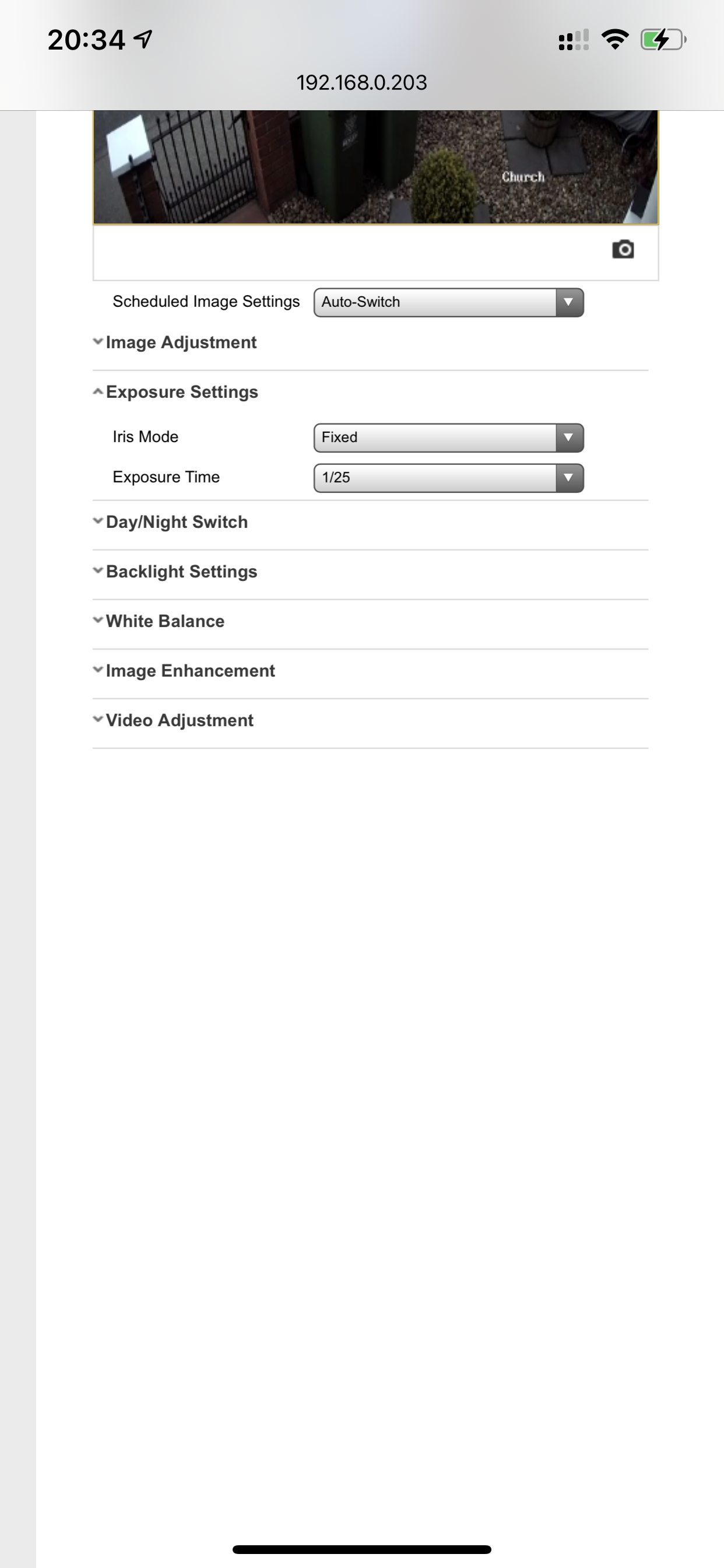

No issue with ANPR they are crystal clear day and night. These are also the settings in my NVR (all settings for one of my 2385 cameras) I turned 265+ off to save the whole picture rather then the bits that change, I’m now debating if that is correct.
I never use H265+ either. H265 does still update only the changes in between I frames though as does H264. I did a bit of a test once to see if I could tell the difference in recorded images with H264 and H265 and I didn't see any discernible difference (could be my 50 year old eyes mind!) I usually keep the I frame interval equivalent to 2 secs. Out of the box Hik cams are set to 25 FPS and I frame of 50 so if I set a camera up at 12FPS I'll set the I frame to 24.
I'd never keep the shutter speed at its default of 1/25s - it's just to slow to prevent motion blur of targets at walking speed even. I use 1/50s minimum but prefer 1/100s. At 1/100s only 1/4 of the light is reaching the sensor as was at 1/25s so it's always going to be a trade off. I'll lower the contrast a bit to brighten the image rather than use the WDR when possible. The noise reduction will always affect the image quality to some extent as it's looking at either adjacent pixels (space) or previous pixels (time) to determine what is visible noise and mask the pixels. Not sure why you would be getting motion blur during the day mind.
I used to use the 2385s but didn't rate them (the old 2385FWD-I not the G1) - the minimum illumination is given as 0.01 lux but that's at an aperture of F1.2 and that model has a smaller aperture of F2, the G1 version was marginally better. The 2386s on the other hand have a minimal illumination of 0.003 lux measured at F1.4 and they do have an F1.4 aperture.
I've not used that particular NVR so I'm not familiar with it and the people search on it but if your looking at the target cropped image from within the frame it's digitally zoomed so it depends on the distance to the target as to how many pixels are covering it.

I missed your reply earlier. It's not so much as thinking outside of the box, it's just that with regard to capturing motion in moving images and exposure in general there are well defined principals that will never change. I do agree with you that there's a lot of hype regarding the 8MP cameras. What I was trying to get at was that light is extremely important - whether it be natural or artificial and that the shutter speed is far more important than the frame rate when it comes to identifying a moving target.
Hikvision cameras usually ship with a shutter speed of 1/25 sec and sensor gain (AGC) set to 100 per cent. 1/25 sec is way too slow to freeze motion of even someone at walking pace. The 100 gain will introduce noise. But with each doubling of the shutter speed 1/25 sec to 1/50 sec, 1/50 sec to 1/100 sec etc you lose half of the light to the image sensor on the camera so the image becomes under exposed and visible noise increases in the image. Likewise reducing the gain will darken the image. The noise reduction smooths the image by identifying and masking the pixels which are sensor noise but this in itself removes detail in the image. With enough light the gain can be reduced which lowers the sensor noise and the shutter speed increased which reduces blur.
No issues with the camera mentioned at all. I have a few 140db WDR cameras that are 4MP ( the Hikvision Ultra series 5) and compared to what I usually use they were a small fortune. They're an improvement but even if I had deep pockets I wouldn't buy more of them.
