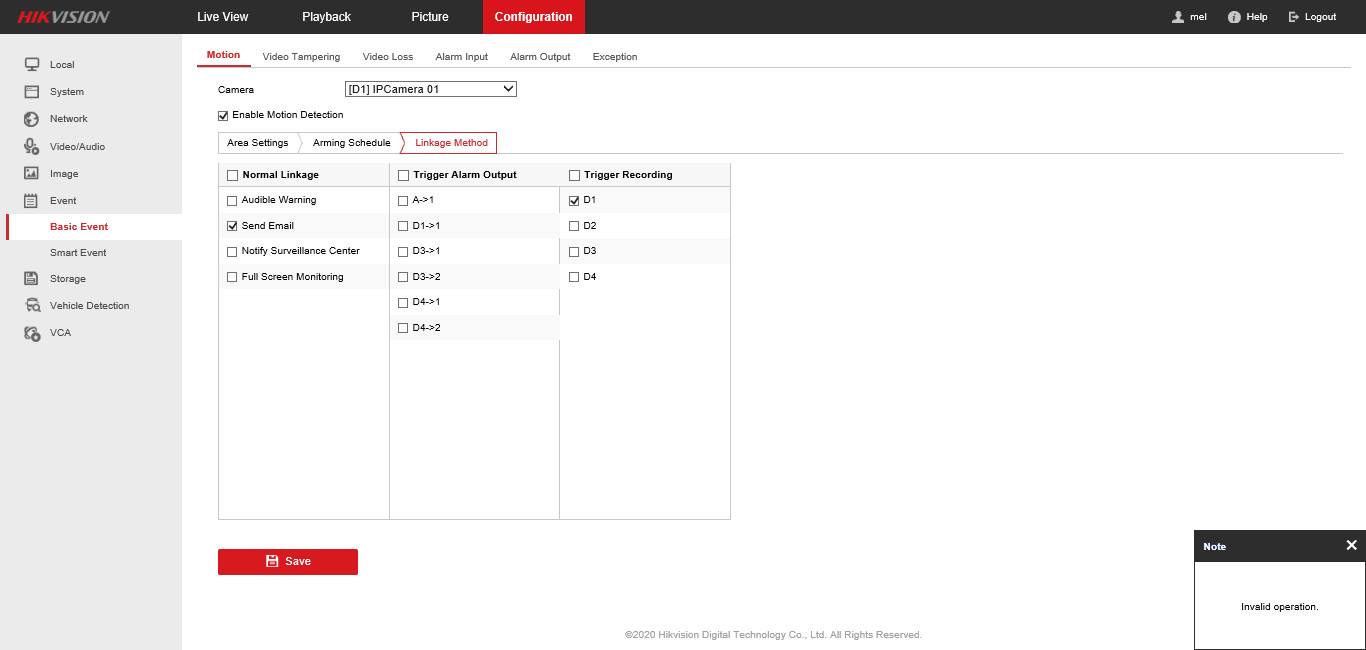

Hi I have a milesight mini bullet PTZ and a hikvision DS-7608NI-K2 / 8P NVR
i tried to follow this:
on selecting motion detection on the milesight camera I don't get the red spot on live view to indicate motion selected
when trying to set to send an email on motion (on the NVR) or any other any settings i get invalid operation on save
is it possible to set up to send email on motion with this camera

managed to get motion working by turning off VCA and PTZ functions but still get invalid on NVR

finally managed to get it going seemed I had added camera to NVR using a created user setup as operator with all actions ticked
re added camera as Admin with admin password and it now saves but doesn't send emails

seems to be NVR (firmware V4.30.005 build 200628) will send test emails but will not send emails on motion events
events are triggering but no emails are sent by gmail
has anyone else had this issue ?
