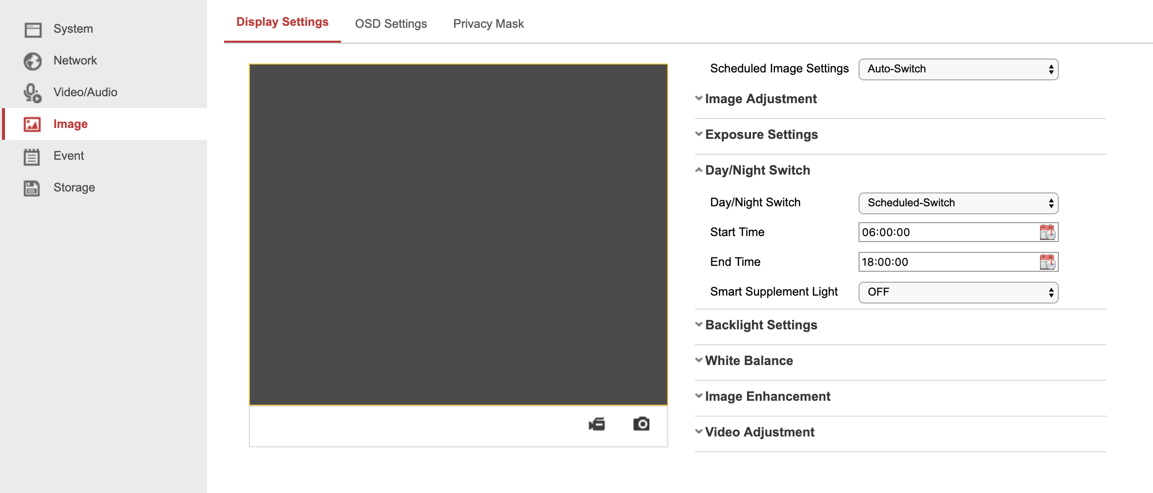

The IR switch settings should be under the image settings (see screenshot below) all you have to do is change Auto to Scheduled-Switch and then set the timers for when you want the camera to switch in and out of IR night mode.
