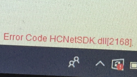

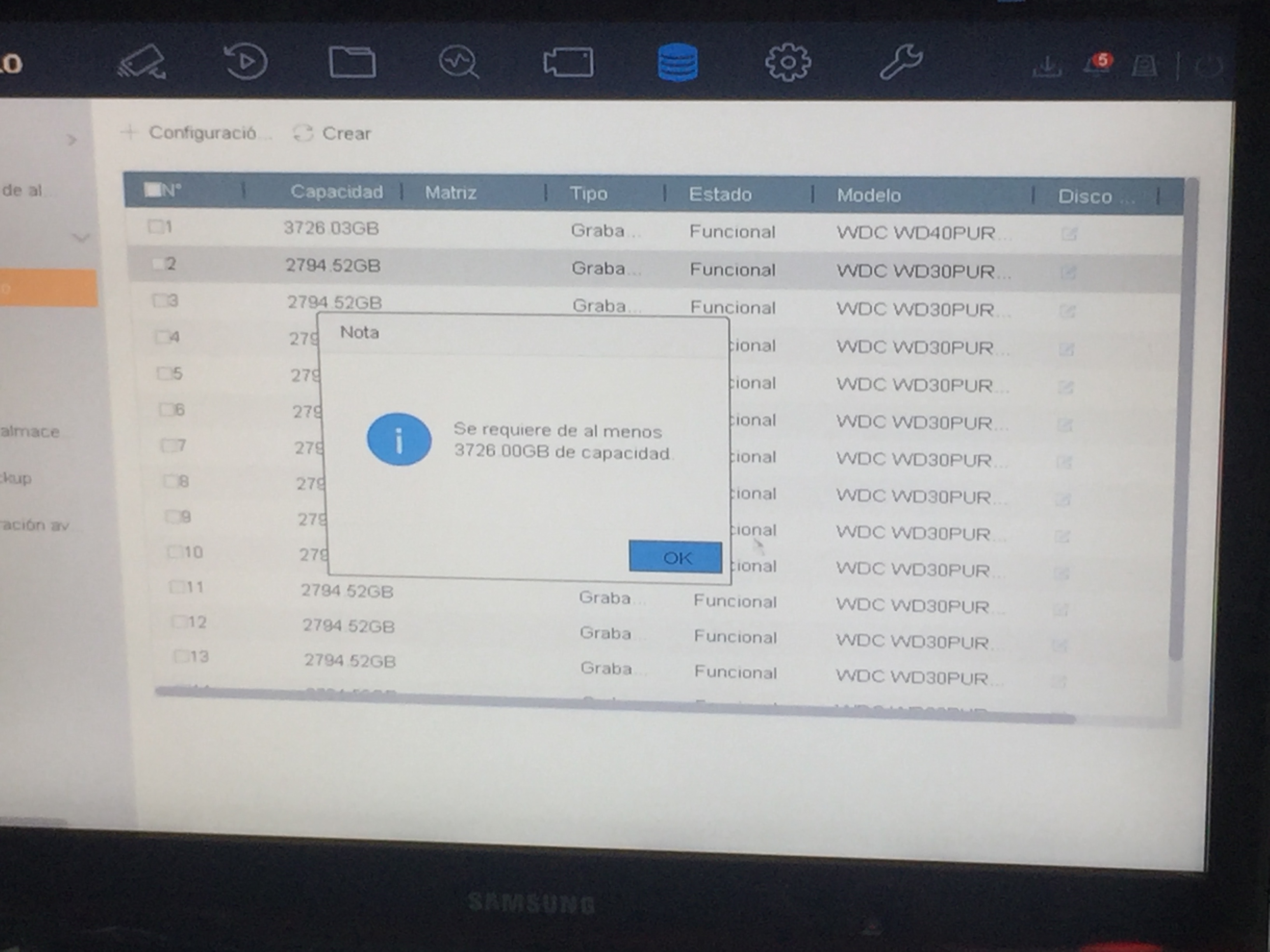

An update to the 9600 series has just been brought to our attention. If you are setting up any level of RAID above RAID 0 on a 9600 Series NVR that is running firmware v4.1.6xxx or newer then all your HDDs must be at least 4TB, if any of the drives used in your RAID array are less than 4TB you will get the error message in the title of this post - “Capacity requires at least 3728.00 GB”
