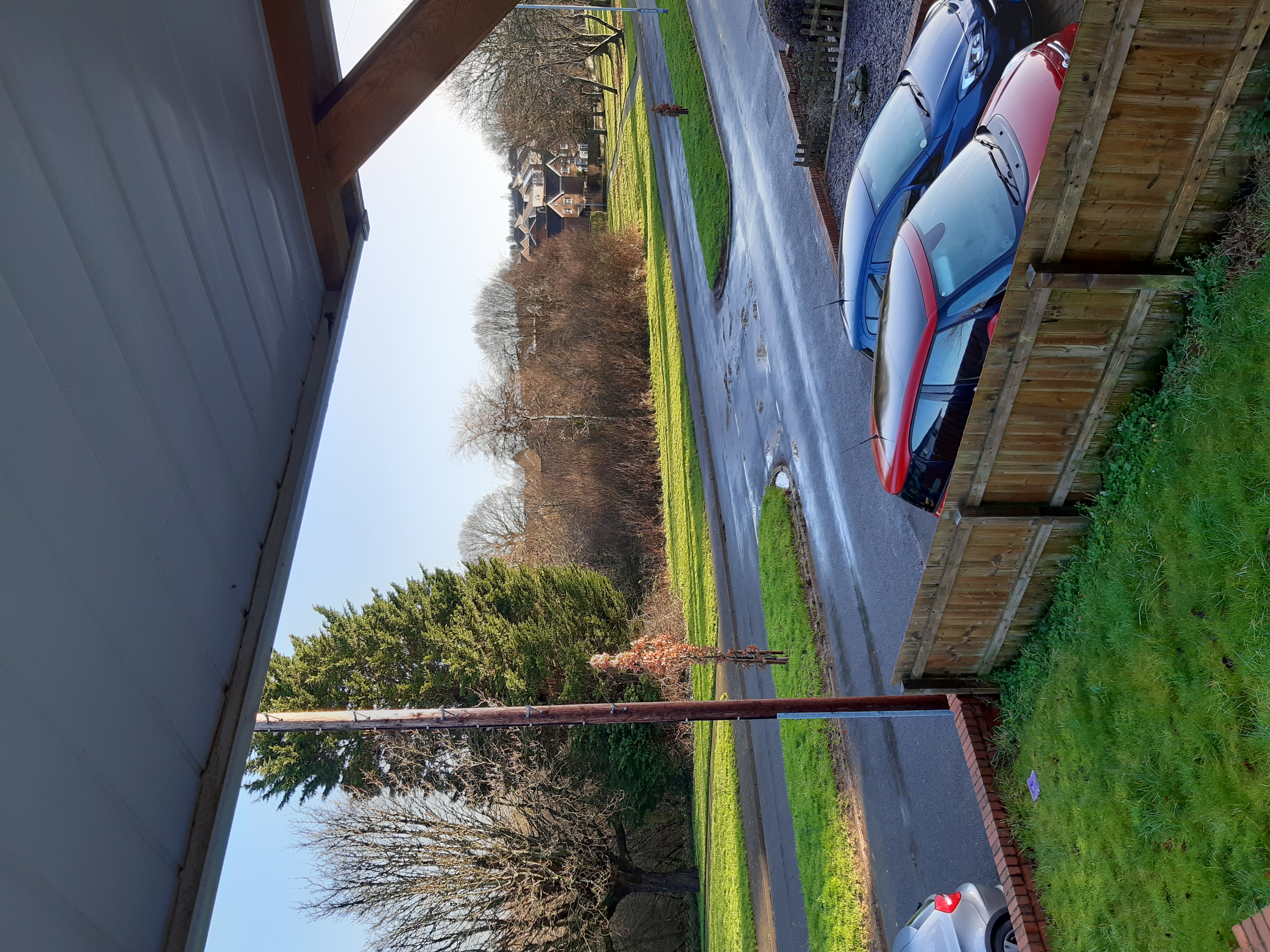

Hello All,
I hope you're all keeping safe and having a good holiday. This is my first post so I'm very sorry if I'm breaking any rules - I've found vaguely similar posts across the web but nothing for my exact situation. I'd be hugely grateful for any advice.
We have no off street parking; we park part on the pavement part on the road. People keep crashing into our cars (and our neighbours) and leaving the scene. 5 cars have been written off between two houses in a few months. (The police actually told us to park on the kerb but this hasnt helped.)
Most recently, in the middle of the night, a brand new electric vehicle was crashed into my car at speed, airbags deployed and windscreen smashed, and so much damage was caused that they couldn't drive away, but since we were confused having just been woken up they were gone in another vehicle before we could get its details, and they abandoned the first vehicle and reported it stolen.
I'm hoping to be able to set up a NVR type cctv system with a couple of cameras, one looking up the road to capture licence plates at night (roughly as per attached image) and one pointed directly at our cars (gray car left of screen).
I have installed a blackvue dr590w 2ch dashcam pair with parking mode and battery pack in the car, but the headlights seem to drown out all the number plates making it not useful.
I would be hugely grateful for advice on this setup. I get the impression I might need a special camera for night time registration plate capture and another to get general impact footage. Whilst I am no camera expert at all, I am a software engineer so should be ok setting things up if needed.
I understand the data protection implications and would take necessary precautions to that effect, so am just looking for technical advice, and am very grateful for your time.
Thanks very much!

Sorry to hear about the problems you've had with car accidents, numberplate reading can be a tricky and specialist thing. If you want the camera/NVR to keep a record of the plate reads you will need to look at a specialist ANPR camera like the Hikvision DS-2CD7A26G0/P-IZS but ANPR models are more expensive than standard CCTV cameras and solely designed for plate reading. (e.g. the camera's sensor adjusts to read the plates at night by reducing its light sensitivity which makes the rest of the scene very dark)
You could also look at just a standard IP camera like the Hikvision 2385G1 8MP/4K Darkfighter Turret which can't record plate data but if you enable image settings like HLC (High Light Compensation) and WDR (Wide Dynamic Range) you can counteract the light reflection off the number plates, but just like with the ANPR model these image adjustments will affect the whole image making the whole scene look a lot darker and the clarity of plates can be affected if the position/angle of the plates changes too much.
If you search for 'ANPR' on the forum you will see many different posts discussing different ANPR setups along with our old guide to setting up ANPR cameras which includes some screenshots giving you an idea of the images you will get at night. I would also recommend watching some guides and tutorials on YouTube like this one
In regards to recording, we would recommend the DS-7608NI-I2/8P 8-channel NVR as the I-series NVRs are the most up to date Hikvision NVRs and support ANPR cameras.

I forgot about using technology :). Here's a couple of google map drawings. The house is at the bottom left point. The middle of the road is 14m away, and the point at which I'd like to capture traffic is 40m away. This makes the angle (if my maths is still in my head from my youth) around 20 degrees, and maybe up to 30 if I shorten that hypotenuse, say if there is a parked car in the way regularly or something.
(When I say 'the house', I mean the mount location, which is the awning above the front door, which is maybe 5m above the height of the road).
Would that camera you suggested be any good, or should I be looked at 12mm ? Sorry for all the dumb questions, I hope this at least makes some sense.
