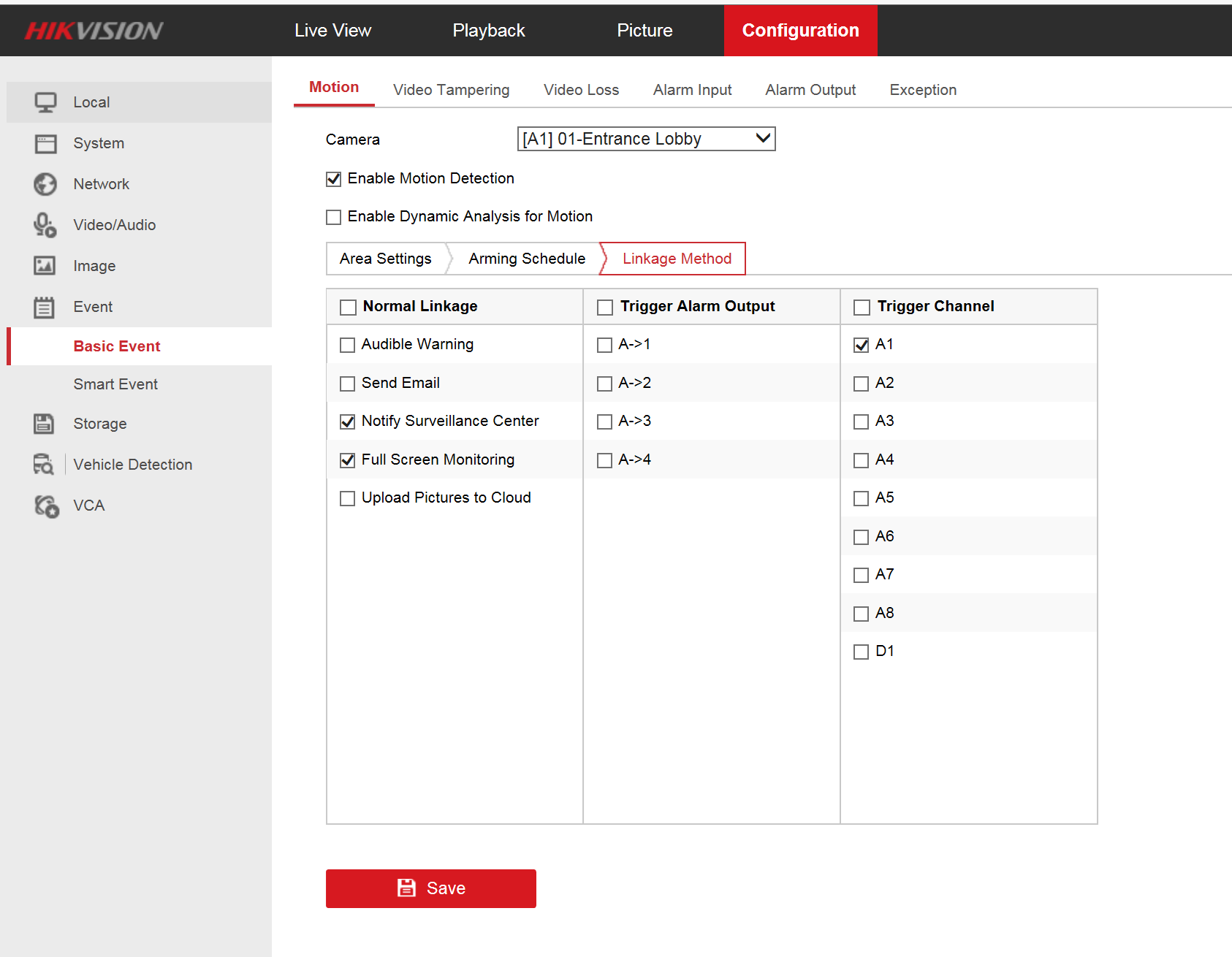

OK it was worth a try. One thing you can check either with the local menu on your DVR, or using a web browser to login.
In the events section check the settings are the same for all three cameras. The picture attached shows what you should have checked for all three cameras if it's motion detection that you have set. I have an inkling that the camera that is missing markers will have will have its "Trigger Channel" box unchecked (Cam 1 should have Trigger Channel A1 checked by default, Cam 2 Channel A2 etc) - if so check it and click save. The image I've attached shows the setting using a web browser but you'll find it also using the monitor/TV and mouse.

Thanks for this. I've checked and it was ticked, so just to see if it hadn't saved correctly originally I unticked it and saved it then came off that page, went back on re ticked it and saved it but it still doesn't work. Bugger

I'm clutching at straws a bit now, but I'm assuming that it's motion detection that your using on all 3 cameras for the alerts? If so, uncheck the "Enable Motion Detection" box and save, then recheck the box and save.
