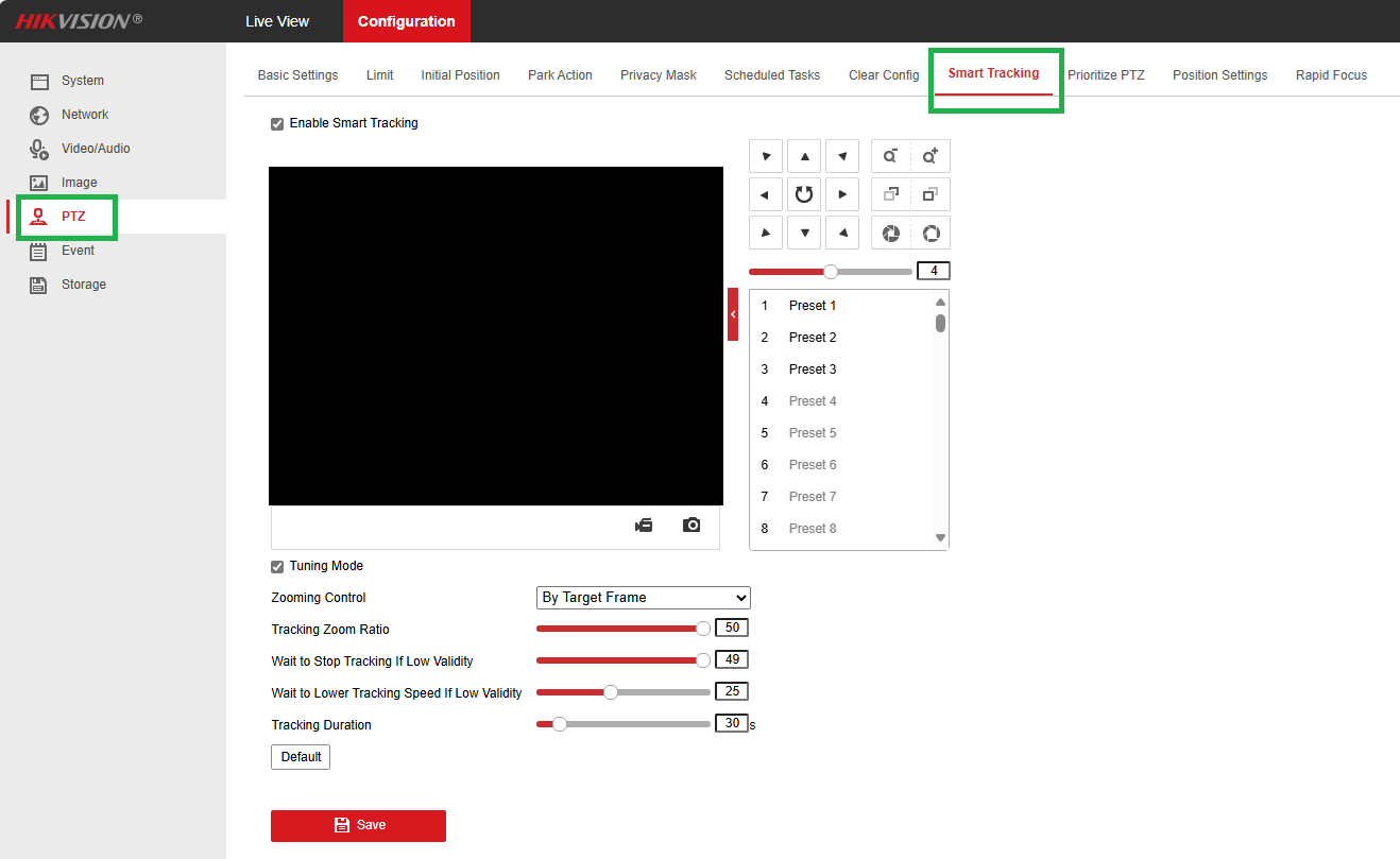

UPDATE: Hikvision Support has responded this morning saying they have tested smart tracking triggered by event and cannot see any issue with the recording:
I just tested DS-2DE4A425IW-DE V5.6.15 build 191211 with DS-9664NI-I16 V4.40.016 build 200803, set the recording schedule to Event, and only enable intrusion detection for the camera. Smart tracking is enabled on the PTZ settings and set as a linkage action for the event. I can successfully find the event recording in playback. Please check customer’s PTZ version and suggest them to upgrade to the latest version for a test
They have shared a link for the latest 4A425/4A225 PTZ firmware - v5.6.15 - can you update the firmware if you haven't already and try the above setup that Hik support have described, if you still have the issue let us know. (maybe share screenshots of what you see in playback as that may help understand the issue better)

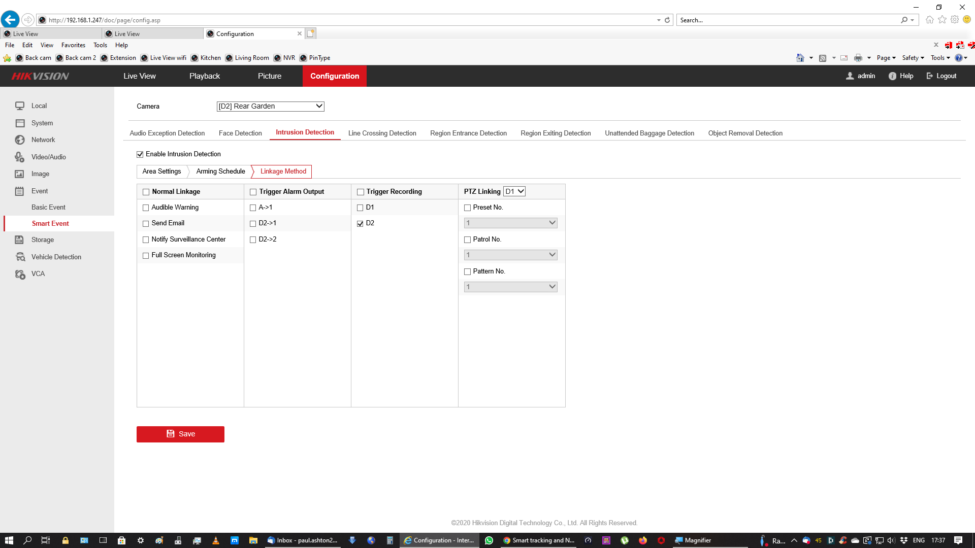

The only way to set a trigger for Smart Event (Intrusion Detection) to trigger Smart Tracking is direct in the web config of the camera.
From within the camera Enabled, Intrusion Detection, Drawn the box, Threshold =1, Sensitivity = 65, Arming Schedule all is purple, Linkage Method (ticked Notify Surfellance Center & Smart Tracking), *Didn't tick Trigger Recording as there is only the option for A1?
From the NVR there is no option for Smart Tracking when setting up the Intrusion Detection Smart Event for the camera.
