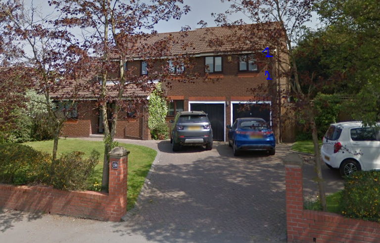

Hi,
I am installing a new home system and my installer (electrician) is adament that I should install my front of house turret camera in the soffit for neatness (normal 2 storey house height). However, many online suggest to install at a lower height of approx 3m to capture more face detail etc instead of tops of heads. Do people agree? And if I mount on the wall instead of soffit, can there be issues with rain obscuring the lens in wet weather as it is not as sheltered? Please see my picture with the 2 options highlighted: Location 1 under the soffit and Location 2 lower down to better cover the drive area and approach to house. There will be an additional camera near the front door also.
Thanks in advance for any opinions
