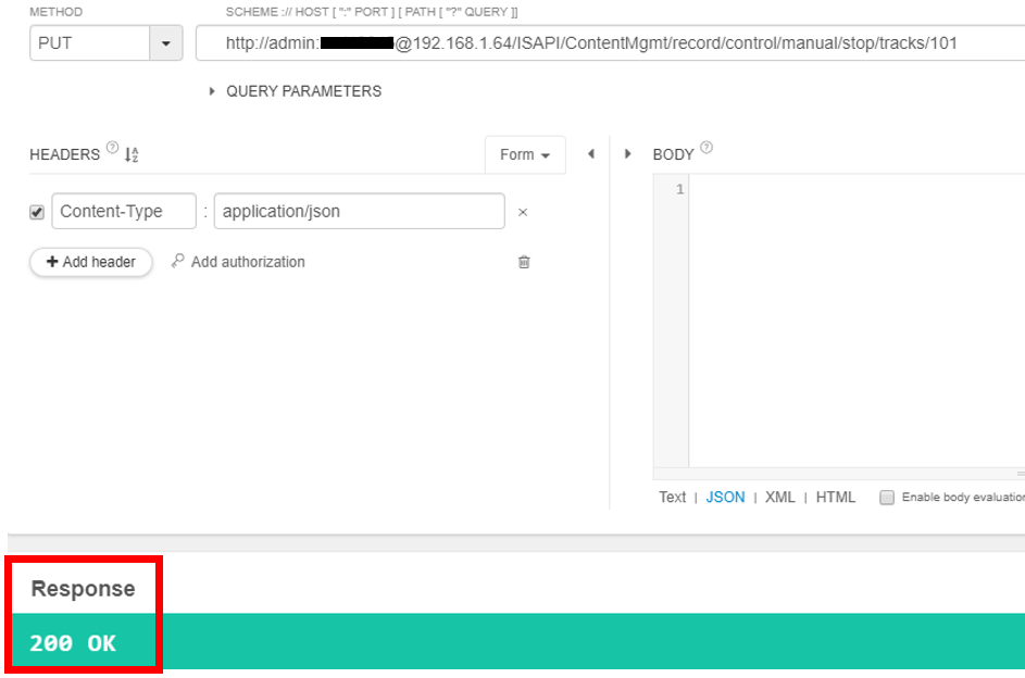

To stop a manual recording:
PUT http://admin:yourPassword@192.168.1.64/ISAPI/ContentMgmt/record/control/manual/stop/tracks/101

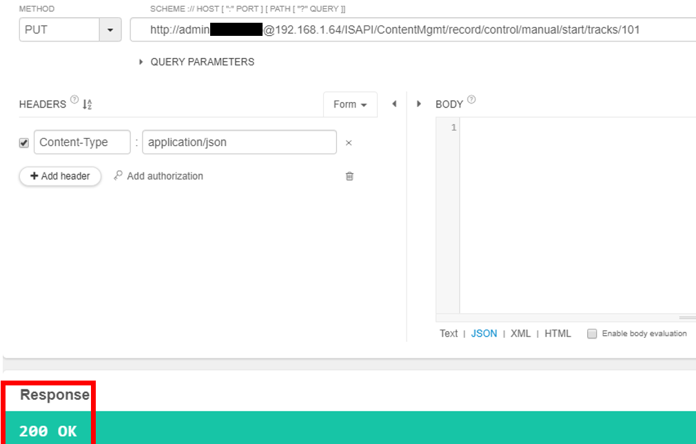

To start a manual recording:
PUT http://admin:yourPassword@192.168.1.64/ISAPI/ContentMgmt/record/control/manual/start/tracks/101

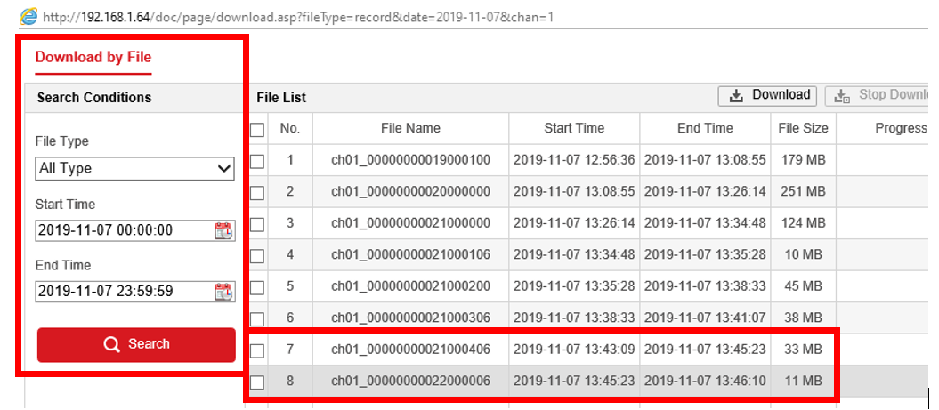

You can see in the playback timeline the effect:
The files are also available to download:
