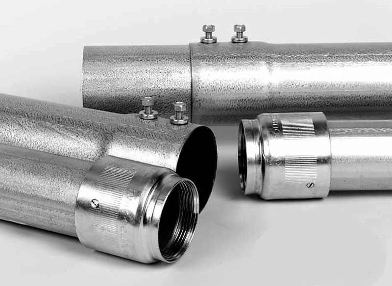

The obvious answer to your question would be steel conduit. The conduit used in plastered walls is generally plastic although you can get steel u section but it would need to be screwed to the wall in several places.

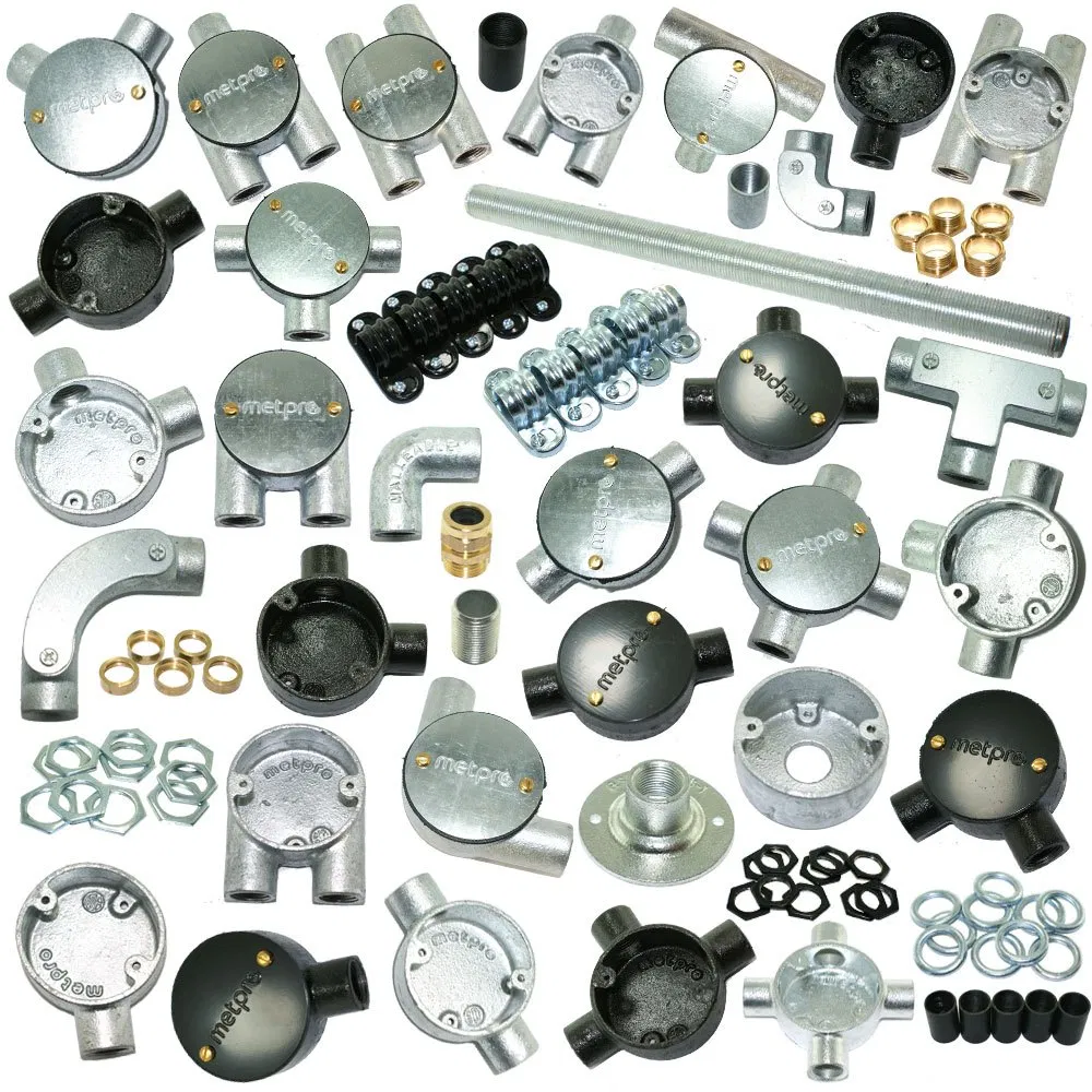

Where are you from? If the UK we use 20mm 25mm 32mm etc screwed conduit and various bends and round boxes to terminate or mount objects see below.
In the US I believe they use lighter gauge slip conduit that joins with special connectors with set screws which grip the tube.
The size you use would be determined by the number of cables/coax you need to get down the conduit. Steel conduit is pre-threaded each end but if you cut it to length then you will need to rethread the cut end to allow bends and boxes to be attached.
the other alternative is armoured flexible conduit but thats rather expensive and needs a lot more fixings for a straight run.
